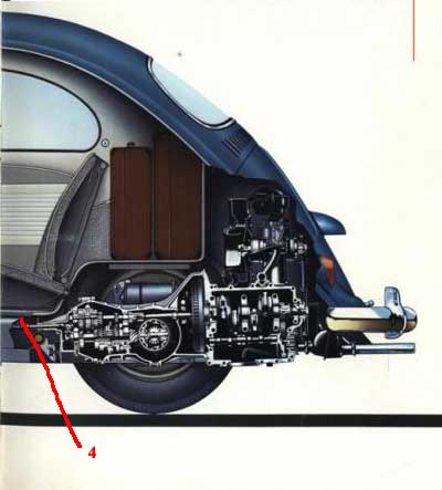

I did not have as good luck as Bill. Perhaps he has small hands and he obviously is a better mechanic than me. Here is what I did to replace the fuel line. Do not use copper. Used standard 1/4 diameter fuel line if nothing else can be found.
Point 1, 2, 3 are where the line enter the front of the bug and nothing hold it in place there except the rubber grommet and the front of the tunnel. In the tunnel there are only tabs that are bent over the line and gblakeney has confirmed this. Once inside the tunnel tie wrps can hold the line to the existing metal tubes for the cluth and throttle calbe.
Point 4 is difficult to manuver if you insert the line from the front. I would go from the ass forward as its easier.
to be honest I was never able to enter one solid piece of line. I could only make it from the rear to the mid point and from the front to mid point. I kept the threaded ends of the lines and joined them with a brassed cupler. No leaks works fine.
