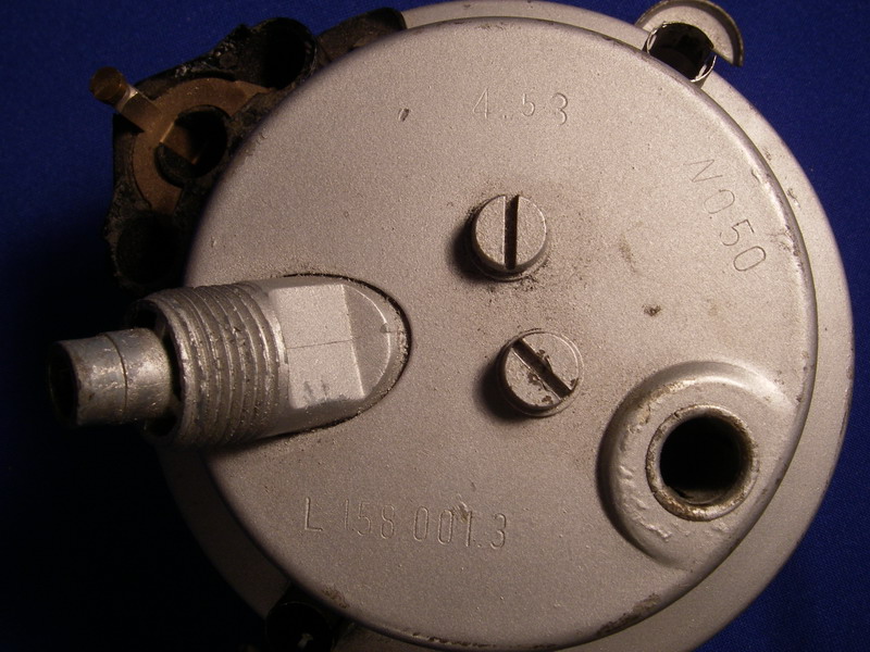

PostPosted: Thu Jul 26, 2007 7:15 am    Post subject: Reply with quote
RareAir wrote:
while searching for zwitter speedo I found this old post,
how about this oval speedo dated 4.53 .the arrow look diferent but the shift point exacltly the same w the pic above, my 55 speedo has taller/higher shift point, maybe sombody change the internal parts and just used the housing??
Thanks

Hi Bob thanks!! i've seen that add yesterday, my question was the oval speedo pic I post and the one above, they both come from 53 (one 5-53 the one I post 4-53)but the arrows look diferent?? if the theory there are 2 types of 53 speedo,
1. zwitter speedo with separated arrows
2.speedo with joined arrow that is smaller than the 54
my question why this one dated 4-53 but has fat arrow??

PostPosted: Thu Jul 26, 2007 10:07 am    Post subject: Reply with quote
surfindo wrote:
53 0val wrote:
Here is what a true '53 Zwitter speedo looks like:
http://www.thesamba.com/vw/classifieds/detail.php?id=483298
Hi Bob thanks!! i've seen that add yesterday, my question was the oval speedo pic I post and the one above, they both come from 53 (one 5-53 the one I post 4-53)but the arrows look diferent?? if the theory there 2 types 53 speedo,
Arrows look the same to me, between those two. Look at how many lnes it crosses top to bottom, and how much space between it and the warning lights on either side.... Looks to same to me...

PostPosted: Thu Jul 26, 2007 10:29 am    Post subject: Reply with quote
johnshenry wrote:
surfindo wrote:
is it ?? hmmm i need to check my Shocked eyes!!!
