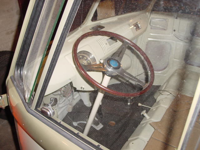

PostPosted: Wed Nov 09, 2005 6:11 pm    Post subject: Reply with quote
Here's a pic of one that Coolrydes posted in the gallery. It is a Datsun empi machined to fit
I knew I had seen a pic of a GT wheel on a bus, thanks for the info and the pic EmpiGT

PostPosted: Thu Nov 10, 2005 12:15 am    Post subject: Reply with quote
dubluv
You can find thease wheels but it takes a bit of looking.... I will tell you this the machining is easy though.... Let me know if you find one and I'll do up the hub for you......

PostPosted: Thu Nov 10, 2005 7:06 am    Post subject: Reply with quote
I just recently started looking into one of these wheels and your bus is the reason why. I think it compliments the style of the bus. I soon as get a hold of one I will definitely get a hold of you coolrydes and get it installed. Just to make sure, Im looking for a GTV wheel for a Datsun? What is the diameter of a stock bus steering wheel? Thanks again guys.

PostPosted: Thu Nov 10, 2005 7:59 am    Post subject: Reply with quote
no problem dubluv... thank you for the compliment... It is off a Datsun, I'll check the diameter.... When you get one all I need is the hub and I'll maching it up.....
