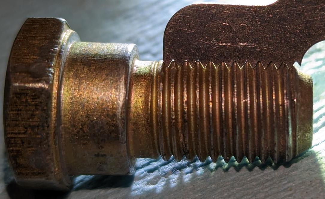

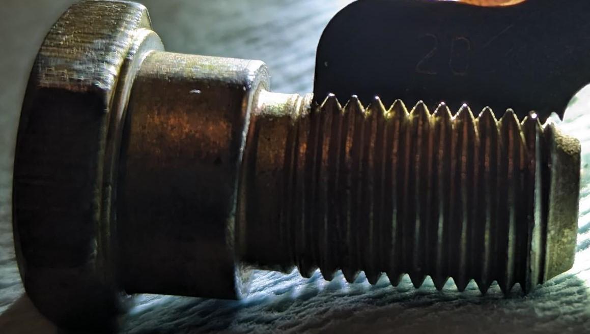

I had to retap the bolt holes in the body and pan of my 72 Ghia so I wanted to use the most accurate tool.
Measuring the original bolts, in my observation they are 7/16-20 from the factory. Additionally, the bolts measured very close to 11mm actual diameter.
A genuine metric bolt will have an actual measurement of .10-.15mm undersize. i.e. an actual 11mm bolt would measure something like 10.85-10.9mm.
First, 20 Threads Per Inch front lit and back lit:
Next, 1.25mm thread pitch front and back lit:
Bolt head:
