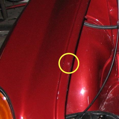

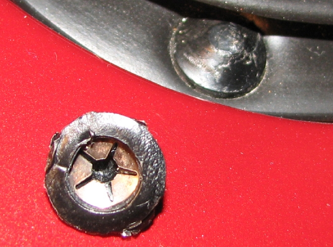

Here's a photo of the anchor caps on my front hood seal.

I like the anchor caps. Are these something you purchased, or reused?
You're entirely welcome; you probably already know about the adhesive solvent/remover that won't damage your paint, just in case Wink The anchor caps came with the car, and like most parts I just cleaned them up and reused them.

First, your Ghia looks AWESOME!!! I don't remember ever seeing any pics of it.
As for the anchor caps, do you know what size those are? I used the 3M adhesive as well and still have those little nubs, and would definitely like to cap them. I'm sure I can find them if I search for Anchor Caps, just wanted to know if there is any way you can confirm their size.
Thanks, Jeff, your Ghia is shaping up to be a winner for sure! I've posted a few pics, but a photographer I'm not Smile
The plastic surround measures about 12 mm OD, while the five-pointed metal retainer is right on 1 cm OD. I'd imagine a place like Grainger might have something close, but I've not looked. HTH
