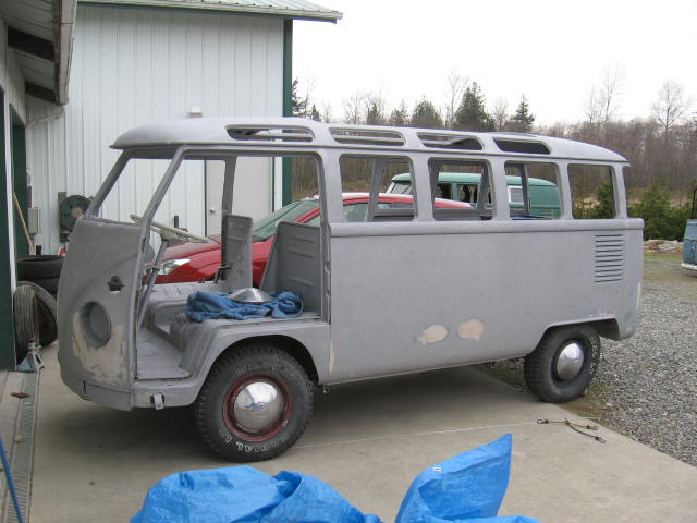

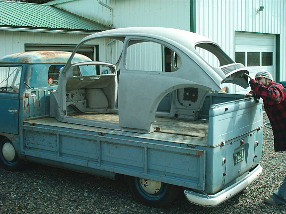

I'm in Bellingham Washington and have been getting Bugs and Buses blasted at Sharpe Auto and Sandblasting. He uses crushed glass media- feels like moondust, or at least what I would think moondust feels like! The surface is ready to prime just by blowing out/off the bare shells... I just had an entire off-the-pan 63 hardtop done for $500... His prices have gone a slight bit cuz he uses diesel to run his power generator/ air compressor.
AMAZING process, very affordable and NO warpage. Here's some pics of the work.
Todd's his name- if you're anywhere near him, DO IT! 360-441-5000
Ryan
before
after
This...
Became a winning drag car!

I had the folks at the marysville shop blast this for me...
http://www.thesamba.com/vw/classifieds/detail.php?id=353180
Lower right pics were taken by me in my garage about three years ago. The work done in Marysville tops them all! It's just that it takes weeks to get it done. Nothing wrong with that if you're a hobbyist! In fact, the surface was left with a lot of the factory primer somewhat intact! It was plastic media blasted, then the few rust spots were hit with sand to eliminate it... My beef is that with plastic it's more necessary to still sand the surface to gain better adhesion- With glass I just blow it off and it's primable. To each his own, Marysville still kicks butt! (at blasting anyway) Wink
