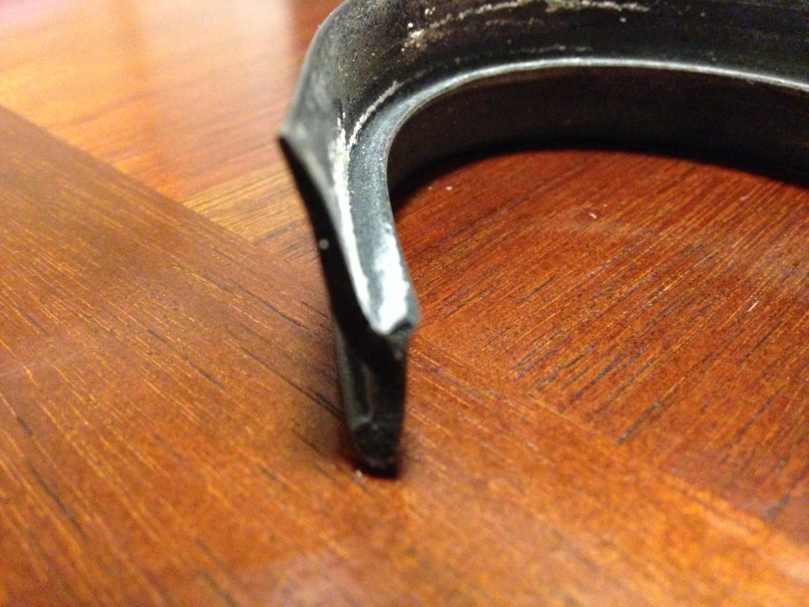

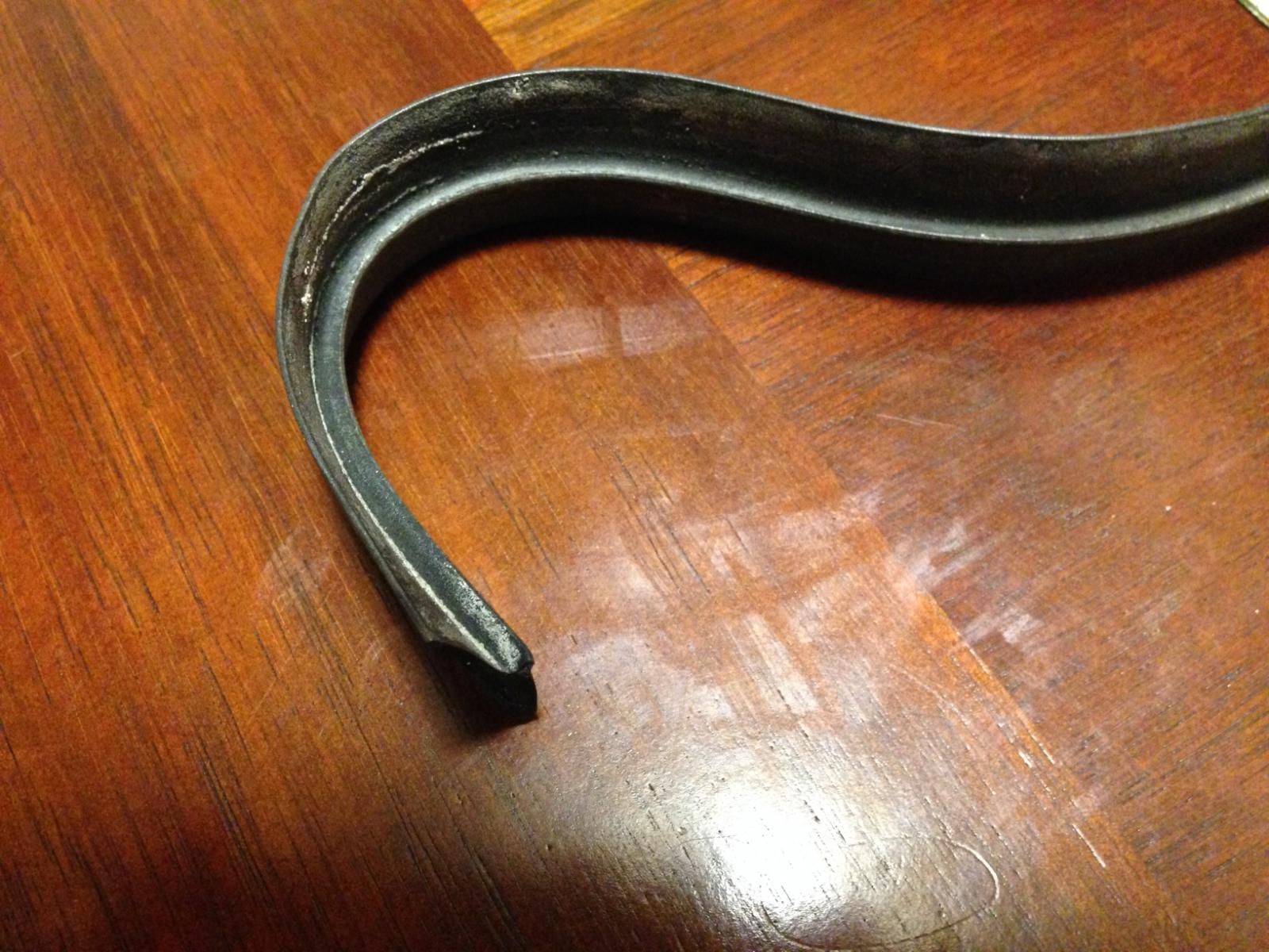

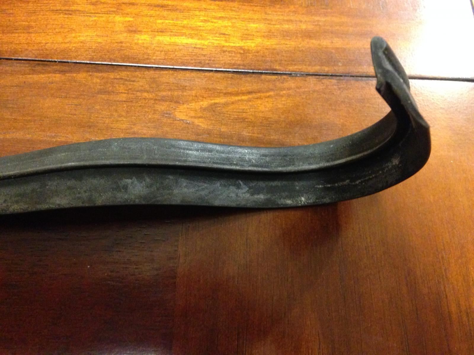

PostPosted: Mon Jan 23, 2017 12:32 pm    Post subject: Re: Piano door top seal Reply with quote
Recently at Classifieds, "NOS Barndoor upper door seal"
http://www.thesamba.com/vw/classifieds/detail.php?id=1982060
The seller kindly shared some additional photos:
