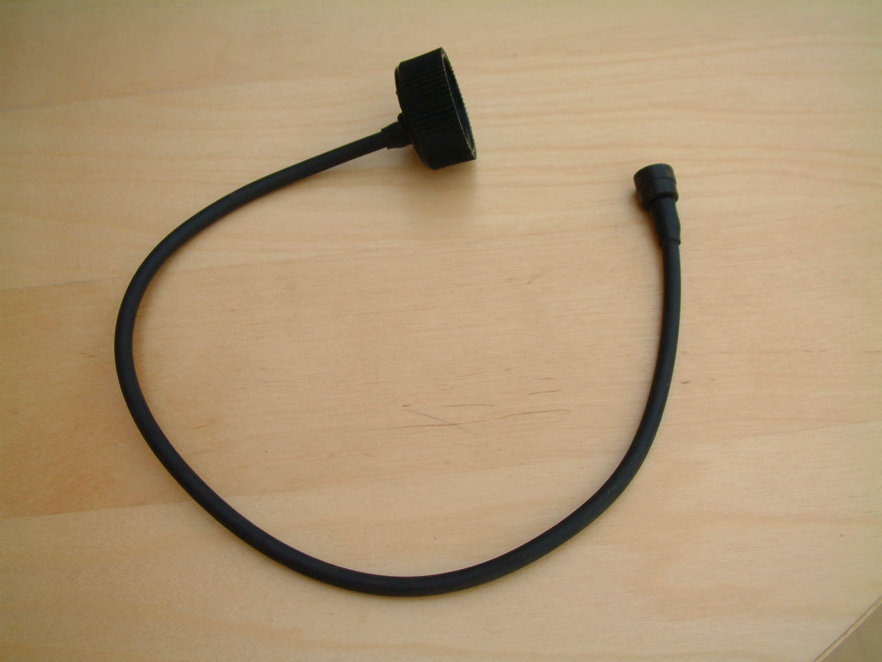

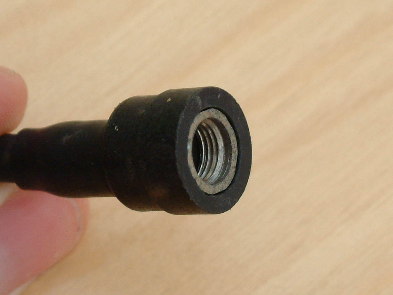

the one I have (had!) is just a plain hose with a tyre valve adaptor on one end of a 15" (approx) black rubber hose, with a threaded black plastic bottle cap on the other.
If I find any more, I'll let you know!

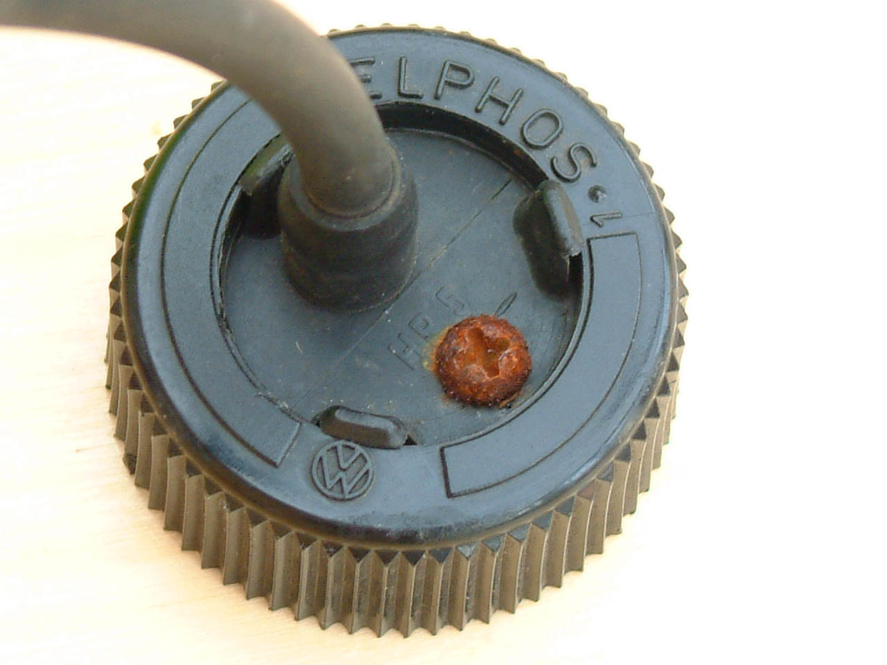

PostPosted: Fri Aug 15, 2003 8:13 am    Post subject: Reply with quote
Ragman, sorry for the delay. He are some pics of the part I've got. If it's any use, let me know & I'll send it on:
https://www.thesamba.com/vw/gallery/pix/104153.jpg
https://www.thesamba.com/vw/gallery/pix/104155.jpg
https://www.thesamba.com/vw/gallery/pix/104157.jpg

I don't think part will work in my 63. I have a shraeder valve on the resevior and only one cap, so I need a hose that has two shraeder valve (shraeder valves are the same valves on the tire stems). I could hook up the hose you pictured, but then I wouldn't have any hoses running to my nozzles.
Oh well, my search continues Smile
