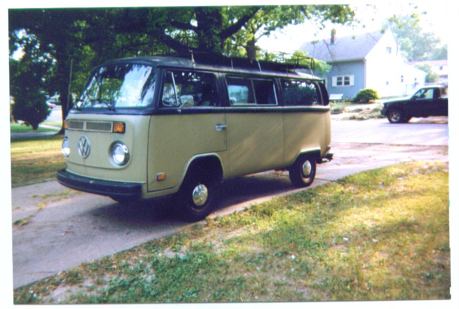

Here's my old 79, I sprayed the top with rattle can paint & the lower is piant I bought to paint my living room with Laughing Laughing it ROLLED on nice, but had no shine Laughing Laughing Laughing Laughing damn semigloss
Hoockd on fonicks werkt for mee?
under the influance "DUH"
