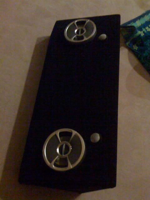

This is an early cardboard template that I started with
You'll notice that I forgot the dimmer switch cut out Embarassed (this is for a 65). I used 1/2" plywood and drywall screwed it to the lower part of the bulkhead. I cut a couple braces for the upper portion that I glued in. Be careful of your speaker selection so that they aren't too deep to where the magnets hit the bulkhead (my 5 1/4" Alpines are VERY close - I put some stick on weatherstrip on the back of the magnet so that they wouldn't rattle against it. The space is pretty small, so your bass response is non existent even with fiberglass batting in the space. But, I get the bottom end from the rear speakers. The nice thing about the Alpines is that you can aim the tweeters, so I have plent of top and mids from these and don't impact leg room at all. [/img]

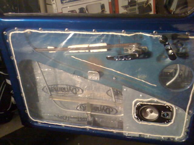

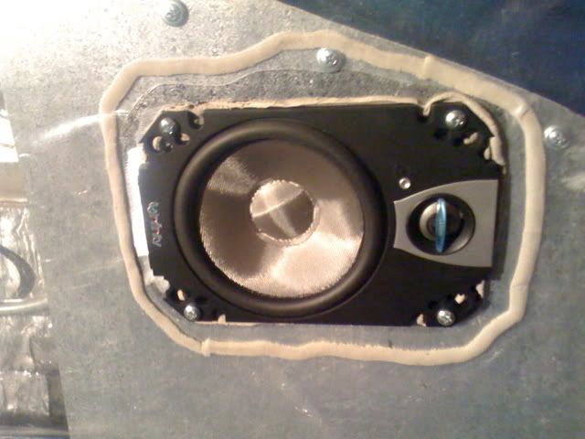

I did not want kick panels either so I made my own that work great....check them out:
Just cut some sheet metal, cut to fit and installed shallow Infinity speakers. They are right behind the Map cutout so sound is unaffected but still covered by light material.
The below handles the mids, the tweets, mid/lows and 10 in sub in custom speaker box in rear. Powered by 700 wats amp.
Perfect for what I was looking for....crystal clear to bumpin hard
