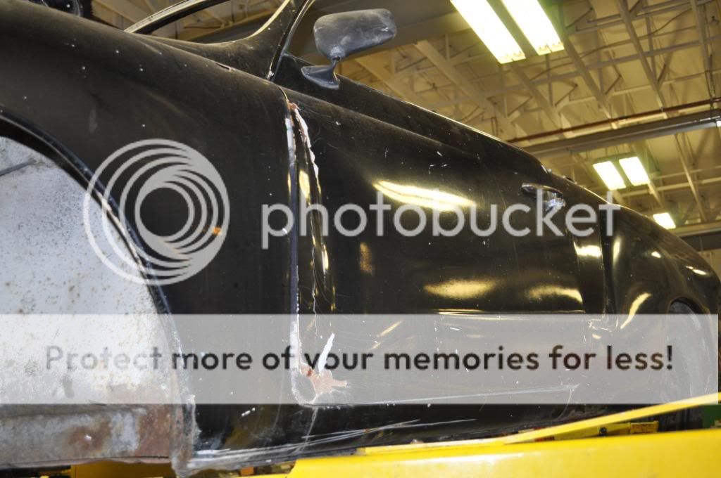

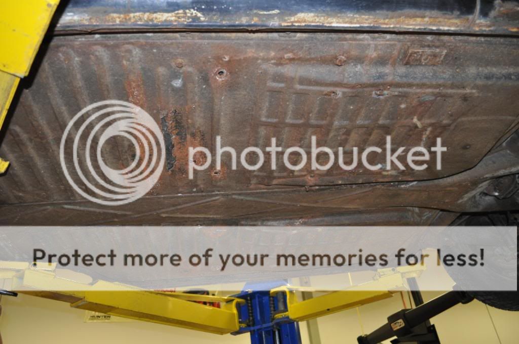

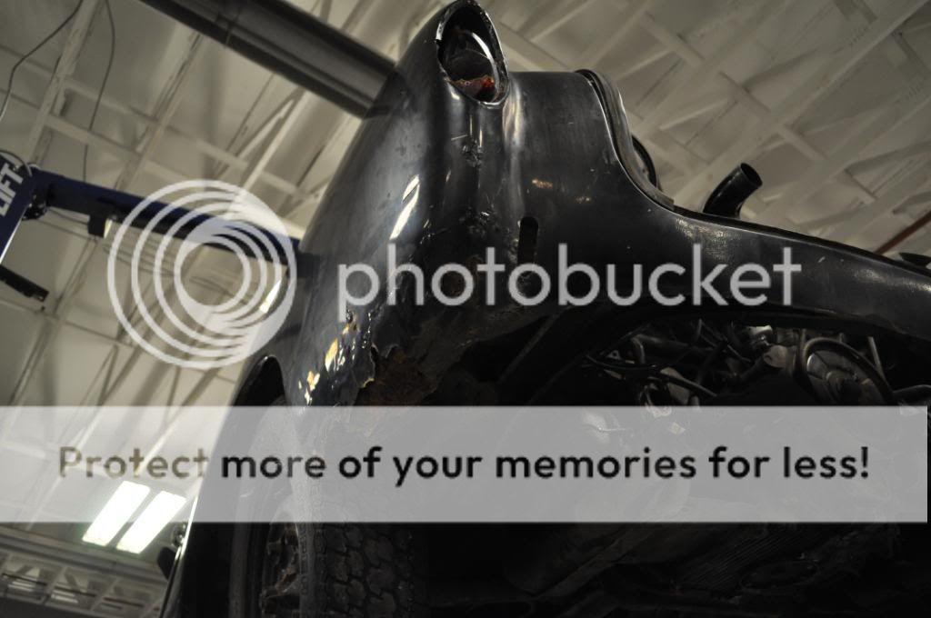

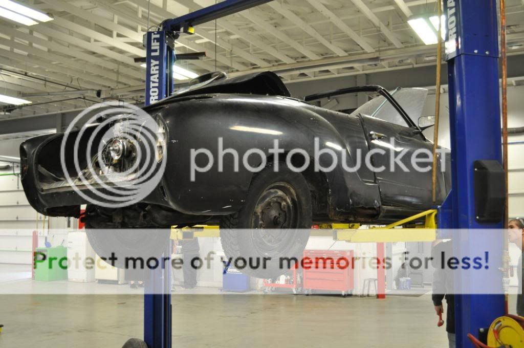

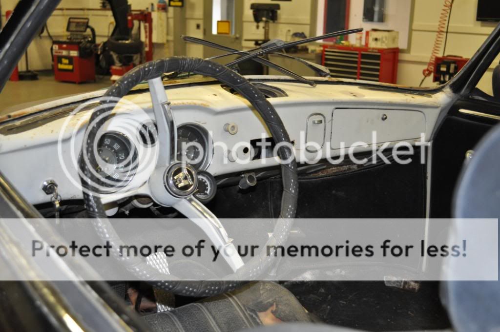

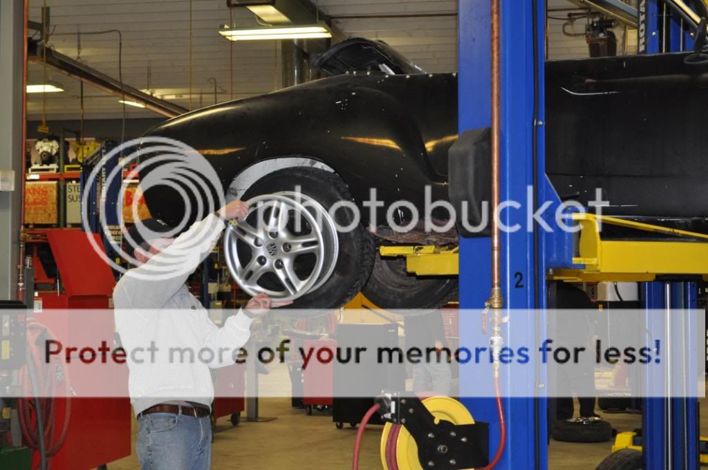

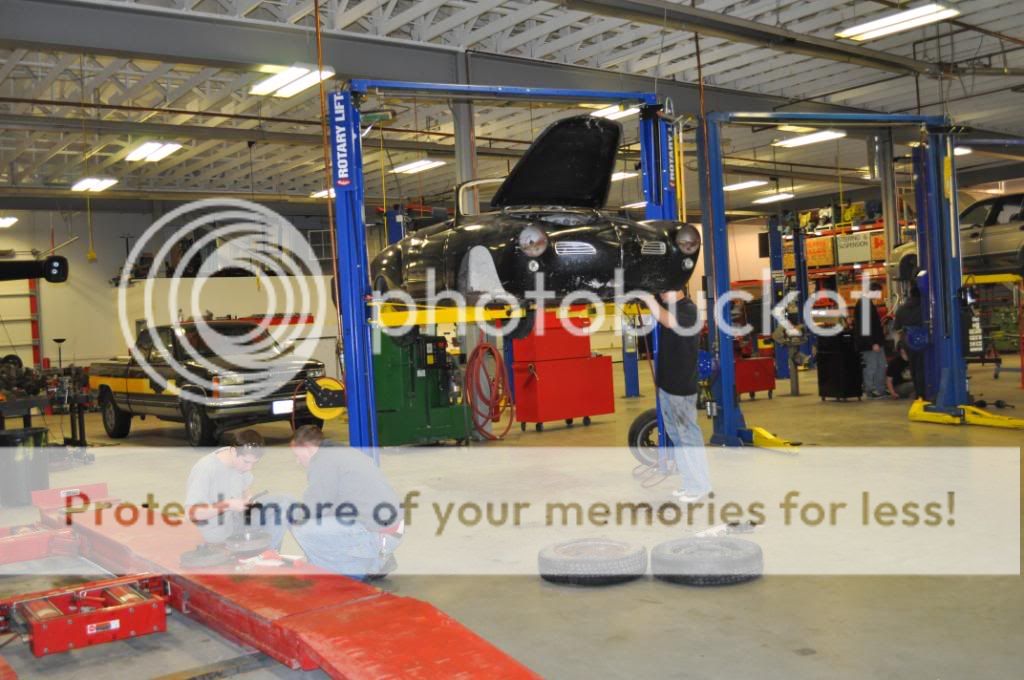

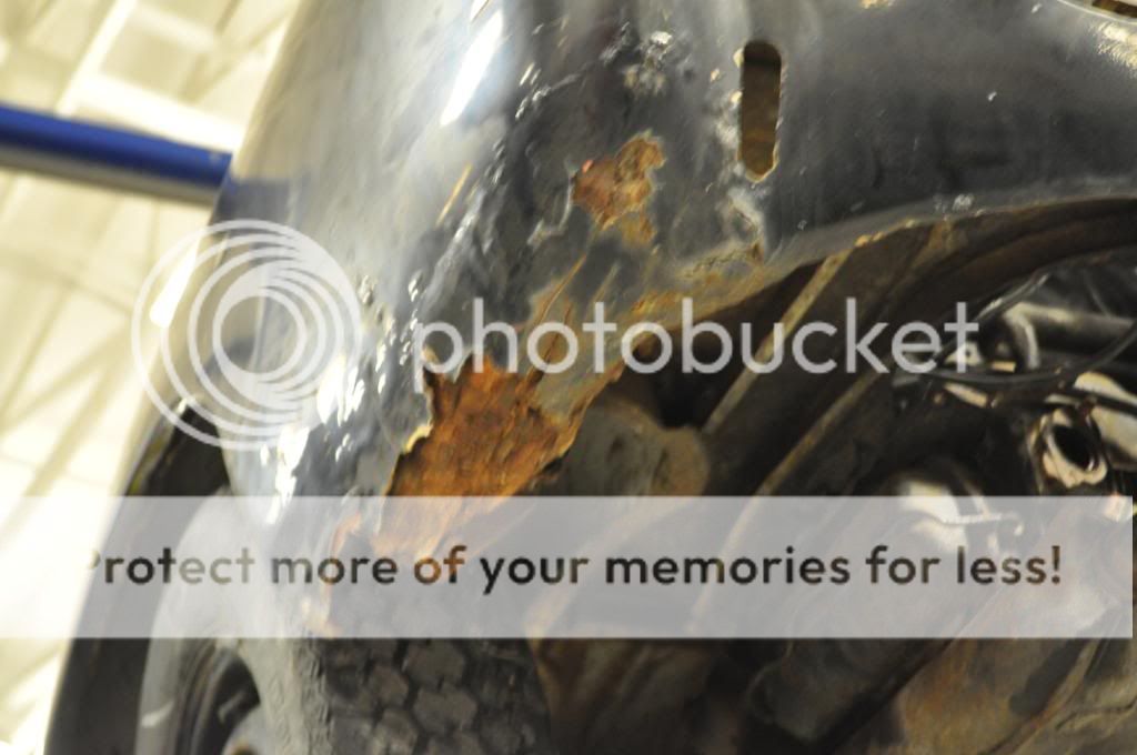

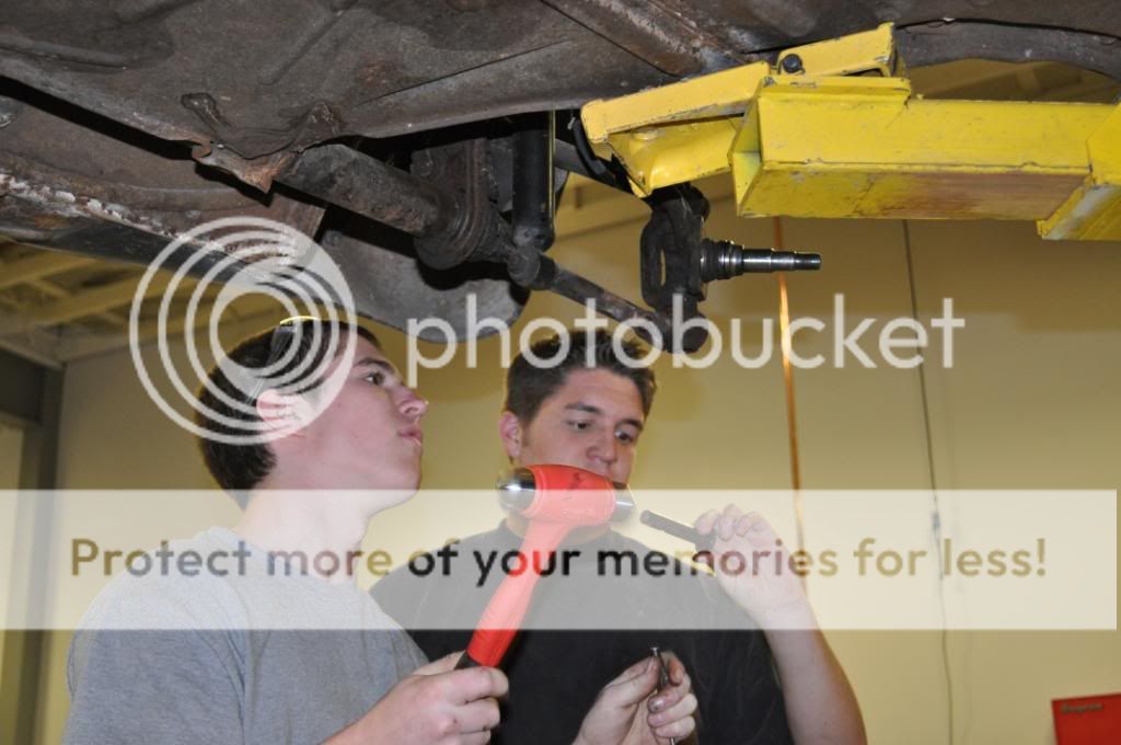

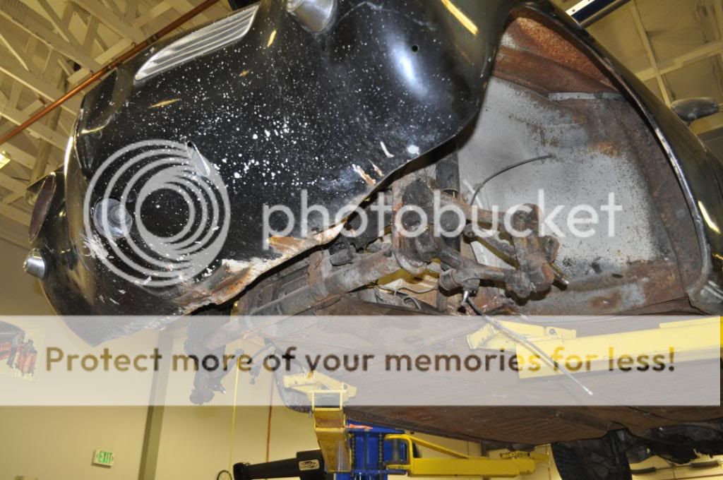

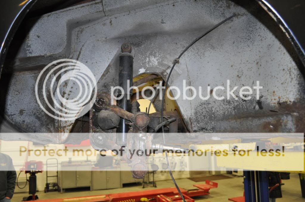

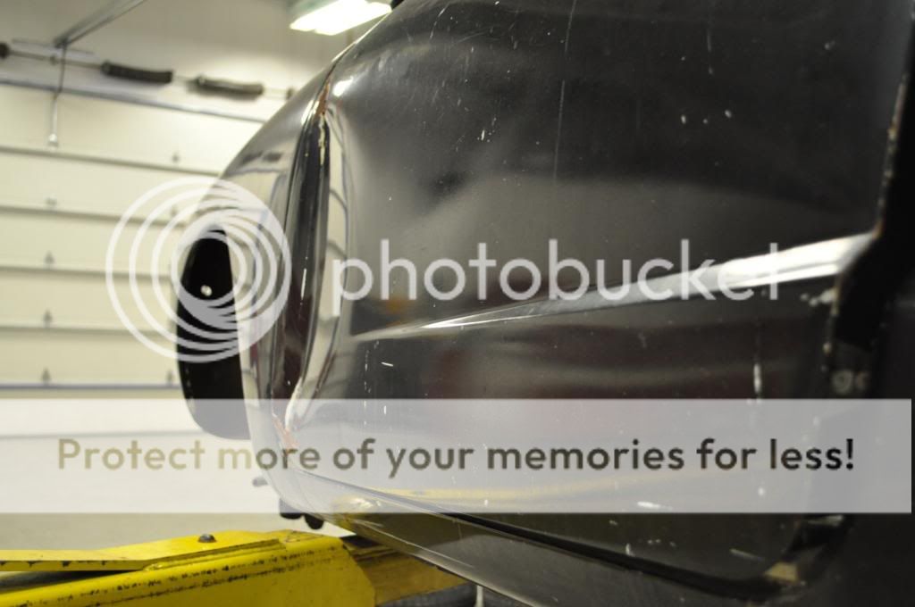

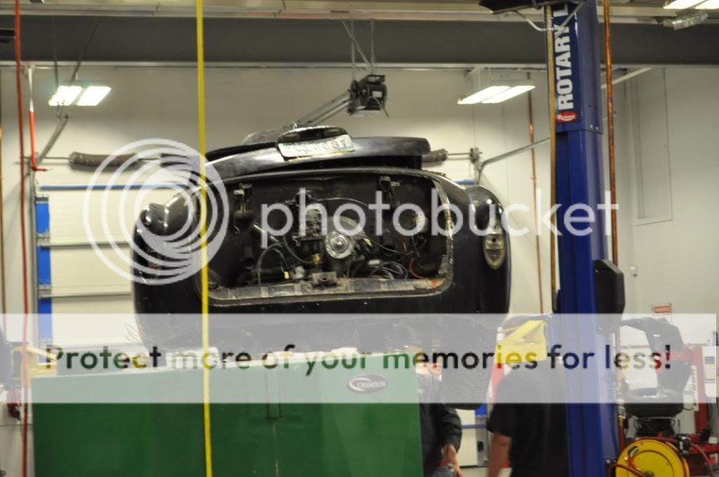

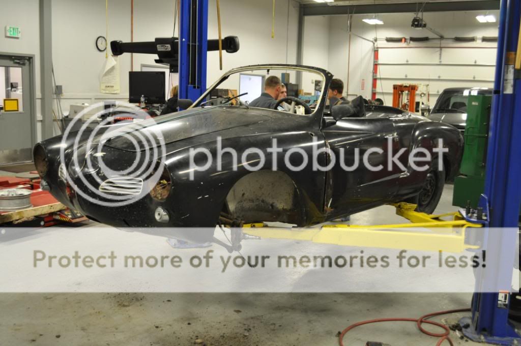

First Pics of our Roadster project, I purchased this ghia in 1997, had an engine fire in '99 and it has been awaiting resurrection ever since. Today is the day! It has a 12 volt conversion and runs an 1835 which sparked up nicely after ten years. The top was off when I bought it so don't blame me for this sacrilage.

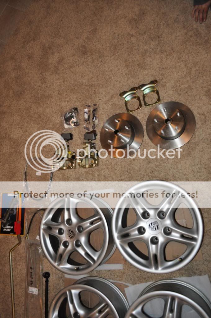

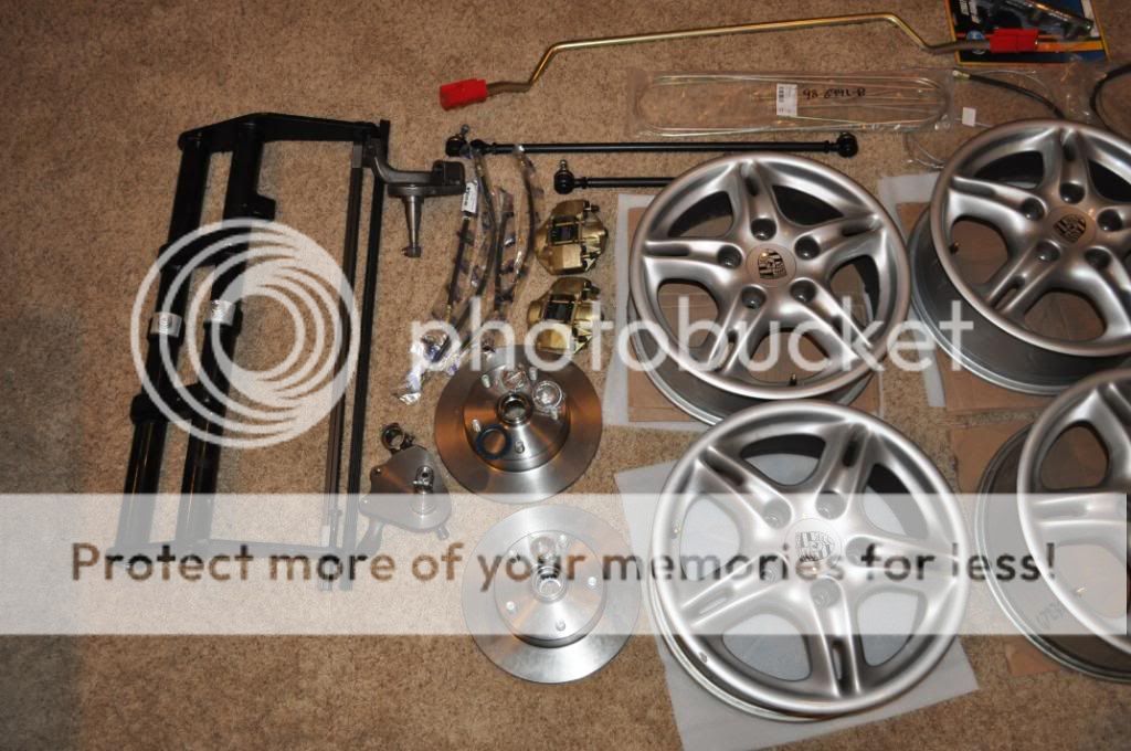

All the future bodywork has been paid for and we have 16 in. Boxster wheels with discs all around. Any comments and help would be greatly appreciated as this is the first resto of this extent we have attempted.

Those wheels will work well.

Thanks, about those wheels, we were looking at 17 " but after talking to Corwin (sorry for the double post) I decided on the 16's so we would have less worry about fit and focus on everything else this car needs.

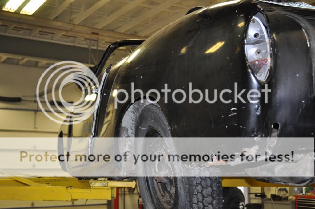

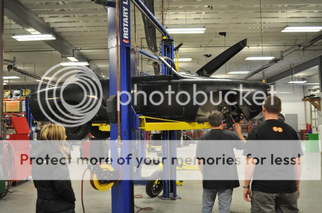

You are going to need to add some type of support in the car to keep it from buckling. The roof provided structural support, and the standard verts have reinforcements added.
Back in high school we purchased a ghia that someone added a convertible top to. We bought the car for the engine primarily, but I drove it for a year. Anyhow, the doors began having a harder and harder time latching. Essentially the car was trying to make itself into a U shape. I would look at what the convertibles do and try to mimic that .

PostPosted: Fri Jan 23, 2009 10:39 am    Post subject: Buckling Reply with quote
thanks Werka, it had a roll bar in it that helped but you are right, I think we will do something similar to Scott Sain's roadster as far as support goes, it was already buckling a bit from the lift, you can see the passenger door in one of the pics.
Sains reinforcement at http://www.kustomcoachwerks.com/gallery/main.php?g2_view=core.ShowItem&g2_itemId=17040

Is that an old school Holley Bug Spray?

It is a Holley, the rebuild kit was harder to get because of its age I guess. My 17 year old rebuilt it before starting it up but he says he doesn't know the pros or cons of that carb... Anyone care to explain?

The one I had also had a roll bar in it. Even so, if you are starting I would recommend a little extra, or go overkill on the roll bar.
The roll bar I had didn't go to far in front of the seats. It was basically behind the front seats. Nothing tying it to the front of the car to add some rigidity.

PostPosted: Fri Jan 23, 2009 2:36 pm    Post subject: roll bar Reply with quote
Yeah, mine was the same as yours, did you check out the reinforcement on the roadster URL I posted earlier? It looks pretty solid without getting in the way much. Also plan on reinforcing along the pan near the rockers. I really apreciate the info, this site is killer.ok I see your edit

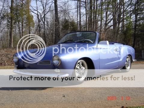

PostPosted: Fri Jan 23, 2009 7:47 pm    Post subject: More cars to drool over Reply with quote
ok, I get it shok you have the same bug (pun not intended) i do, here are a few builds I have been drooling over.
