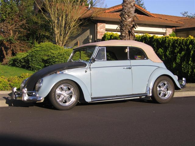

PostPosted: Sun Aug 16, 2009 5:45 pm    Post subject: Reply with quote
here are my 175/65/15's
