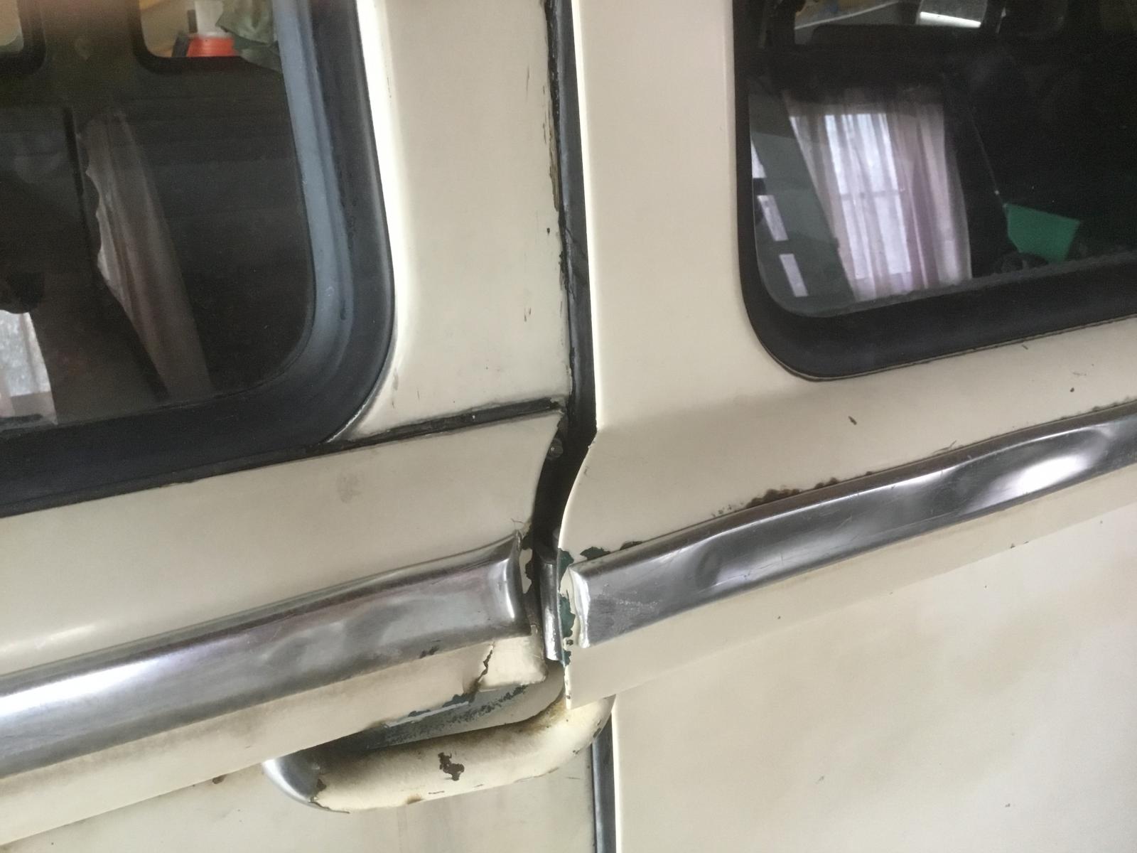

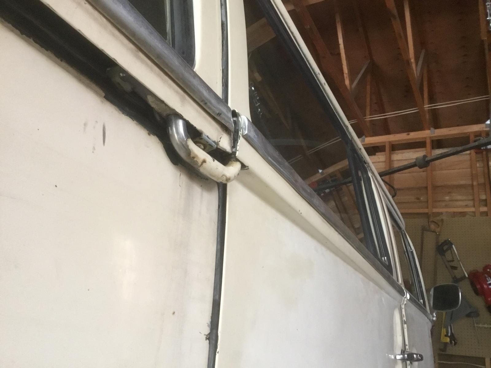

PostPosted: Wed Jun 25, 2025 7:04 am    Post subject: Re: Sliding Door Support Roller Refresh FAQ Reply with quote
SGKent wrote:
Can you confirm for everyone including me as I read your post, that it is really easy to slide the door closed, everything there is fine and that the front latch catches, but the back will not pull in when you move the handle to pull it in (early bay)? Late bays do not have this mechanism.
I would say it slides easily. The front of the door touches first as I slide it to close but doesn’t automatically latch. If I put some closing pressure on the door and lift the handle up, it doesn’t go all the way up and doesn’t click. If I release the door it slides back open and I can then pull the handle up and it clicks. Pulling the handle back down it clicks again.
In order to latch the front (and back) I have to get some momentum and push hard from the back in order to complete the close. The back does not easily close without some force.
When it is latched in the front and with the small gap in the back (so almost closed) and I pull the handle up, the handle clicks as I pull up and the door springs open. It does not pull the rear of the door in.
Photo of partially shut door with small gap.
Photo of successfully closed door. Still not quite flush with the body.
Even with the door successfully closed, the back of the door is not flush with the body, while the front is flush.

PostPosted: Wed Jun 25, 2025 12:04 pm    Post subject: Re: Sliding Door Support Roller Refresh FAQ Reply with quote
you've got body damage at the back latch. You will have to figure out what the significance of that is before getting everything back to normal is my opinion. The latching mechanisms may be damaged too or the door alignment.

To close my door, I have to put a little pressure on the rear hinge with the palm of my hand and manually activate the door handle (downward) and push the rear flush and latch it. A "rolling slam" won't close it. Pushing inwards at the rear hinge wont latch it either, unless I activate the handle.
Slathering everything with Lithium grease seemed not to help.
Where should I start?
75 is a different mechanism than the previous poster's, yours should close in a single slam. Things to improve it would be both of Colin's refresh tutorials, some careful adjustment according to Mr. Bentley, and leaving a window down a little if all else fails.
