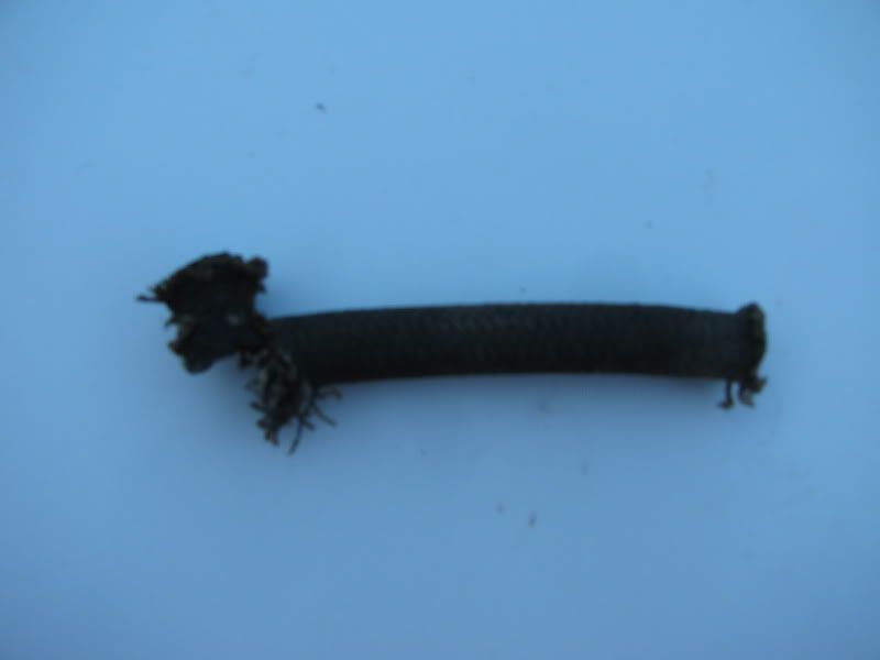

kevin11 wrote:
Just stick with german braided line as a rule.
Worst advice you could ever give. Stay just as far away from braided fuel line as you can. It may have been the gold standard 10 years ago, but it's simply the worst thing available now. I enjoy a good engine fire as much as the next guy, but keep that shit off of your vehicles and stop recommending it to people.

PostPosted: Tue Jan 25, 2011 5:23 pm    Post subject: Reply with quote
Your FLAPS is ripping you off, regular Gates fuel line runs me about $1.50 foot for 5/16" and $3.25 foot for FI hose of the same size. The Gates is rated for use with Ethanol blend which may be the problem with the German braided.
