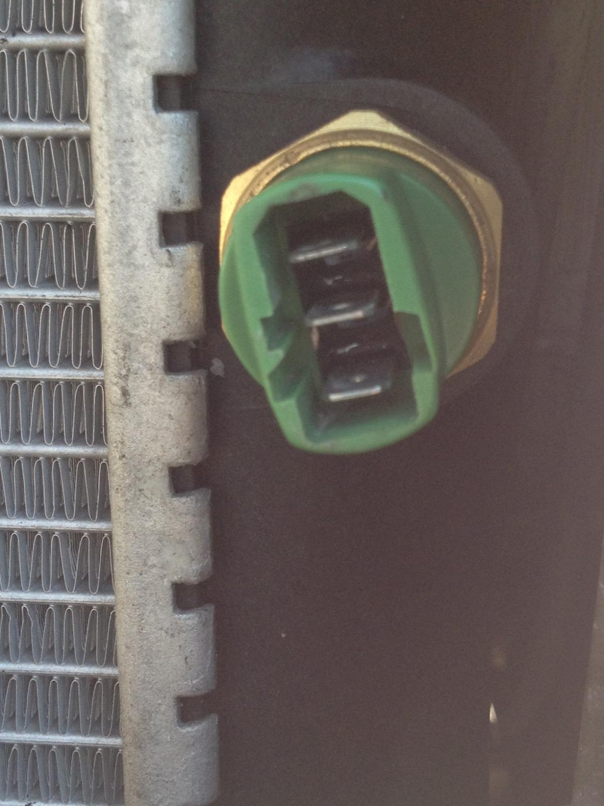

PostPosted: Sun Jan 25, 2015 12:23 am    Post subject: Reply with quote
I went ahead and did my radiator upgrade this weekend on my 82 diesel. Everything wen't well except for the 3 wire connector for the rad temp switch. I have the two red/black (or dark blue color blind to tell), and the two smaller wires. How does one connect those up to the temp switch? I could splice and use the female connectors.
I forgot to pick that up, and did the radiator replacement already :/
What would be the part/number for this pigtail? Or is it possible to just create this via another method?
Thanks!

Will, the temp switch harness with the small gauge wires is for the high speed fan. They control a relay inside the van. The larger gauge wires are for the low speed. You will use 3 of those for wires with the 3 blade dual speed switch. Looking at the switch the outer two spades I recall are low speed, the middle spade is high. So you need power to the switch and then identify which one you need to energize the relay for high speed and connect that to the center spade. I could also be completely wrong and you should verify the wiring in the Bentley manual. Because you are switching power, I don't believe you can hurt anything if you get it wrong while figuring it out. Obviously if you don't get the fan working and drive the van, it will overheat. That would not be good. I am not aware of an adapter.

You missed my point. I would ensure the radiator fan is cycling properly after doing all this work. Based on your logic, he could leave it disconnected, which is not quite what the engineers envisioned. I was letting the member know that he would most likely not damage the electrical components while testing the correct pin location.
From memory the pins on the switch are number 1, 2, and 3. 1 would be power in. I believe 3 is low and 2 is high. I have done the same modification, but can't quite remember the pin location. That is why I suggested looking at the wiring diagram.

Rsxsr,
Thanks for the insight. I have the switch mounted to the radiator, so I guess I just need to figure how to determine which prong on the fan switch is 1,2,3. Since, I installed by screwing it in, it's rotated a bit so I would need to inspect it more to determine prong 1,2,3.
I also wasn't sure should one use plumbers tape on the threads when installing the radiator to the switch into the radiator? Or was that a bad idea?

Of the four wires on the 82'
The two larger and the two smaller pairs.
I was able to get a 12v reading on one of the smaller wires.
I got a low (barely readable) voltage on one of the larger wires. Is this normal behavior? Or should this also read around 12v?
Thanks!

If you touch the ends of the 2 larger wires together the fan should run on low speed. Touch the smaller wires together and it should run on high speed.
The OEM quality rad temp switch has the 3 terminals labeled on the switch if you look very close at the pin area.

Mark,
I have verified that connecting the large two wires together starts the low setting on the fan.
I have also verified that connecting the smaller wires fires off the high setting of the fan.
I’ve looked at page 97.82 track 137-138 of the Bentley to get an idea, but it really doesn’t indicate the pin location to me either.
Just to be clear that I understand what peopler stating is that the hot (live wire) of the smaller relay wire should be on the center switch pin. The non-live wire of the smaller pair is tapped up and tucked aside.
The two larger wires, of one being a hot (live wire) should be placed on the outer pins.
From the outside of the fan switch that you connect into I’m not seeing an indication that shows a labeled pin 1-3 on the fan switch. However, if it’s small enough I may not be able to see it. Here’s what it looks like in-case it jogs someone’s memory seeing how it’s positioned.
Meyle 1009598717
Just making sure I’m on the right page / before plugging in and buttoning it all up.
Thanks everyone!
Mark
Thanks!
-Will

crazyvwvanman
Joined: January 28, 2008
Posts: 10464
Location: Orbiting San Diego
crazyvwvanman is offline
PostPosted: Tue Jan 27, 2015 10:07 am    Post subject: Reply with quote
No, that is wrong. The small hot wire is the wire not used anymore.
Mark
rotaecho wrote:
Just to be clear that I understand what peopler stating is that the hot (live wire) of the smaller relay wire should be on the center switch pin. The non-live wire of the smaller pair is tapped up and tucked aside....
