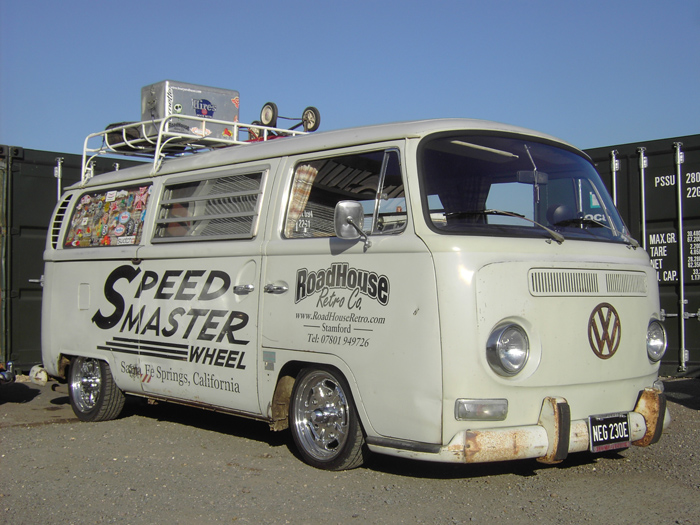

I think the tricky part is that the longer stalk is only on a Bay Westy mirror, and the early ones at that. Might be pretty rare. Was it Hiram6 who posted about this one? I got one out of a Bay hardtop and the stalk was no longer than my stock Vanagon Westy mirror stalk. I wound up cutting it and extending the stalk with 1/2" copper plumbing pipe (props to the guy who suggested this--works great and is cheap!). I used about 4" but it 6" would have been better, positioning the mirror lower for improved rearward visibility past the overhead cabinet.
I found this pic by drumming123 that looks like the mirror I got and not the long-stalk one.
Compare with the mirror in this pic by Timmy G:
