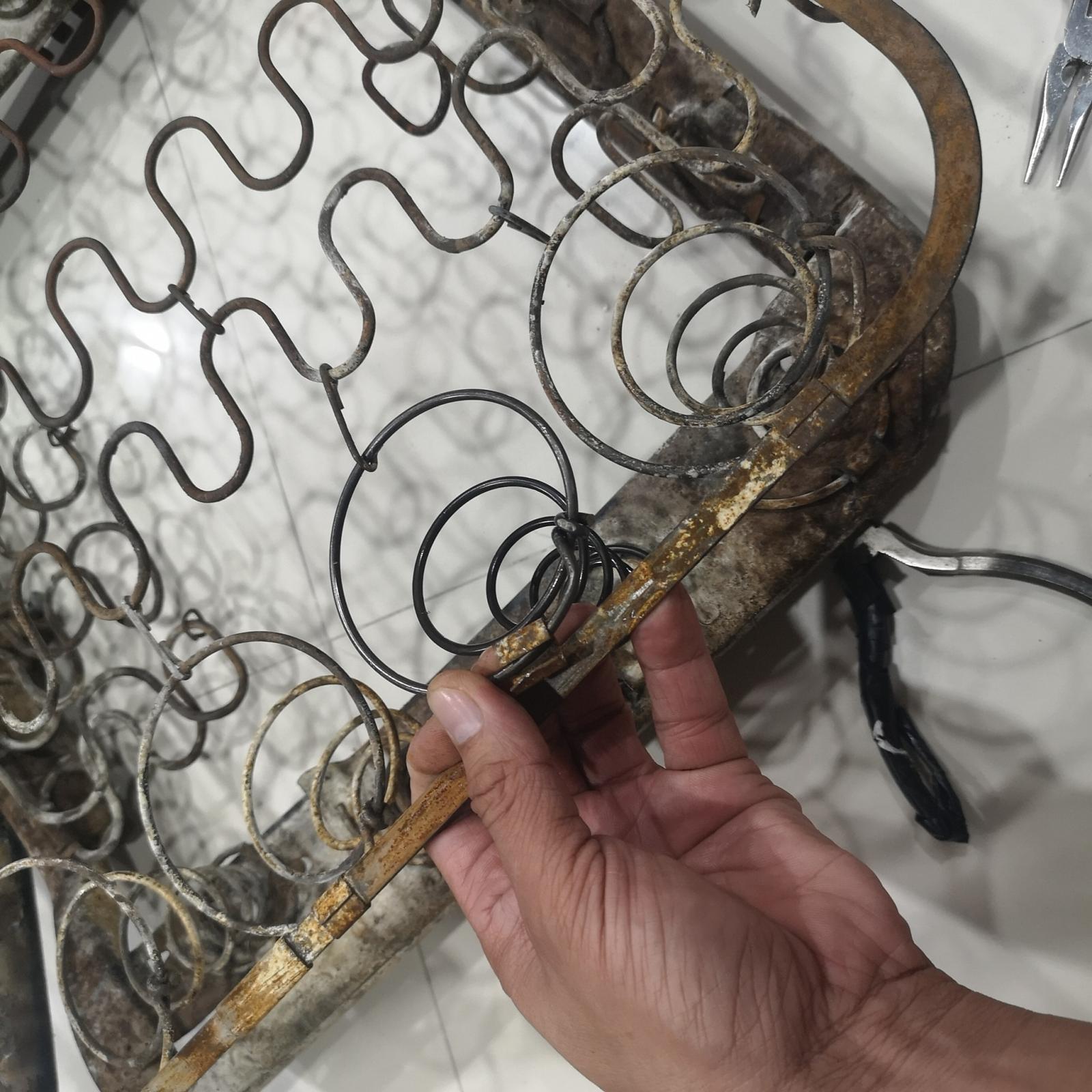

napat
Joined: March 15, 2003
Posts: 252
Location: bkk, thailand
napat is offline
PostPosted: Thu Sep 28, 2023 9:50 am    Post subject: Re: Seat Spring Fix Reply with quote
I did it Smile
love double cab

wrxnofx
Joined: July 06, 2022
Posts: 295
Location: Richfield, MN
wrxnofx is offline
PostPosted: Sun Oct 01, 2023 12:52 pm    Post subject: Re: Seat Spring Fix Reply with quote
napat wrote:
I did it Smile
May I ask where you got the springs from and what diameter/height they are?
1977 VW Type 2 Bay Window Westy FI
napat
Posts: 252
napat is offline
PostPosted: Sun Oct 01, 2023 5:36 pm    Post subject: Re: Seat Spring Fix Reply with quote
wrxnofx wrote:
napat wrote:
I did it Smile
I repro them here in Bangkok.
exact the same length and constant.
love double cab
jtauxe Premium Member
Joined: September 30, 2004
Posts: 5963
Location: Los Alamos, New Mexico, USA
jtauxe is offline
PostPosted: Thu Jun 12, 2025 6:46 pm    Post subject: Re: Seat Spring Fix Reply with quote
Sawatdee khap!
Have you thought about putting an ad up here on The Samba? I'm sure lots of folks would buy them. Me, for instance.
napat wrote:
wrxnofx wrote:
napat wrote:
I did it Smile
