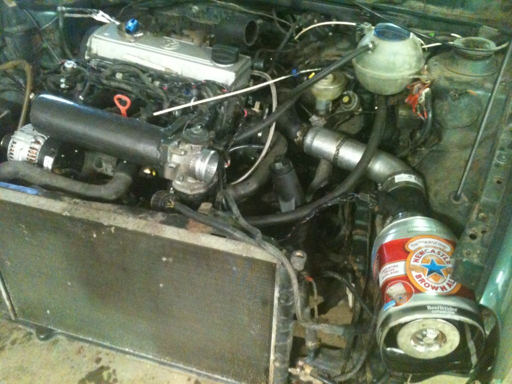

I was going down the path of a 16V 2.0 aba G60 hybrid but decided to go with a TDI. BBM has lots of parts and goodies. I've also just pulled a fast G60 out of my vanagon. I have also have a new built aba and parts 1.8 if you go down this route.

You can paint the vanagon red and put flashing lights on top because everyone will think you are a firetruck coming down the road! Those chargers from BBM are NOISY! The G-ladder is expensive and not so reliable. If I had to supercharge something I would probably use a vortec.
The g60 can be/is garbage and is prone to premature failure. The engine puictured AND the charger i am speaking of isn't a g60. It's a twin screw charger and is waaaaaaaaayyyyy more durable then the g60. It isn't quiet but it isn't silly loud either. However noise is a very subjective topic. Honestly with the power out put potential of this charger i wouldn't mind the extra noise(form fallows functioin). The bbm twin screw is more effecient(80%) then a Vortec charger. The prob with a twin screw, Vortec and others is price.... For the price a charger alone you could do a 1.8t. Thats how the #'s crunched for me....

Yeah thats loud!! I forgot how loud, thanx for clip, brings back memories!!! If i could afford i'd still think about it though Razz Cool
