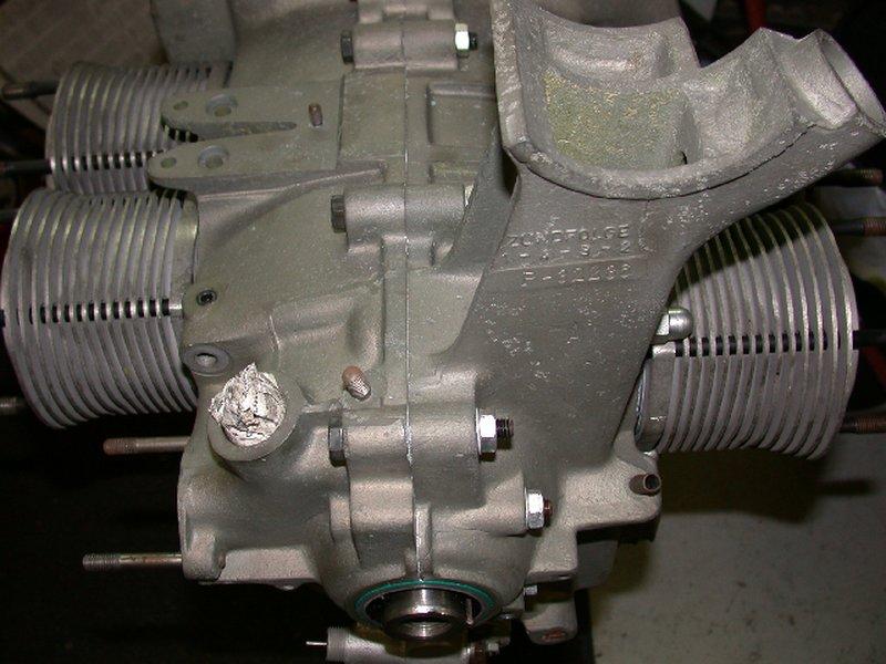

Here is one very interesting car to support the first post:
Coupe no 11237 - Early February 1952
1300ccm Typ 506 engine no P-20905
Totally untouched original car...the close up of the engine give some very interesting hints:
1. Magnesium case (judging from the picture)
2. Hole for oil filter is there and machined, but plugged and not used (many say oil filters were optional from 51, but std from 53)
3. Casting-area around engine number is of "VW 30hp"-style", not "VW 25hp-style"...and this I find very strange...

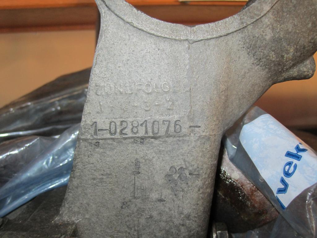

To illustrate my engine-number casting-area difference - here are two pictures of some VW blocks I have:
May-1952 VW 25hp Magnesium-case:
January-1955 VW 30hp Mg-case:
.....very very strange that a Feb-1952 Porsche case has the "post-Dec-53" VW type engine casting....this is a mystery to me.

OK...I went through some engines in the barn here..
The change in the casting in this area must occur sometime during 1953...and we need more pictures of original VW engines from this era..
No doubt, the "curved type" was introduced during the last year of 25hp production, so there is both styles on a 25hp.

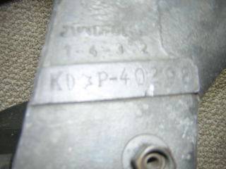

52 1300 case

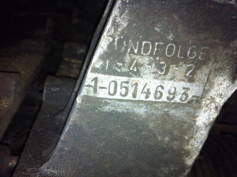

So I did a little cleanup and tagging of my images of early engines. Here is a set of '53 engines sorted by serial number. You can see that the earlier engines have the "angle type" casting and later you begin to see the "curved type" casting. The last two images are of an early 1500S, so the casting is consistent with the earlier form.
Of course, this is a small sample, so you can't really say anything definitive. But it looks like the casting changed during '53 model year production. All of my '54 images are "curved type" castings.

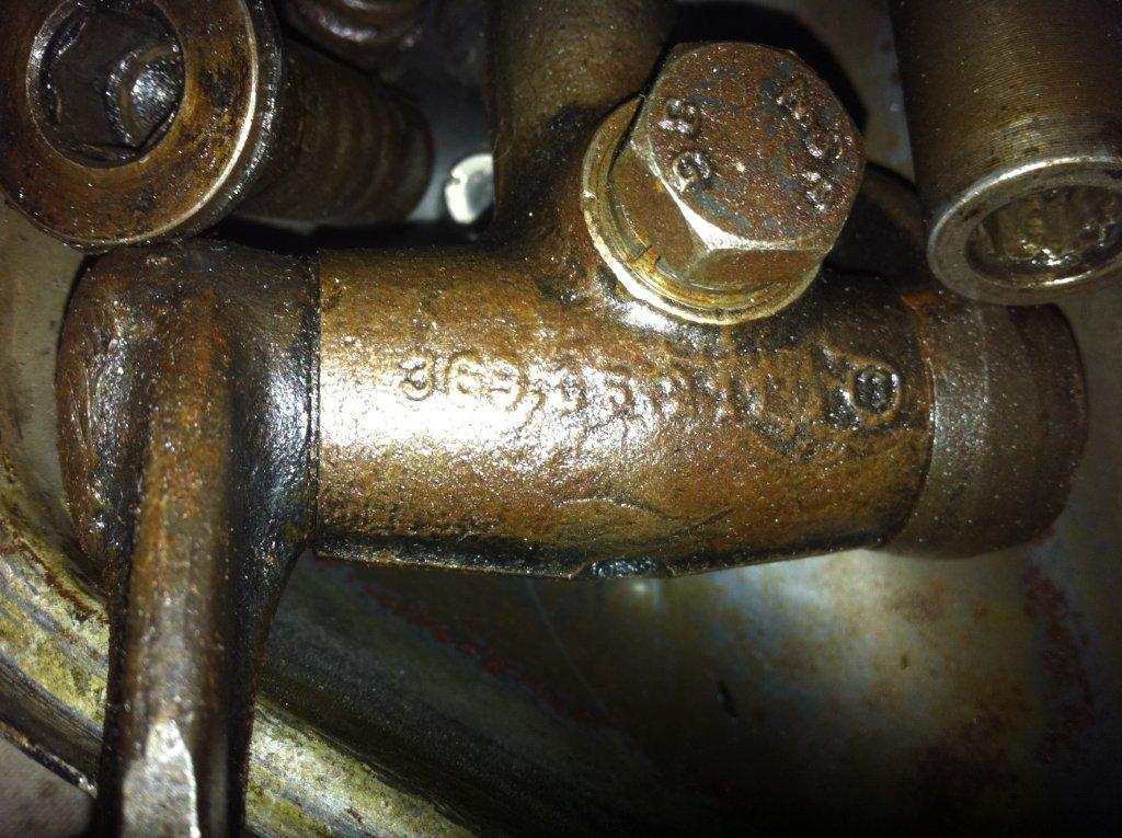

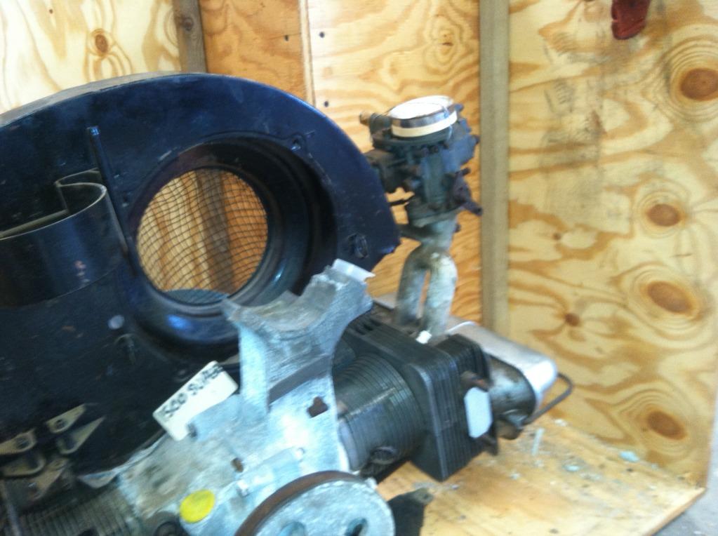

I typically wouldn't post in this forum but since I picked up this motor today I am!! Short block only so can't answer too many questions but if anyone needs any case specific info let me know.
Motor# comes up as a January 51.

turkis-deluxe;
You have a very early VW mag case...the change occured with engine number -1-0272061 on 19th Jan 1951.
