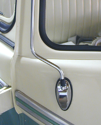

Here's a couple of photos, showing the finished antenna. In trying a couple of ways to bend the antenna I destroyed about 6" of the bottom section. I figured out a fool proof way on the second try. So, next time I'll have the full section on the bottom of the mast.
Yeh, Dubluv, a tube bender helps, but without modifying the mast it will always collapse or break. I'll explain my solution later.
Here's a photo of the finished product:
https://www.thesamba.com/vw/gallery/pix/123744.jpg

Here's another photo of the whole thing:
https://www.thesamba.com/vw/gallery/pix/123760.jpg

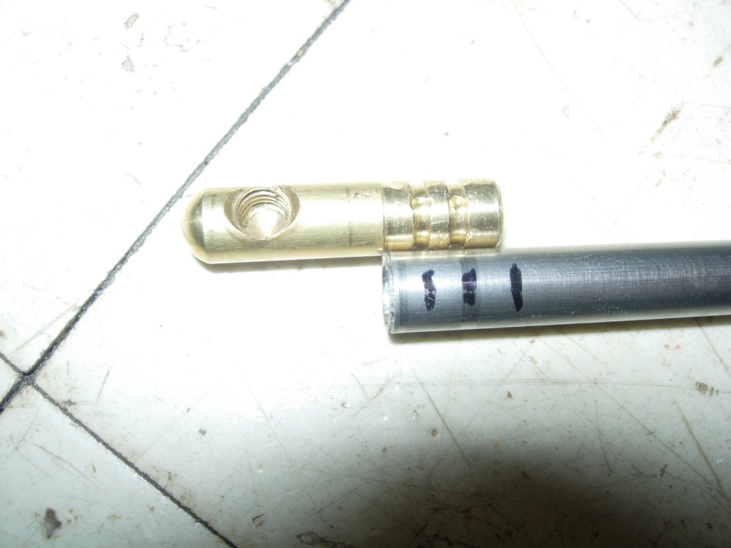

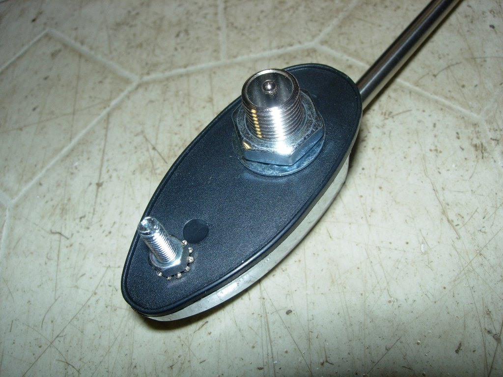

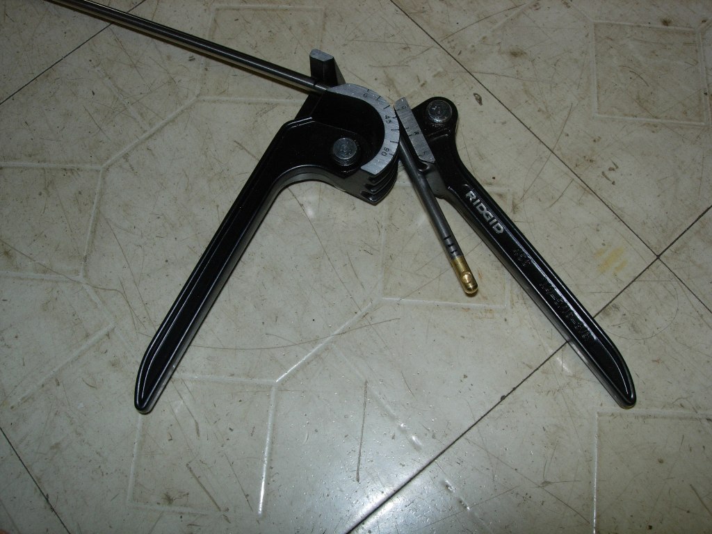

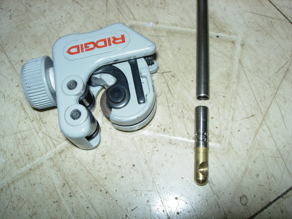

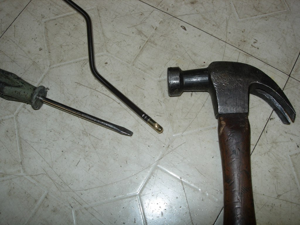

I finally had a need to make a safari antenna, and I got some great information off this thread. However, I saw that Scott didn't get around to posting instructions working with the newer stainless steel antennas, so I thought I'd update this with a tutorial. My antenna came from Wolfsburg West, who I believe manufactures their own antenna, so the information should be accurate as long as you get the antenna from them.
Here is what you are starting with. A stainless steel antenna with a chromed plastic base, nuts, washers and a seal.
Take off the nuts, washers and seal.
Remove the large thin nut.
Unscrew the large post by double nutting the threads.
Slide out the antenna from the base.
Using a utility knife, cut the plastic sleeve as pictured and remove.

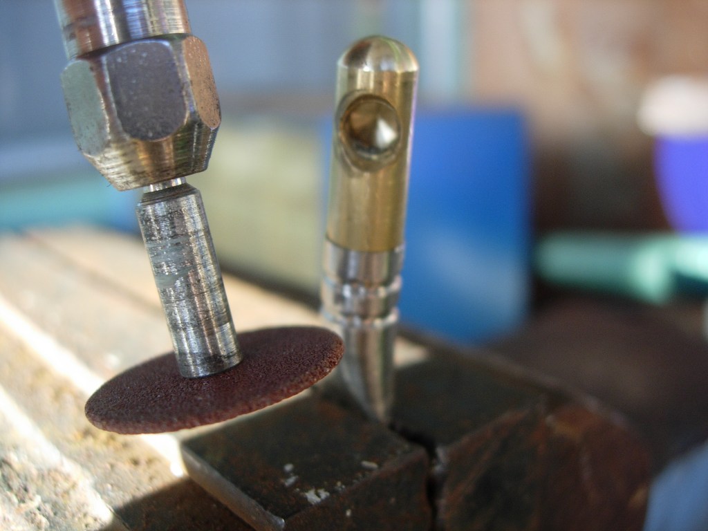

EXTEND THE ANTENNA, then cut the bottom portion of the antenna as shown. I just guessed how much to cut. Luckily, I cleared the brass plug. Also, if you don't extend the antenna, you might hit the lower portion of the middle section making the antenna not stay extended.
Using the side of a Dremel cut off wheel, very carefully cut through the antenna left over on the brass plug. Try not to grind the brass plug itself.
Using pliers, pull off the cut piece of antenna and discard.
Mark where the end of the brass plug will be on the antenna as well as where the grooves of the plug are.

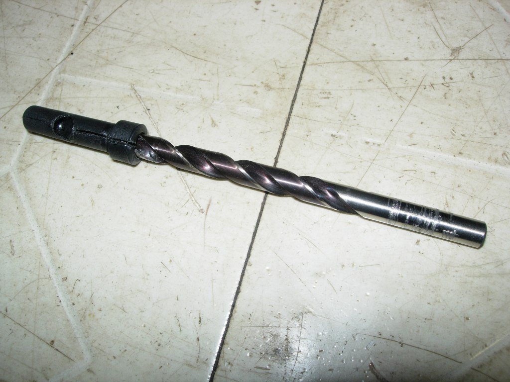

Buy some 1/4" aluminum rod and cut off about 9". This is per Scott's original tutorial. You might be able to get away with less, but I didn't want to take a chance.
Chuck up your 9" piece of aluminum rod into your drill press and sand away. I used 80 grit sandpaper and it took a loooong time. If you have a metal lathe, use that. If you have neither, sand it by hand. You'll eventually get there. You will also need to debur the antenna where you cut with the tubing cutter. Otherwise, it will give you a false impression of how much you need to shave away on the rod.

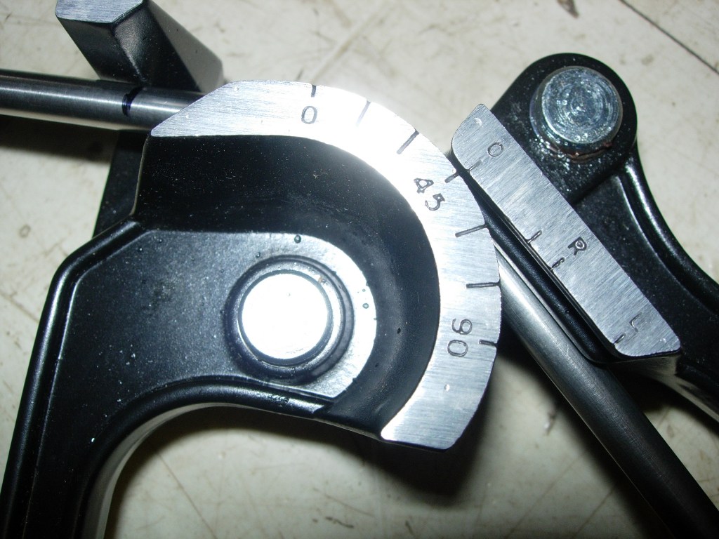

Insert the aluminum rod in the base of your antenna. Put the brass plug in to keep the aluminum rod from sliding out. Don't worry about the orientation of the threaded hole on the brass plug at this time. I measured about 2 1/2 " up from the antenna base and started my first bend there. I bent the antenna at a 45 degree angle.

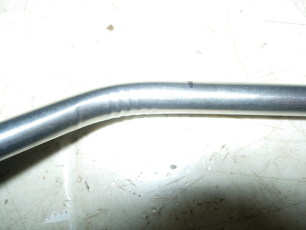

I measured up 2" and made the next bend the opposite direction at 45 degrees. You can see the slight crimping at the bends. These are unavoidable, but do not look that bad at all. Without the aluminum rod inside, the antenna would kink.

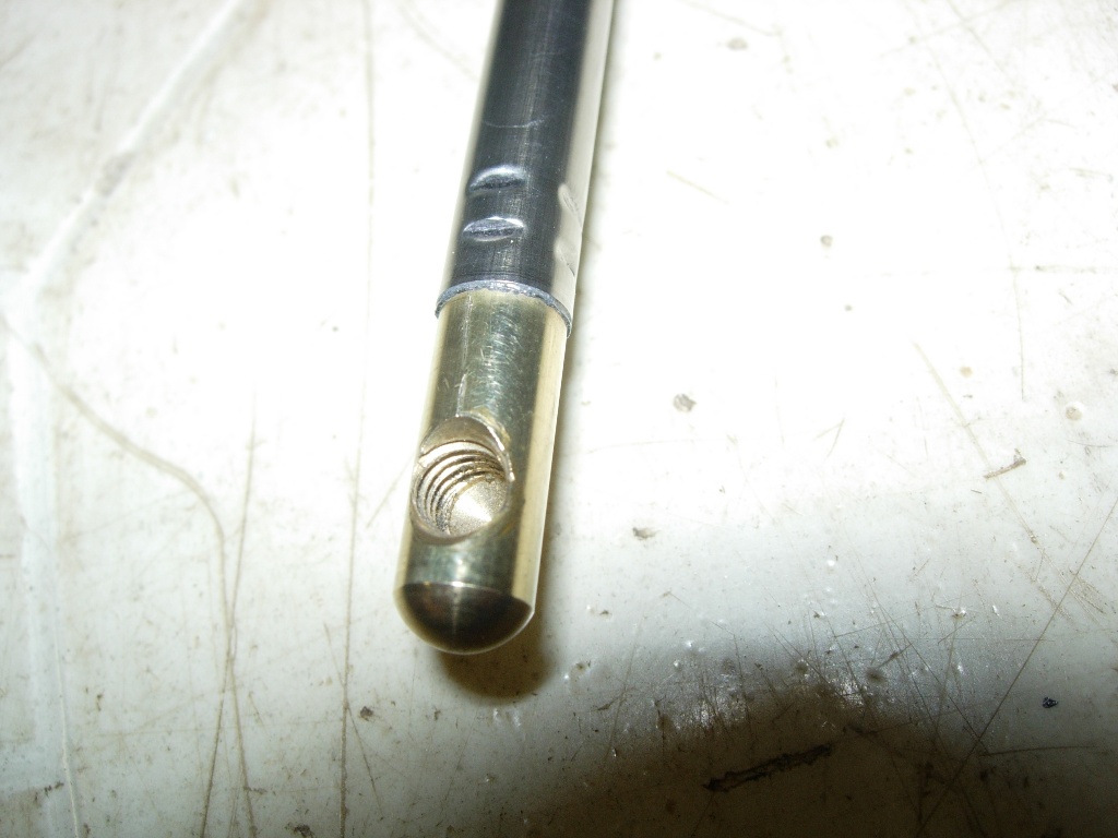

Now that the bending is done, make sure the threaded hole in the brass plug is facing as shown in the picture then peen it on the marks made earlier on the antenna that coincide with the grooves. This will keep the plug from spinning or popping out.
Cut out the grooves on the inside of the plastic sleeve with a 17/64" drill bit. You can do this by hand or with a drill. You could skip this step if you peened the antenna evenly all the way around.
Assembly is the reverse of the steps shown in the beginning and you are done!
