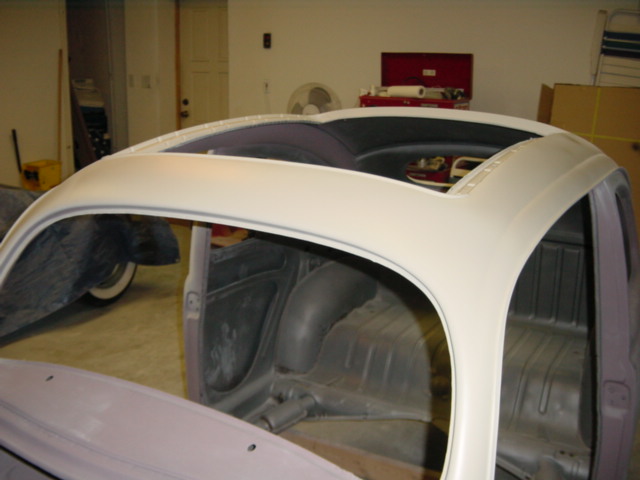

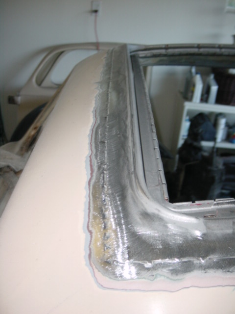

Heres what I have done so far...
Cut hole
flanged edge
welded the clip every 1/2"
ground down the welds
Now I plan on a skim coat of filler and lots of sanding. Does this sound correct...I have never done body work before and this was a fairly large undertaking for me! I just couldn't stomach paying someone $1200 to do it for me!
Any thoughts or advice would be greatly appreciated!
Thanks!
John

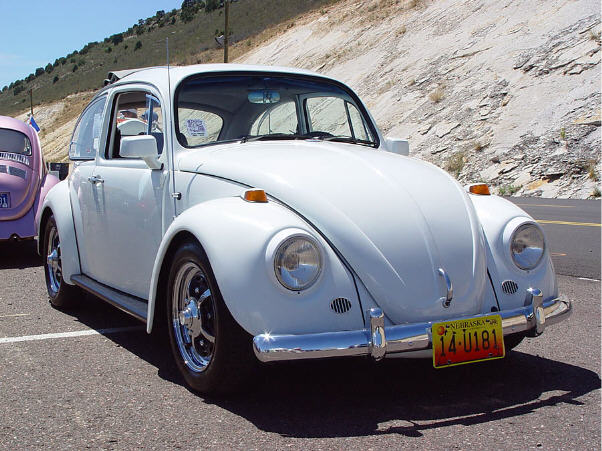

That is how I did one in my 67. The alignment in my 67 was different because of the windshield curve. My headliner fit a little tight in back. I think my section is about ½" closer in the front.
Did you put the little corner pieces in on the inside front corners? Your headliner has to go up past them so there has to be a little room there.
I was thinking of doing another one and I have seen where they flange the panel then use a new GLUE to stick repair panels on and was thinking of trying that way.
You will love the new view when you get done!
Twice I have had people stop me and thought I had forgot a rug on top of my car and was driving off. What fools.
https://www.thesamba.com/vw/gallery/pix/114400.jpg

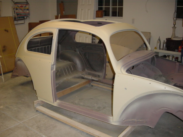

Finished the rag clip! For my first attempt at bodywork I am very pleased.
John
https://www.thesamba.com/vw/gallery/pix/131271.jpg
https://www.thesamba.com/vw/gallery/pix/131273.jpg
By the way it's a 57 with semiphores.

PostPosted: Mon Dec 22, 2003 10:12 am    Post subject: Reply with quote
John
You should be! That looks Damn Good! Congrats. I know you are Very Happy Very Happy Very Happy

Just looked at the photos......hey John that looks great....but you put it in backwards..... J/K

PostPosted: Mon Dec 22, 2003 4:22 pm    Post subject: Reply with quote
looks like a pro job... except cleaner Wink
