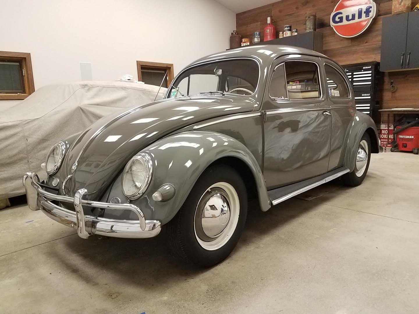

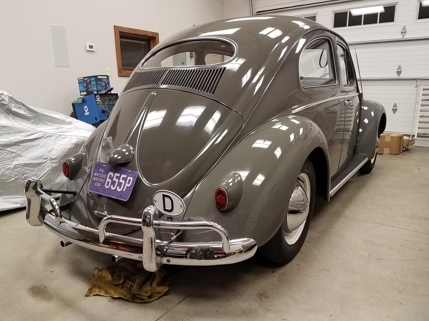

I'm glad I found this. I myself just picked up a 33k original mile 56 Oval that was polar silver new. Under the hood, decklid, and all the inside paint is still original and in perfect shape, however the outside was repainted what looks like anthracite. I've got every receipt for the car going back to early 1962, and the only thing I have that mentions paint was some touch up to a rear fender in the early 1980s with photos and the car was already that color. So I'm going with the assumption that it was one of these paint failure cars.
