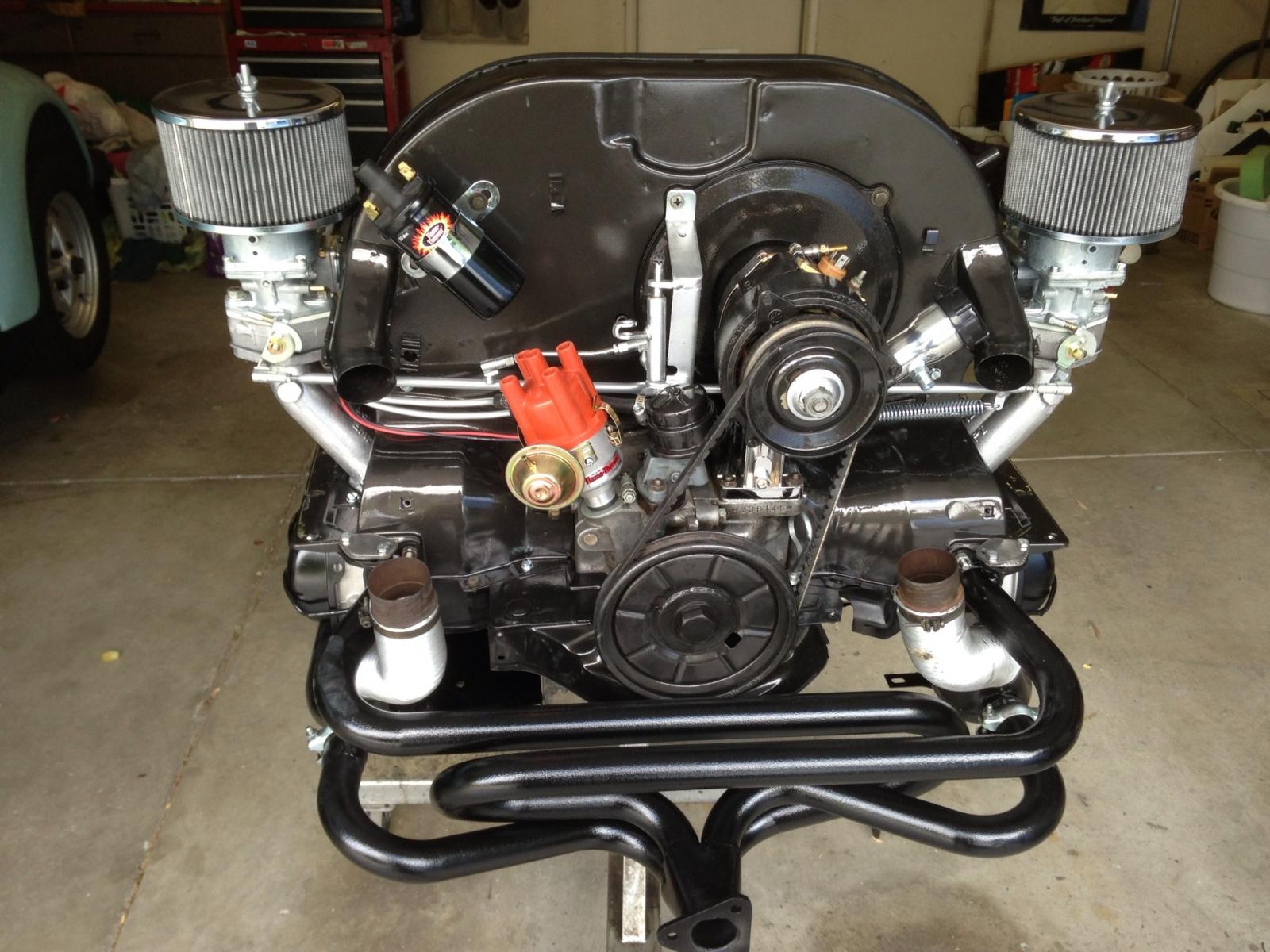

PostPosted: Sat Nov 30, 2013 12:05 pm    Post subject: Reply with quote
I currently make a 180 mile drive on Monday mornings and the return trip on Wednesday afternoons in my '74.
With the 1679cc motor I keep up with the traffic no problem. 70-75mph for 2.5-3 hrs each way.
The new motor will run over 90mph easily now Very Happy
I used the thick wall 88s, had a good friend machine my heads to accept the larger cylinders. We also did a complete valve job with new valves etc.
Also did some mild porting to match up the intakes and heads.
40mm Kads and Pertronix dizzy/coil.
Bugpack extractor and single QP
Stock internals, 8:1 CR
Run 87 octane with no predetonation
Timing at 32* with full advance
Doc
