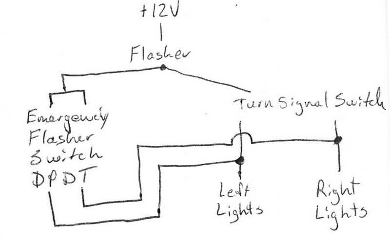

You just need one flasher and one DPDT switch. Then you just have to splice into the turn signal wires after the turn signal switch so they essentially get two power feeds. Both inputs of the DPDT switch are powered off the flasher just like the turn signal switch. Each output of the DPDT switch is tapped into one of the light wires coming from the turn signal switch. When the DPDT switch is off, the left and right light wires are separate and get no power from the DPDT switch and they work with the turn signal normally. When the DPDT switch is on, it connects both light wires together so both lights are powered from the flasher regardless of what the turn signal switch does.
The switch you linked will not work, it's an SPST.
That will work.... Suggest you use "constant" rate flasher designed to operate anywhere from 2 to 8 bulbs though (truck/trailer towing) ..

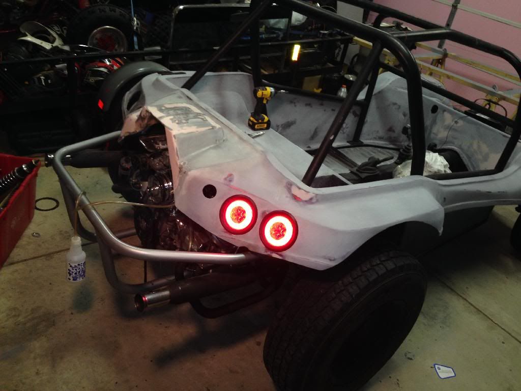

These are the tails with the park lights on. To simplify things the inside is center is the brake and the outside center is the turn signal. The outside halo isnt as obnoxious as in the pic, but the center is very bright. The front is a built in halo ring around the inside of the headlight.

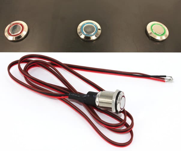

http://www.thecustomsabershop.com/16mm-Anti-Vandal-Latching-Red-Ring-Switch-P413.aspx
Buying a new DPDT switch (plus the required 680 Ohm, 1/4 watt current limiting resistor for the LED) will be cheaper than a "Dual Make" relay (if you can find one) required to make your existing switch work.
What pins would connect from the back of the switch to the turn signal wires? Where does the required 680 Ohm, 1/4 watt current limiting resistor for the LED go in this mix? Does it do the same thing as the no load Flasher? I am understanding why this would be the easier approach. Sorry, I am so overwhelmed right now. See you guys in the morning. Shocked
I believe you want to connect C1 & C2 common (to each other) and then to flasher output... Connect NO1 to left side lamp circuit, connect NO2 to right side lamp circuit... IF my understanding of switch is correct, it should do it for you...
Your 680 ohm resistor should be connected one side to the LED + terminal and other side of resistor to 12volt power source...
