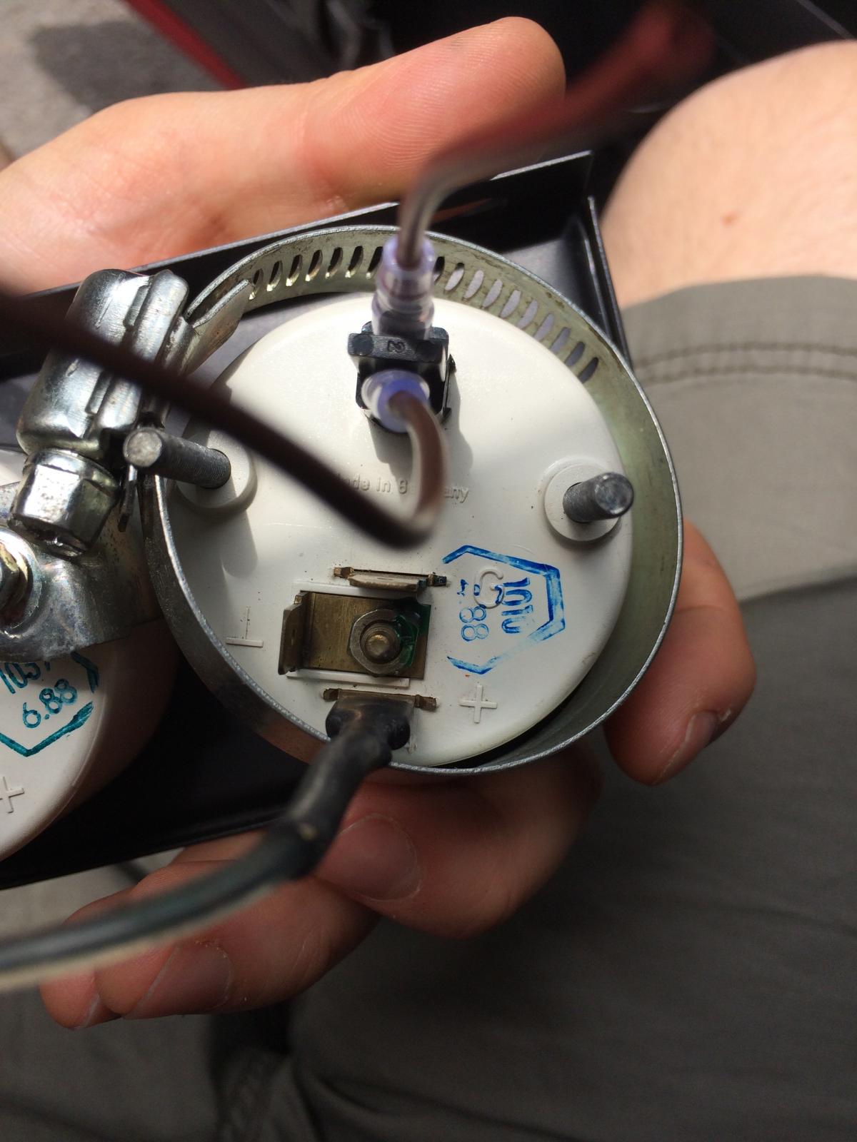

I got a second hand fuel gauge to supplement my stock one, and i did the following checks to see if it was working:
12v to plus terminal, G terminal to ground and needle moved up a little to zero.
12v to plus terminal, upside down T terminal to ground and needle shot up to full.
So gauge is good.
I then wire it up to the sender thus:
12v keyed to plus terminal
Black wire from sender to G terminal (other brown one goes to ground)
Wire to ground from upside down T terminal.
I turn the key on and the needle moves up a teeny bit to just before zero, despite the stock gauge showing a full tank, which is correct.
What can I be doing wrong?
Thanks in advance.

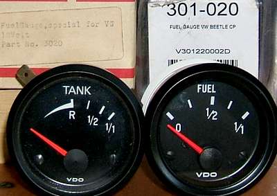

Sounds like this is an aftermarket gauge.
What model number is it? VDO sells one (VDO 301-020) that is "supposed" to work with the stock VW 1968-newer sending unit, but when I bought one 3 years ago and tested it, I found it wasn't even close - I determined that it has the wrong faceplate on it the needle movement. I talked about that here:
http://www.thesamba.com/vw/forum/viewtopic.php?t=2...p;start=28

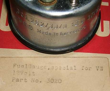

Oh, sorry, I didn't notice you posted the part number of the gauge. Yes that is not correct for a stock VW tank sending unit. I don't think ANY other car was ever made that had a gauge that would work with an aircooled German Beetle sending unit. Only those 3020 and 301-020 gauges were for to go with the stock bug sending unit.
The 3020 actually says 301.252/39/9 12V 37/8 on it
The 301-020, the one I found to have the same "movement" of the needle in it as the 3020, but they changed the faceplate and it does not match, that one says:
301 220 002 60/90 - 0.5 OHM 12V

Ah, I wish someone would have mentioned that in my other thread about the fuel gauges I've messed with over the years.
That does beg the question though, if the tank unit resistances were the same, why label an aftermarket gauge specifically as "special for VW"? I'd assume they would be OK for a Ford as well...
Not all senders with the same ohm ranges work the same (linear vs non-linear), tank shapes can alter readings, and gauges may not be labeled or function linearly, so you can get inaccurate readings if you start mix and matching. IE, 1/2 tank of fuel may not show 1/2 tank on the gauge. Generally, if a gauge is labeled for say Ford, it's likely intended for the OEM Ford sender and tank and takes those differences into account so everything lines up.
Put a Ford gauge in a VW and while the Empty and Full would be ok you'd be kind of guessing in the middle for a while. Take a linear VDO gauge, with a linear universal sender and put it in a VW tank and you'll notice the gauge takes a long time to drop from F to 1/2 but drops very quickly to E once it gets below 1/2 due to the non-linear tank shape.
emu88
Joined: May 20, 2009
Posts: 1857
Location: UK
emu88 is offline
PostPosted: Fri Jul 11, 2014 8:30 am    Post subject: Reply with quote
Thanks both of you. Hmm in that case i'll shift my current gauge and save this project for another day! Annoyingly I bought a twin pod thing so one will have to remain empty unless I find a replacement another time.
Thanks again, this'll prove useful when I get round to doing it.
