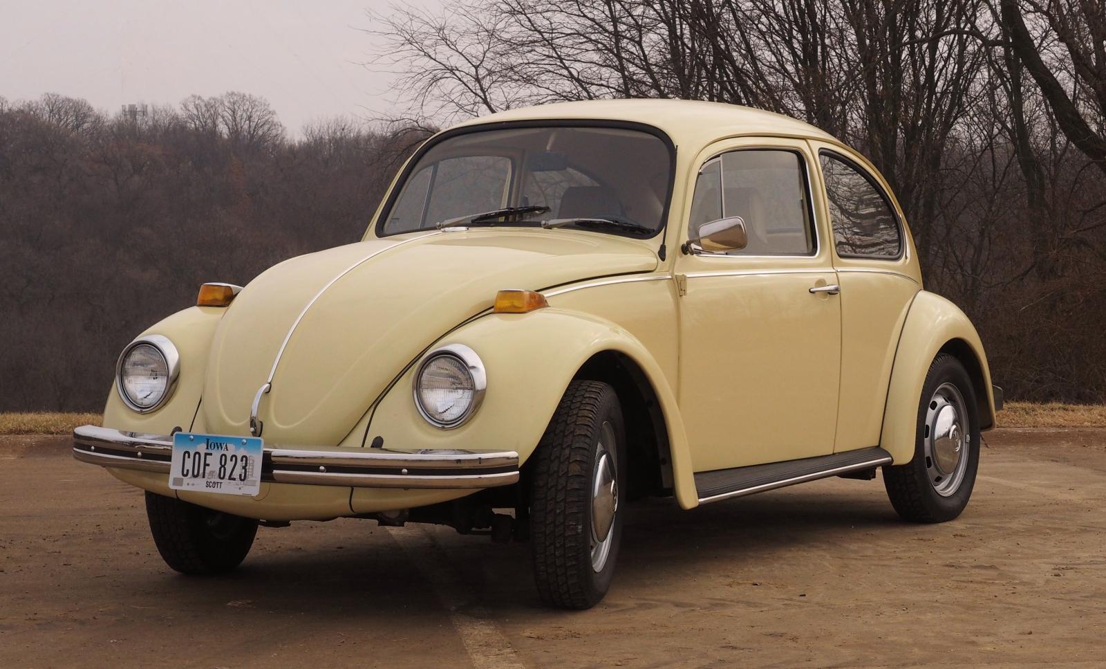

1) '71 beetle - Super or Standard beetle? Standard
2) Is it completely stock? What, if anything, have you modified? Stock as far as I can tell. It still has the oil bath air cleaner. I just bought it last fall and haven't gotten into it very far.
3) Have you been using aftermarket parts to keep it running, genuine german or?? German, as far as I know
4) Do you have a list of work that's been done to the car, when it's been done and how many miles since? The car came from California. It is rust free and very solid.
5) You mention that you will be using a local mechanic to "help prep the car". Would you mind giving us an idea on your mechanical abilities? Some people use a mechanic due to lack of knowledge or ability, while others simply don't have the time. He is the toast of the local VW club. He got certified by VW in ~ 1973. So, it is knowledge mostly.
6) Can you post some photos of your vehicle, to give an idea of its overall condition?
TheAmazingDave
Joined: April 11, 2013
Posts: 789
Location: San Jose, CA
TheAmazingDave is offline
PostPosted: Thu Feb 26, 2015 8:52 am    Post subject: Reply with quote
That's a goreous Bug. Smile

duanehaas
Joined: February 03, 2015
Posts: 4
Location: Iowa
duanehaas is offline
PostPosted: Thu Feb 26, 2015 9:03 am    Post subject: engine bay photo Reply with quote

oasis
Joined: December 12, 2002
Posts: 2193
oasis is offline
PostPosted: Thu Feb 26, 2015 9:07 am    Post subject: Reply with quote
... and in Shantung Yellow
Applause
Dancing
Yellow 181
Cool
