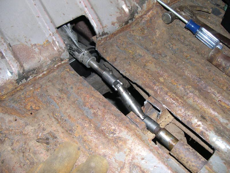

You should be able to do something like this pretty easily
dpetteng
Joined: November 14, 2006
Posts: 392
dpetteng is offline
PostPosted: Sat Mar 14, 2015 8:57 am    Post subject: Reply with quote
That's exactly what I was thinking of. Do you have more pics? Why is the transmission raised? is it to drop the van on the floor?

PostPosted: Sat Mar 14, 2015 9:11 am    Post subject: Reply with quote
Yes....thats the way to go! Ray
VWsArent4Hippies
Joined: April 13, 2005
Posts: 3081
Location: The Bull City
VWsArent4Hippies is offline
PostPosted: Sat Mar 14, 2015 9:16 am    Post subject: Reply with quote
Yea, trans raise to get the bus super low. Summit has a ton of u-joint options for whatever you'll end up needing
