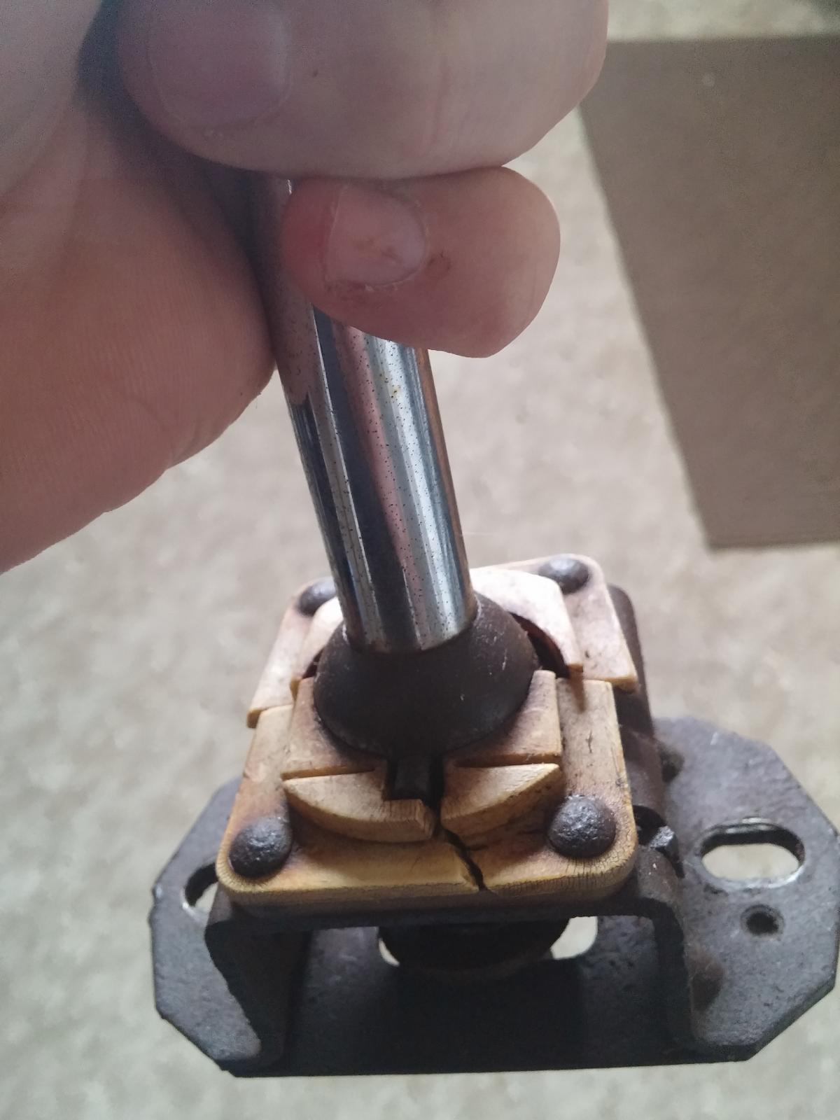

I have an original Hurst Saf-T-Trigger shifter that the plastic top plate has pretty much cracked and disintegrated on. Does anybody know if there is a way to rebuild these shifters or get replacement parts?
The Hurst website give a link to someone in South Carolina who is suppose to be their authorized rebuild/repair guy and I have emailed and called using the info given on the site but have never been able to get a hold of anybody or get a response through email. I don't want to just mail it to the address given without knowing if the address is still even good or not, or to find out I just mailed an expensive shifter to a company that is no longer in business. Any help would be appreciated.

There used to be a guy here in the cllassifieds that sold a Hurst shifter rebuild kit, but I don't see his add in the classifieds anymore. There are these.
http://www.thesamba.com/vw/classifieds/detail.php?id=813234
http://www.thesamba.com/vw/classifieds/detail.php?id=512669
May talk to this guy about finding some new nylon blocks?
There are also some posts on Samba about rebuilding the Hurst shifter.

Take the plastic plates from an EMPI trigger shifter (you can toss the rest). Small screws and locknuts to replace the 4 rivets.

Any machinist can make that part from metal or plastic. It could be bolted or pop riveted together.

Send the who,e thing to samba member Glandnut for a rebuild. It'll be good as new when you get it back

Theres a guy called Glandnut in the classifieds out of Florida that rebuilds these.
