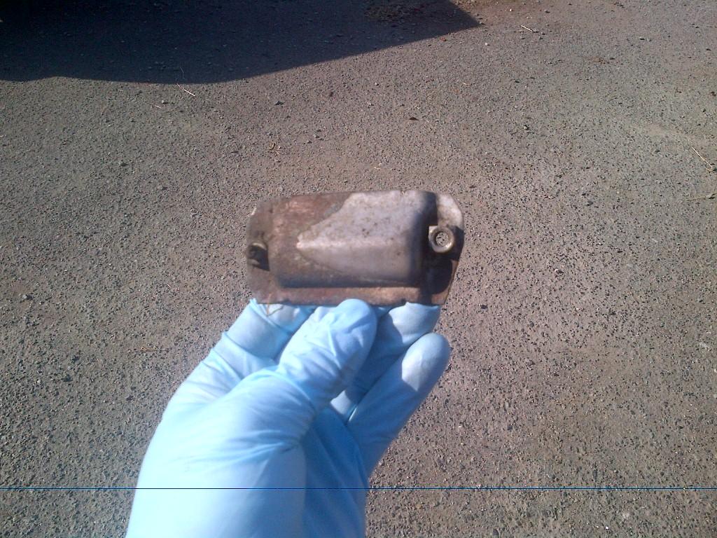

Expensive, but I prefer it over POR Metal Ready and rust-mort, which are similar products that serve a similar puprose. Main reasons I like Picklex are that you don't have to rinse it off with water so you don't add more moisture to your work area, procedure takes less steps, and I use way less of it. It also removes any light oil left on the work area.
Its helpful to work it in with a green scrub pad once its sprayed on.
I've read on other forums that epoxy primer is fine over Picklex as long as primer doesn't have any added etching properties. Self etch primer is not compatible.
I spray with picklex right after sandblasting anything, I did two bumpers two months ago, one looks fine, the other has a few new rust blemishes, so they needed a respray to convert, probably started in deeper pits.

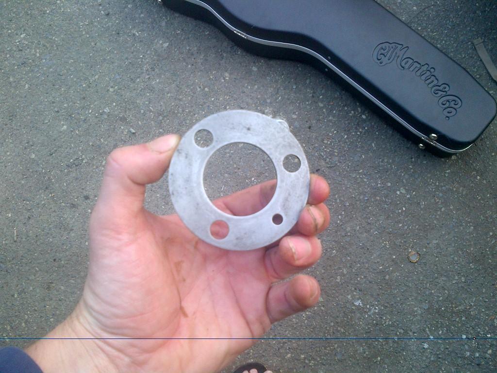

Picklex good for parts clean up too, here is piece I soaked with picklex and used green scrub pad on, still looks like fresh metal 6 months later.
All the phosphoric acid products will dissolve rust if you leave them for a period of time (and the metal eventually as I found out), this is Picklex.
Just for the heck of it, here's Por Metal Ready on left, Rust-Mort on right, 2-3 applications. I think the Rust Mort does a better jobf.

Oh- and whatdoesthisbuttondo- Please tell me you don't combine Martin playing and parts cleaning activities. Laughing

Lil' Lulu- Haha, Martin and Picklex definitely not compatible! I try and keep the hobbies separate Smile
