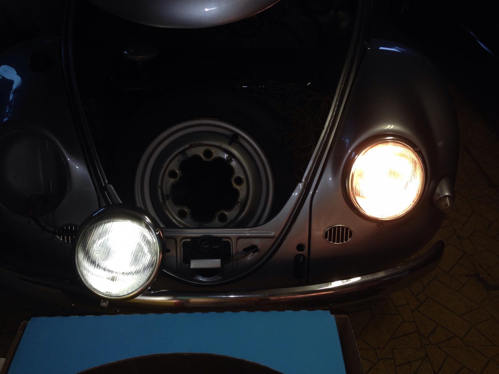

I recently purchsased some LED bulbs on ebay and swapped out my sealed beams. when i installed the bulbs, they would only light up when i hit the high beams.
Has anyone ever successfully installed these? FWIW, I'm 12 volt, running the stock harness and 4-fuse block.
Thanks!

PostPosted: Wed Jun 24, 2015 8:29 pm    Post subject: Reply with quote
I tend to agree. I didnt want to try the ones with ballasts. I've seen a bug once with ballasts and HIDs. Let's just say it's no bueno. The light dispersement was all over the place.
These ones looked ok but was more 6000k and didnt look like they would put much light to the ground.

PostPosted: Wed Jun 24, 2015 9:13 pm    Post subject: Reply with quote
Good comparison shot of the color of the light output. The 6000k is too new car looking for me. A while back I bought a set of the LED speedometer and gauge lights and the color was two blue on those for me as well. I ended up giving them to a friend who had a newer beetle and was going for a more updated look.
Hopefully in a few years there will more options for us.
