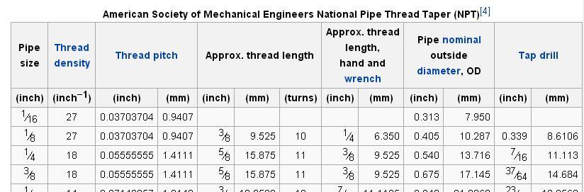

Finally verified the thread for the master cylinders. It is 1/8th NPT. I have no idea why Latest Rage doesn't put that in the description for the actual assembly. They have the info on the page for the cylinder itself.
So I need to order a 1/8th NPT male to 3/8th-24 female fitting with the proper flare, right?

I really doubt that the threads are 1/8 NPT. More then likely they are M10 x 1.0. Both of these threads are extremely close, and many people tend to confuse them. That is just like the VW seat belt bolts. Most companies will sell you a 7/16 bolt, when they are really a M11.
Information is limited on their products. I would think those details are important. I found a replacement master cylinder online (can't find it now) that says 1/8th NPT. I took the fitting from my CNC clutch slave and it fits perfectly so I'll take that to NAPA when I buy the fittings I need.

The threads ARE NOT NPT! They are M10 metric thread. You can buy an adapter for a few bucks from any decent auto parts store to adapt them to standard american or metric brake line.
That being said, you can force a 1/8 NPT to thread in an M10 and the soft aluminum and brass will somewhat conform and give you something that feels like a good joint. It may even work ok, but its still the wrong way to do it.
