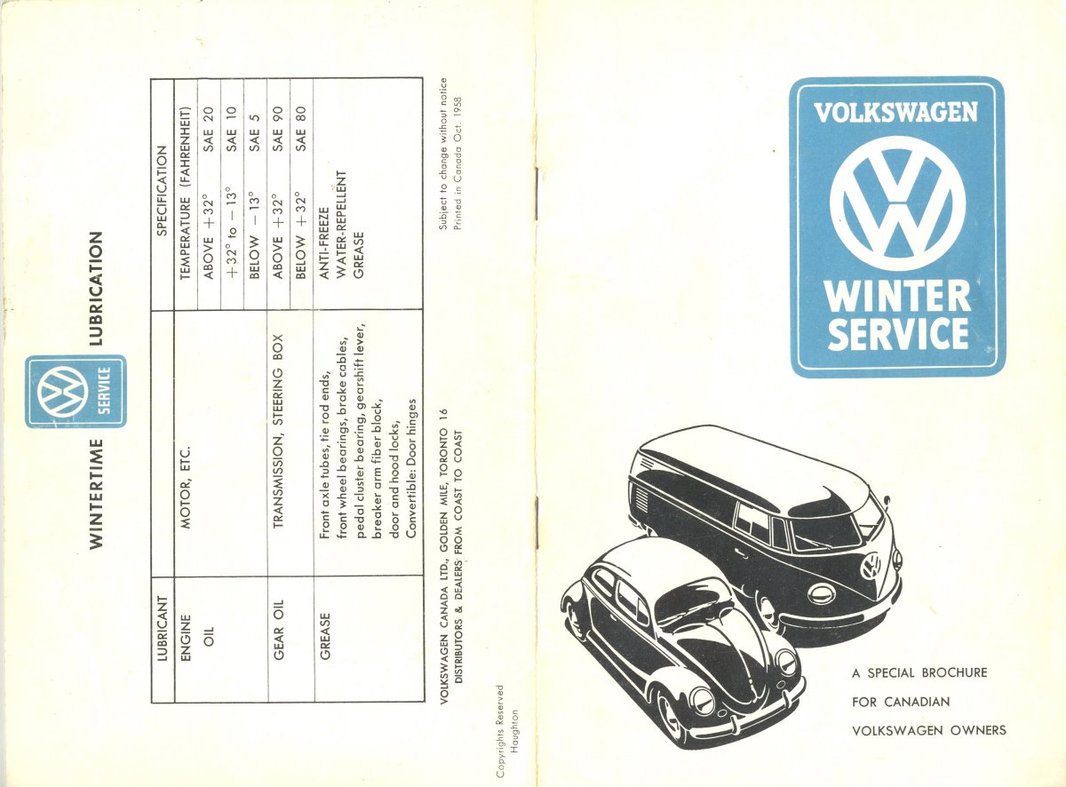

http://www.thesamba.com/vw/archives/lit/10_58_winter_service_canada/1.jpg

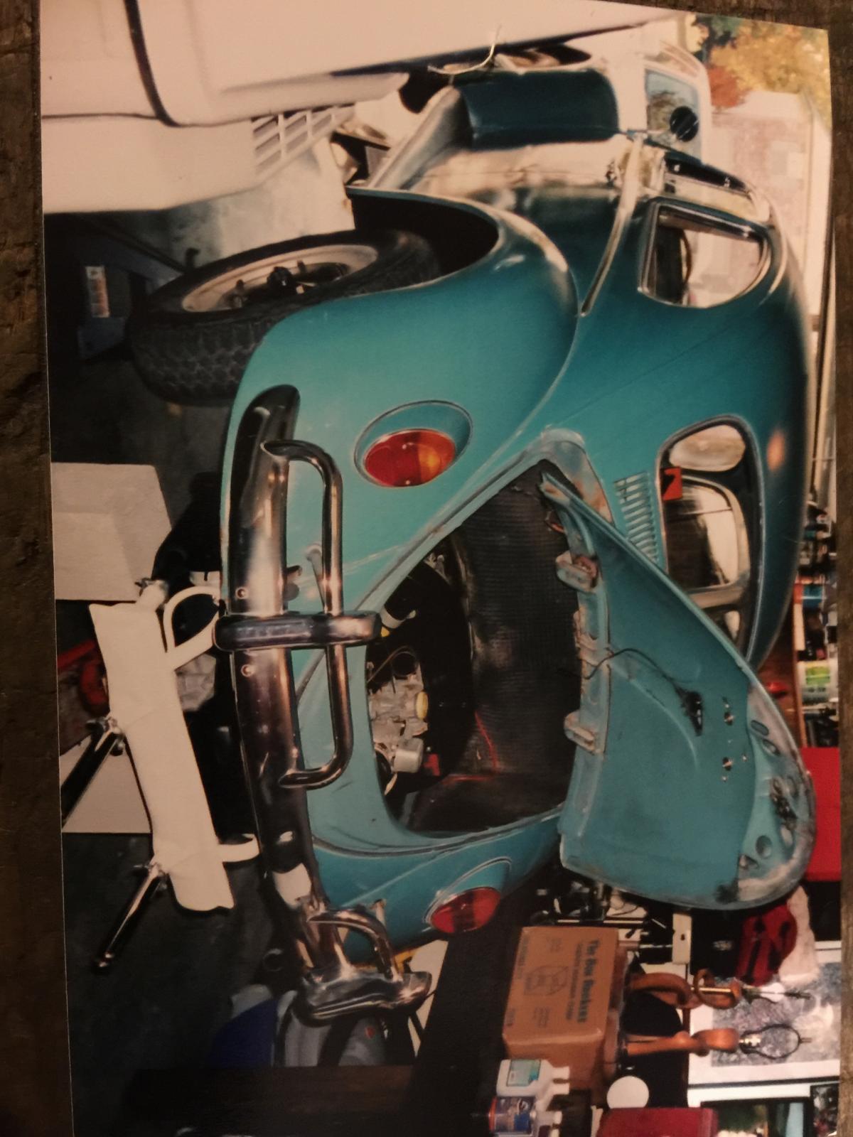

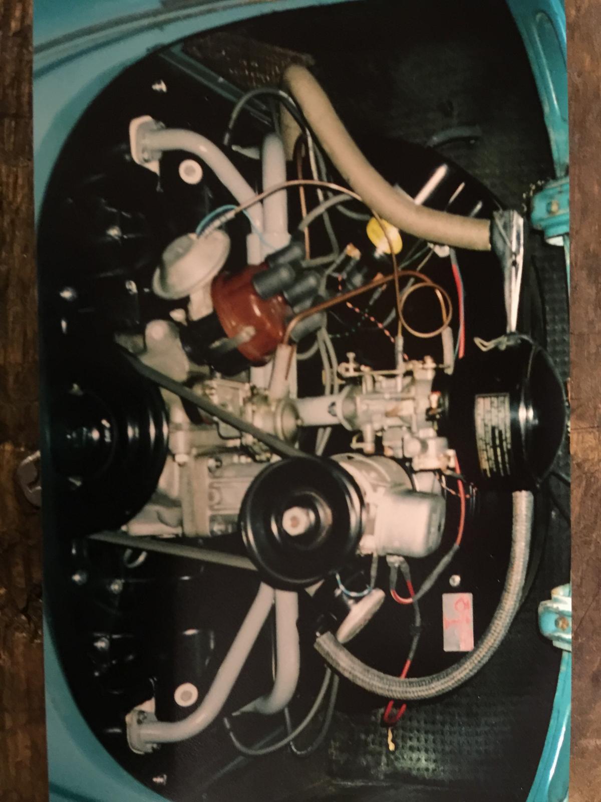

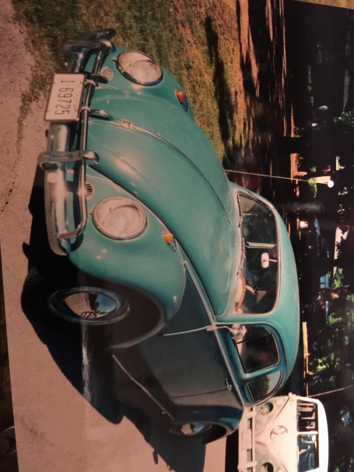

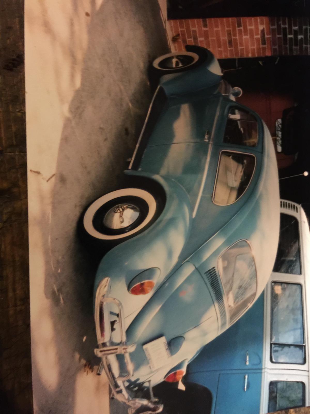

Yes it looks like they were trying to keep that carb heat. Carburetor preheat and icing is a problem even down here in Oklahoma if conditions are just right with humidity. I could just kick myself in the ass for selling this 62 way to cheap to a sambanista about 7 years ago he lives in Edmond.

Zundfolge1432, I want to get a bone stock bug (like the one in your pictures) and fix it up to make it a daily. That car is sold so what's done is done! Meanwhile my car still has a leaky engine Wink
