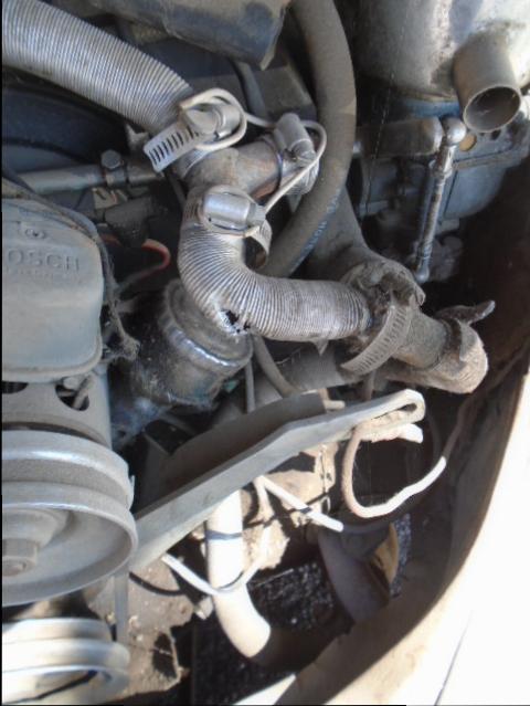

Modified German crank pulley. Appears to be a smaller diameter double 'power pulley'? Maybe to attach to that generator stand bracket? For A/C or Super Charger?
Temp sensor on dip stick tube? Dip stick on oil filter? Strange oil pressure sending unit?

I'm wondering what double pulley was for too, it does look like something might have been mounted off to the right on that bracket.
Is the smaller hose a pre-heat for the dual air cleaners or ?
Was the right side heater hose hooked up too and is just missing now or ?

The crank pulley is strange and looks to be a manufactured piece (not home-made), as does the generator bracket. It originally drove a secondary generator that I believe was 12V. The car originally had some electronics in it. There are two large radio and/or CB brackets under the dash, a CB antenna on the back bumper and a roof mounted antenna.

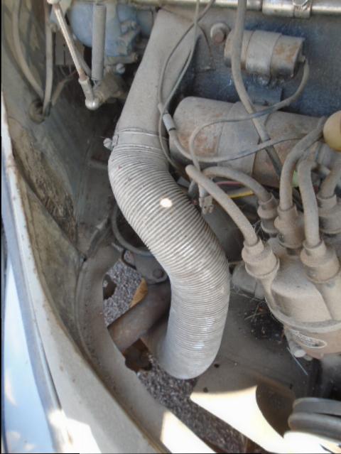

The "pre-heater" is strange and looks to have been put on after the fact. It's interesting to note that the shrouds to the air cleaners are chromed, as are a lot of other parts on the motor. The engine does have the copper, coiled cooler at the fan shroud intake, though I don't see how it would help to pre-heat the carbs.
Left side is pretty standard:
The right side is pretty wacky. Air is taken from the outlet on the fan shroud, then T's. One side goes down to the heater box and the other T's again to hoses which feed the air cleaners. These were clearly not factory made, though I wonder if they accomplish anything?

I believe that these are Zenith's. Knecht air cleaners.
I assumed all Okrasa manifolds were aluminum?

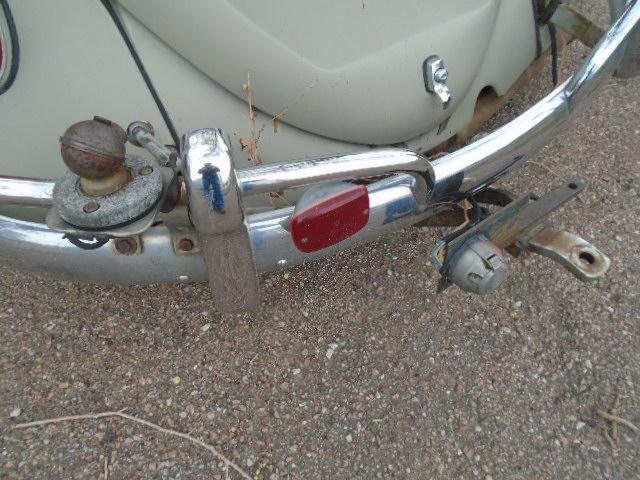

This has always been one of my favorite parts of the car, the oil cooler hanging under the front bumper.

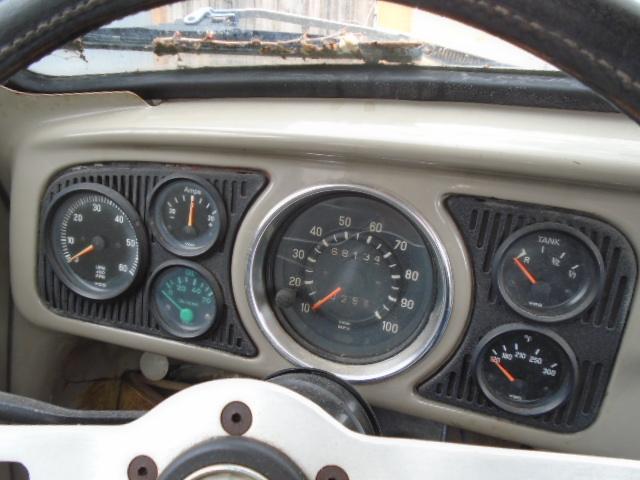

The modifications on the car don't stop at the engine:

Holy Moly, that is one complicated looking dash.
Oil cooler up front is pretty neat indeed.

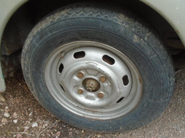

Is the body on a later IRS chassis, due to the 4-lug wheels and the wider rear track? If you find the chassis# stamped into the pan under the rear seat, you'd know right away.

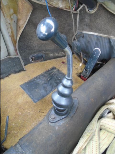

Bent-back shifter with Porsche-style knob!

The chassis is still a swingaxle. The reason you note the wide-track is likely because of the addition of wheel spacers in the back. There is really no part of the car which has gone un-touched. Everything was modified in a somewhat cohesive fashion. I'm curious if Oettinger performed brake upgrades as well? I did read something about brakes in the Okrasa info posted above, but my German is pretty limited.

The shifter is an aftermarket accessory from the period. This one is original to the car. I actually have one that was originally installed in my 70 Dormobile, which has a VW logo stamped into the coupler sleeve.

looks like early type 3 shifter to me ?

4-lug wheels would be correct for European 1967 beetle. It has euro tail lights too.

'67 euro Beetles did have 4-bolt wheels, but only if equipped with the strongest 1500cc engine so that disc brakes were included on the front axle. A 1500 engine would have an "H" letter code. 1300 and 1200 engined- '67 had 5-bolt wheels with 4-wheel drum brakes. Also, despite the sloping headlamps for Euro '67, those all did change over to the squared-off engine lid just like US models received. I have no doubt that this is a '66 body, and chassis with the OP's explanation as to the 4-bolt wheels. Surprised it does not have the hole in the dash for the emergency flasher knob, though possibly being a Euro model with the locking column ignition switch, the flasher knob was located in the lower ledge of the dash on either side of the ashtray.
The shifter was an EMPI accessory offering for Beetles, designed to look like a Porsche shifter and knob. I have one which I received from a friend who had it in his '62 Beetle in the late '60's.
