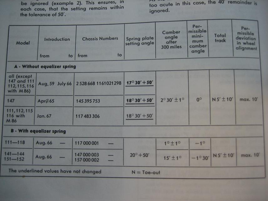

There is not a "Stock" inner spline .. only a stock plate angle..
To achieve the proper speing plate angle requires a series of inner and outer spline movements.
With a combination of spline changes as little 50' of a degree
Chart represents degree/angle change of the plate with splines changes indicated.
A 67 with the equalizer overload spring should have a stock rear spring plate angle setting of around 20 degrees.

^ Yes while that's the preferred controlled environment method.. it's not really necessary.
It does not have to be level, but you must use a body/chassis fore/aft zero starting point of reference.
I place the rear up on jack stands at the torsion tubes and go to work..
I've always used the rocker panel (flat door opening surface above the running boards) as my zero ref per side..
Measure and make that ZERO for the side Im currently working on..
Measure where the spring plate angle is currently set.. per side and adjust accordingly..
Take and make notes to keep up with what I've moved..
Works perfect for me every time.
