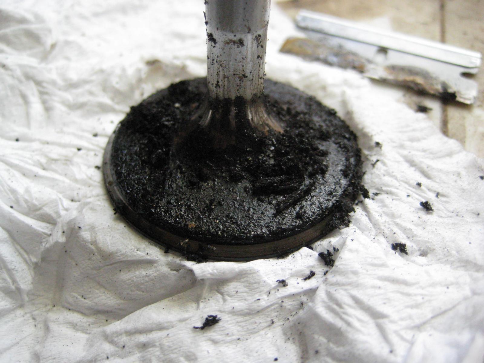

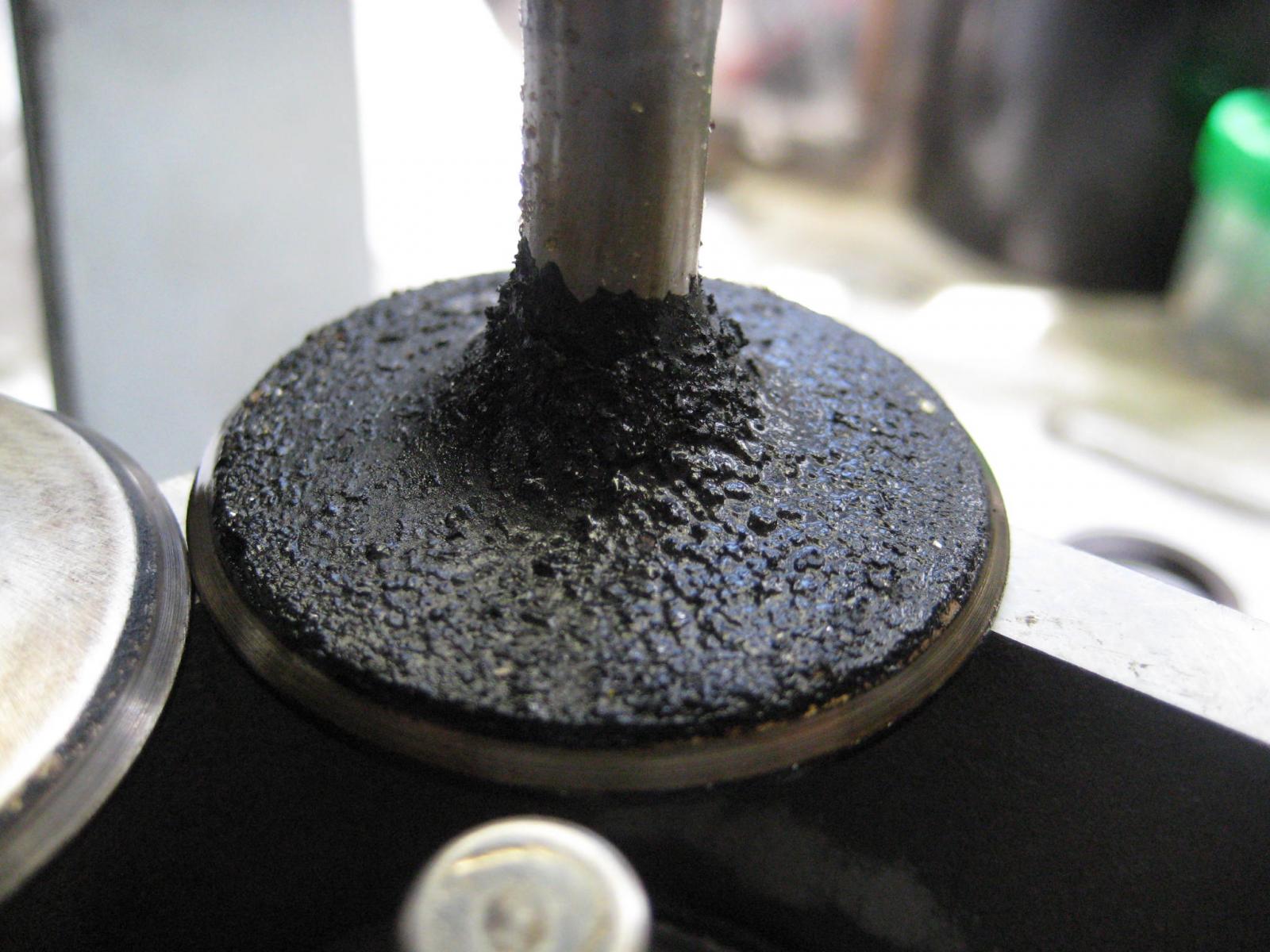

how did this happen
intakes--before and after
closeup
working on it
thats a lot of carbon!
any ideas?
i was rich on idle jets(55 going to 50)
low compression 7.0(going to 9.0)
was the valve glowing hot sizziling the gas(cooking on valve)?
cheap gas(i do run premiun)
oil coming down valve stem?

PostPosted: Thu Aug 18, 2016 12:05 am    Post subject: Re: carbon build-up on intake valve Reply with quote
Most of the intake valve currently existing are like that more or less.
How does it happen? chemistry? heat? I think the fuel hits the valve and makes it sticky, then the small puffs of carbon which blow back tend to stick to it and build up.
They have a little display at the shell gas station with a carbony valve and a clean one and it says our gas "reduces deposits 35%" or something, and I thought that was rather funny, because the 'bad" valve in the display was rather typical, no worse than most. I considered getting them a better example, perhaps a detroit diesel, looks like a soot popsicle Laughing
Looks kinda fluffy like the deposits in a smoker I was fixing a few weeks ago. mmm, pork carbon. Not only does it make good flux for shielding the back of the weld, but it also delicious flavor too. when they run bio diesel sometimes it imparts a bit of flavor.
Well, if the chambers were extra fluffy too, then we'll blame that for the 30% beyond normal buildup. Running rich will make a lot more carbon, and you could blame the gas also, they are supposed to have some additives in there to minimize the buildup, and certainly not all is created equal. Some OE cars had problems, when the deposits get out of hand it was found they can act as sponges and delay fuel delivery. We've come a long way from when you had to take apart your model T engine and scrape the gunk out of it every 1000 miles!

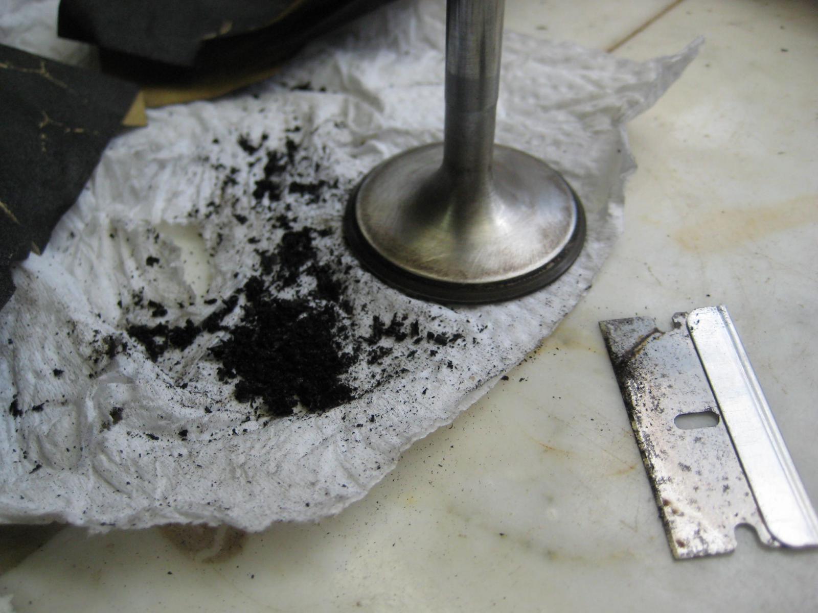

vw moses
Joined: April 17, 2012
Posts: 213
Location: independance,louisiana
vw moses is offline
PostPosted: Thu Aug 18, 2016 10:28 pm    Post subject: Re: carbon build-up on intake valve Reply with quote
the pic of the dirty valve--should of noted--i had it soaking in acetone and just took it out.
you can see small droplets on stem and makes it look shiny.(eco. friendly junk)
the carbon would only come off manuelly( razor & fine sandpaper)
i have been doing most my driving on low to moderate rpm's running on my overly rich(for my mtr.) 55 idles (duel 40mm carbs.)for a while.
the doc. says go 50's and that's what i got in em now.
thanks for the input.
with a fresh start, and proper combo's (compression & jetting)
this baby should rock when i want it to! Cool
