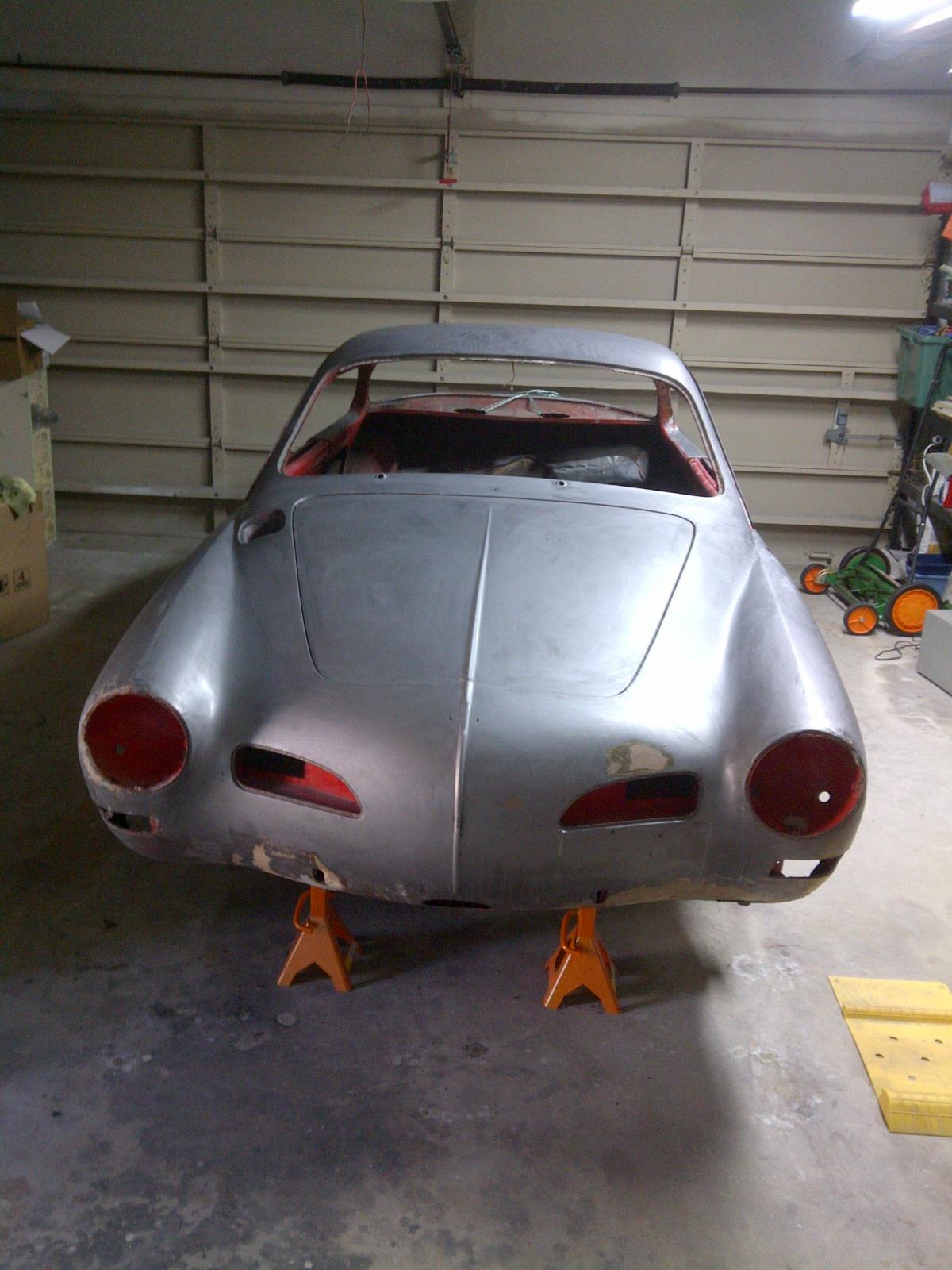

I started with the aircraft paint remover and finished the bondo areas with a brass wire wheel. After I got it all down to bare metal I used spray on rust inhibitor while I waited to get it down to the paint booth. The seams are sealed with what looks like lead and no matter how slow you go with an angle grinder it will eat through it like butter...

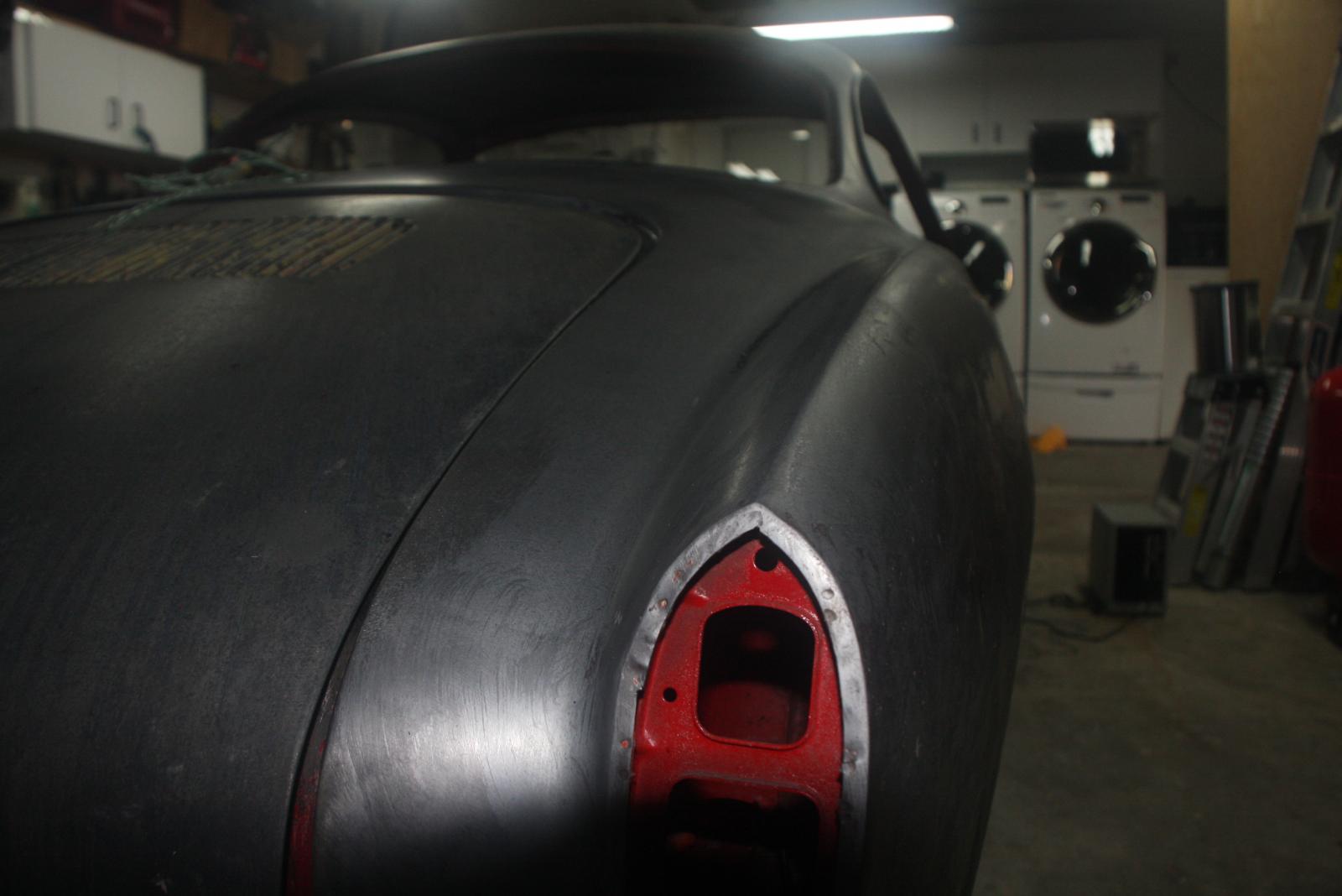

I used this harbor freight wheel on a grinder to remove 3 layers of paint and 1/4 inch of Bondo worked fantastic.
http://www.harborfreight.com/4-12-in-polycarbide-abrasive-wheel-60571.html
I did try aircraft paint remover, no thanks
A heat gun and a scrapper worked well in smaller areas.

Jesse,
Brass wire wheel? Are you using a wire cup wheel? What is it attached to? Angle grinder?
As I continue to experiment, i used a wire wheel attached to my drill. Might be good for small hard to reach places, but worthless for large areas.
Your car looks great. I spent a couple hours on a door and I barely have any actual metal shining through so far.

Sofia74 wrote:
Jesse,
Matt
I used a combination of cup and flat depending on the contour of where I was working on the bondo areas, the rest I went through about three coats of gel paint remover and a plastic putty knife. The wire wheel cuts through the bondo (use a respirator) pretty easy but since its softer than the steel body it is pretty harmless. I used the wire wheels on a standard variable speed drill. When I was finished I used a spray on rust inhibitor and the body sat for a couple of months in 60%/80% humidity without a spec of rust until I got it to the booth and it got a coat of primer.
