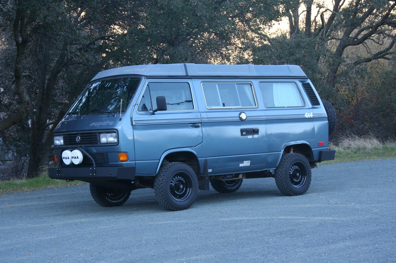

I have an '87 Syncro that I will soon be taking to the snow for the first time to test out the new Propex heater! I have a moderate amount of experience in the snow for a Californian, including with my '64 Beetle and with two different 4Runners.
My Syncro has a locking rear diff and a decoupler and 15" wheels with BFG AT 215/75-15 tires. How are they in the snow? It's been getting above freezing everyday up there, so I'll be watching for ice at night.

My 2WD with 195-14s has moderate snow ability. But, its all in how you drive it. I can get through stuff there is no way my kid can. I admit, she knows only tentatively that the 2WD is really only a 1WD if you spin the other.
From other mentions on this forum, tho, I see many mentions that the BFG ATs are mediocre at best, by opinions I respect.
With that Syncro setup, I am guessing the tires you have will be just fine tho.
