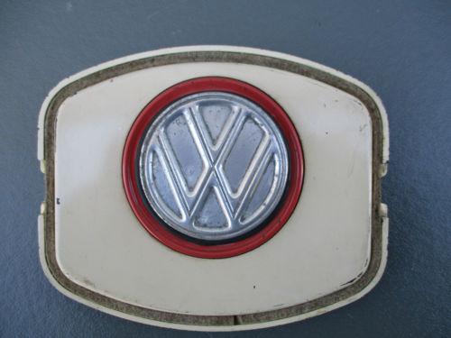

Do all of you have any clues to explain why this VW logo on the barndoor deluxe pod is different? The usual VW logo should have a space between "V" & "W" but this one has on space between them. Is this a variation in the whole production period from 1951-1955? Kindly shed new light on it. Many thanks, Max Rolling Eyes

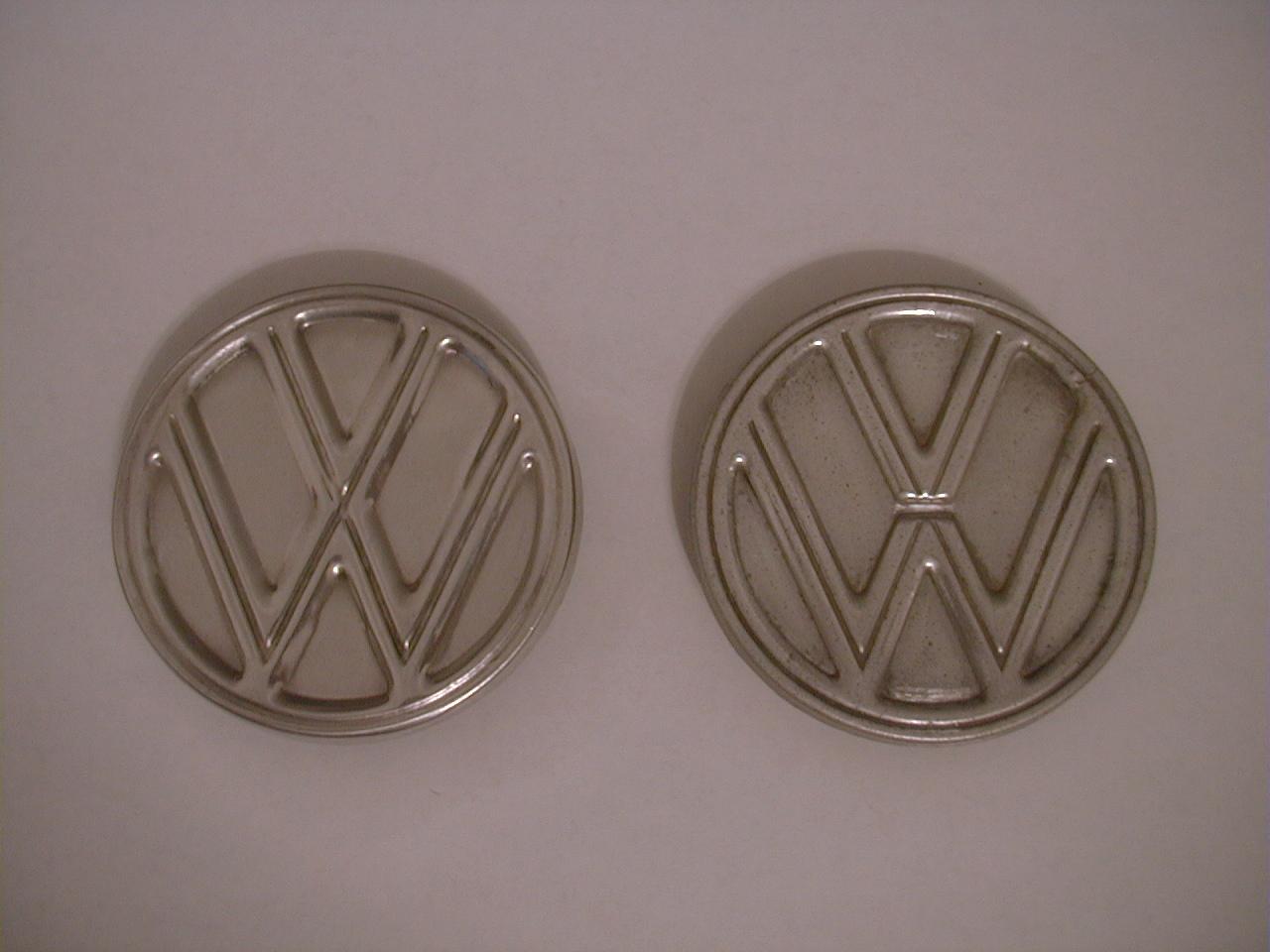

PostPosted: Mon Mar 06, 2017 1:12 pm    Post subject: Re: Barndoor VW logo pod Reply with quote
Yes, it looks like there was an early (51-52) and a late version (53-55) badge.
Early version badge, as above, has no gap.
Late version has the gap.
The extremely original Hornbecker Deluxe (Jan 52) has the no-gap badge.
I have seen a picture of an original 51 with a no-gap badge too.
Change looks like it happened in later 1952.

PostPosted: Tue Mar 07, 2017 10:42 am    Post subject: Re: Barndoor VW logo pod Reply with quote
Brian_Mccue wrote:
Are they the same as early beetle hood emblems
Yes
These two badges were also discussed on the bd forum here:
http://www.thesamba.com/vw/forum/viewtopic.php?t=256430&start=260
Related threads on the split beetle forum:
http://www.thesamba.com/vw/forum/viewtopic.php?t=495834
http://www.thesamba.com/vw/forum/viewtopic.php?t=149768
http://www.thesamba.com/vw/forum/viewtopic.php?t=132574

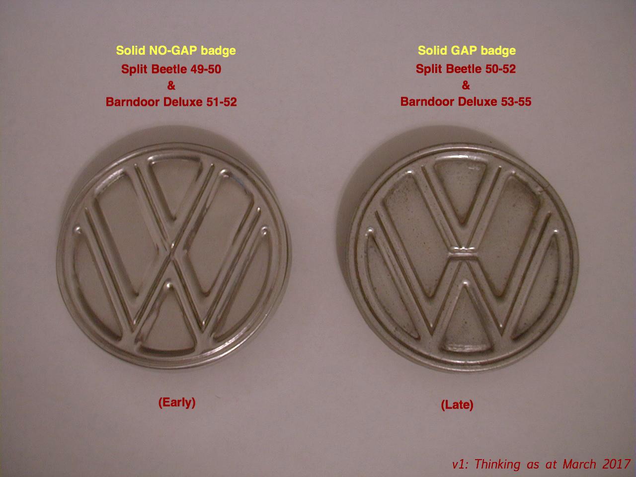

There is debate regarding when the no-gap badge was replaced by the gap badge on the split beetle.
Pictorial summary v1:
-StockRocks-

As for the whole vw badge pod, am i correct to say it must be come from barndoor deluxe bus; as i've never seen this logo pod on any split beetles. Kindly correct me if I am wrong. Idea

PostPosted: Thu Mar 09, 2017 1:28 am    Post subject: Re: Barndoor VW logo pod Reply with quote
max cheuk wrote:
Am i correct to say it must be come from barndoor deluxe bus; as i've never seen this logo pod on any split beetles
I'd say the indications are that it is from a Barndoor Deluxe, unless anyone can tell me different.
I think the badge base is unique to barndoor deluxe (or any barndoor fitted with the dash as an optional extra).
The badge base being sealing wax red is another clue.
The badge (and probably the ivory pod surround?) is probably shared with split beetle.

PostPosted: Thu Mar 09, 2017 11:48 pm    Post subject: Re: Barndoor VW logo pod Reply with quote
The pod and the location of the mounting tabs is different to split being at 10 & 5 o'clock locations..so I think Barndoor specific?
The central VW logo is a carry over from Split Beetle and I think 51 Deluxe used the no gap emblem and all other years used the gapped version.
Something is up with the one above though as it should be solid under the Emblem and has three holes to allow the tabs from the Emblem to fit through and bent over.
The one in the pic looks as though the middle has been cut out and that mounting bracket certainly not original.
In my adds you will see better pics of what they should look like..copied from an original.

PostPosted: Fri Mar 10, 2017 1:16 am    Post subject: Re: Barndoor VW logo pod Reply with quote
Still got just the one left?
I'm thinking the badge tabs have broken off, so they have devised another method of attaching the badge - by cutting a hole in the badge base, fitting studs to the badge, and then adding that crossbar.
Who makes, or has a nice solid gap emblem for a '54?
