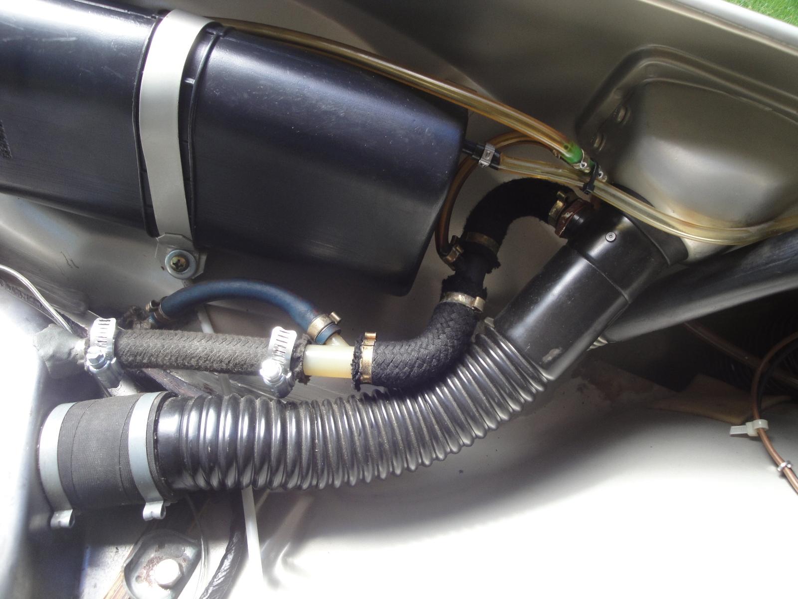

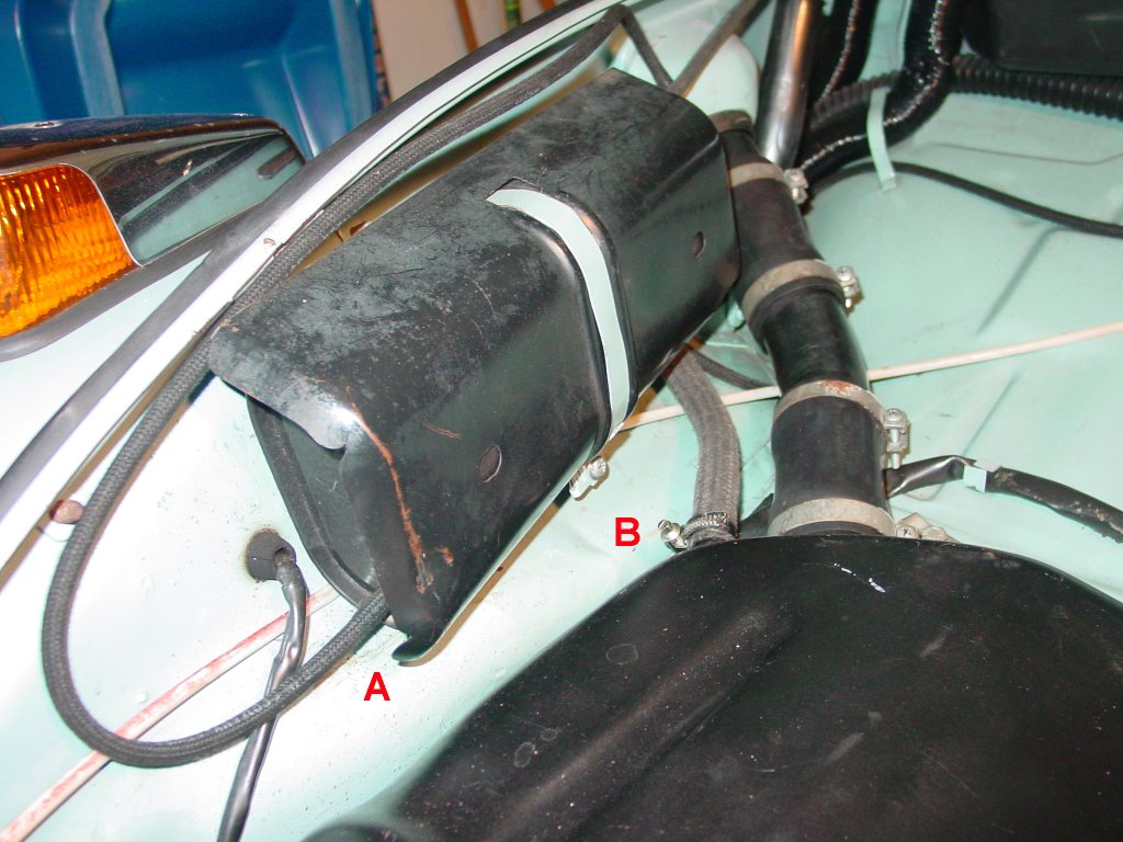

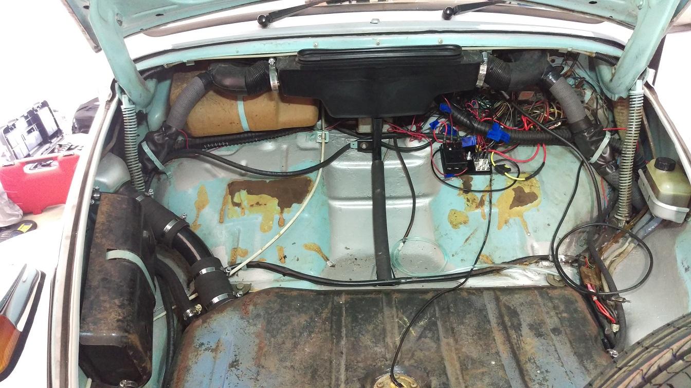

Let's begin. Starting from inside the trunk:

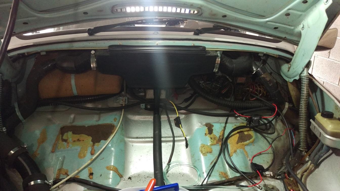

Here's two pictures to see overall how the EVAP lines run within the trunk
mnussbau wrote:
74volks wrote:
I'm looking for good photos of each & every connection that is made on the fuel system inside the trunk, from the filler neck to the expansion chamber to all connections on the fuel tank itself (top side only).
I've been looking for the same thing myself so I can restore it to stock. It's difficult as many people don't bother, but I think I've got it right. But I'm not 100% certain. Also, I'm pretty sure there's a mix of fuel and vacuum lines running about...fuel lines on the expansion chamber and gas tank, vacuum lines elsewhere.
****All rubber EVAP hoses in the trunk should be 5mm (3/16")****

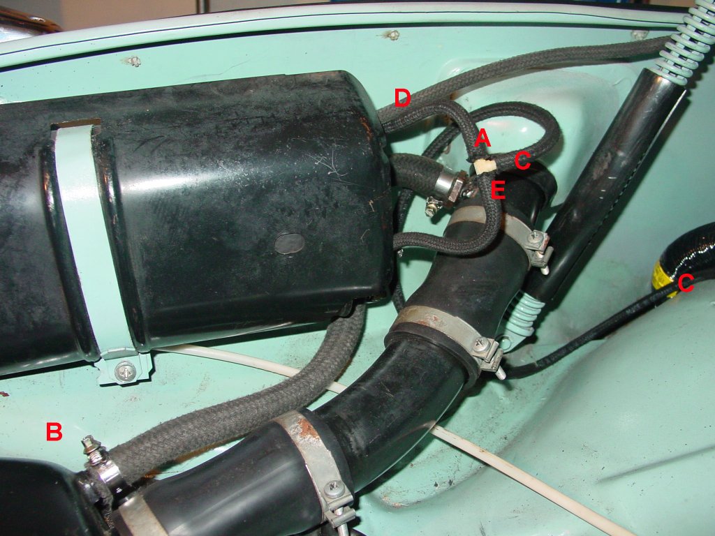

I labeled each hose the same on both ends...A runs to A, etc.
Here's the front of the steel expansion chamber.
'A' runs to a 3-way Tee, each end of the Tee is the same size(5mm). 'D' comes out of the top of the canister.
*****Hose "B" (measures 15mm (9/16") I.D.) and Hose "B- elbow" (towards fender) is also 15mm ID****
This shot has a lot of connections...at right you can see where 'B' comes out of the tank, to a Tee under the canister. That Tee is a hard part to find, the "top" of the Tee is large diameter (I think 14mm, whatever that hose is from the tank) while the "vertical" part of the T is vacuum line. I bought a universal-type Tee at Advance Auto, and IIRC I had to add a rubber shim over the fat parts of the Tee to make it fat enough. Then I cranked down on the clamps to make a snug leak-free fit. Something like this...

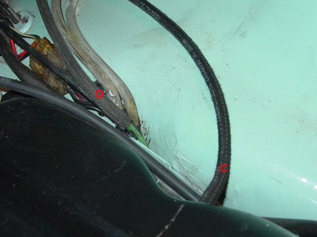

Finally, 'C' connects to a nipple on the left side of the gas tank, while 'D' connects to a plastic line that takes a dive under the body, to the right side of the car, then back under the running board to the charcoal canister above the back right wheel. Hope this helps!

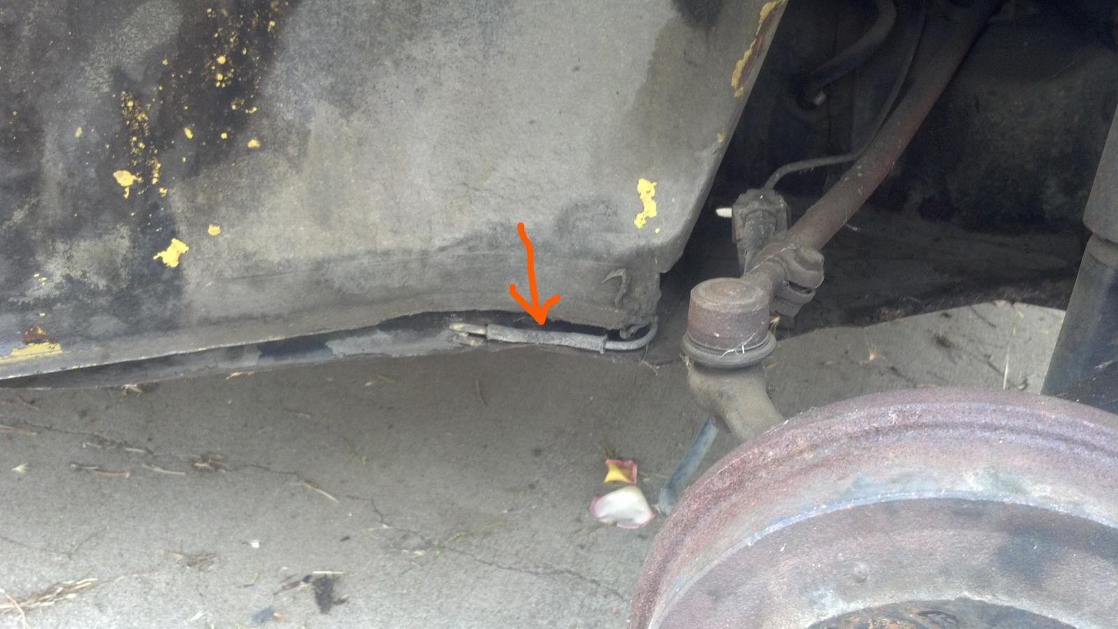

****There is typically a rubber hose 'connector' between the front firewall line (above) and the floor pan line (below)****
EVAP line running in 'channel' of right side floor pan. (It jumps front the 'rounding the corner' position through a small cut out in the flange of the pan in OEM style pans to the inner 'channel' (this cut out can be seen in the "Rounding the corner-example #1 picture above). If you have an aftermarket pan, you may not have this cutout- you can choose to make one or simply run the hardline in the outer 'channel'- EVAP line is silver (black line is return line for fuel injection)
(Front corner of right rear wheel well-) 'connector' rubber hose (5mm) at rear end of floor pan hard line from underneath connects here to a hard line which 'arcs' or 'hoops' up around the wheel well, following the fender bolt holes. (This picture appears to have a black vapor line coming up from underneath and into the wheel well.

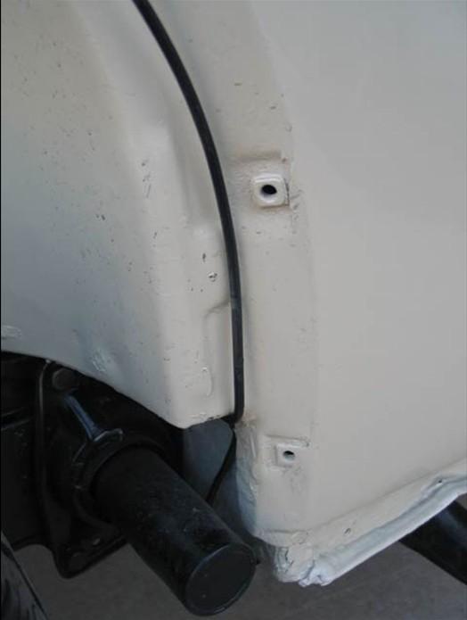

Here is a pic of the hardline which 'arcs' in the right rear wheel well. It is unattached in this picture, but the numbers indicate the location of the fender bolt holes. Note the metal bracket hanging on the line in the center of pic. These brackets are bolted up using the fender bolts to hold the line in place (probably only need 3 or 4 to hold the line.) Also can see in this picture how the hardline bends to come up into the wheel well and how the vapor line has a 5mm rubber connector to the small 'stub' on the bottom of the charcoal canister.

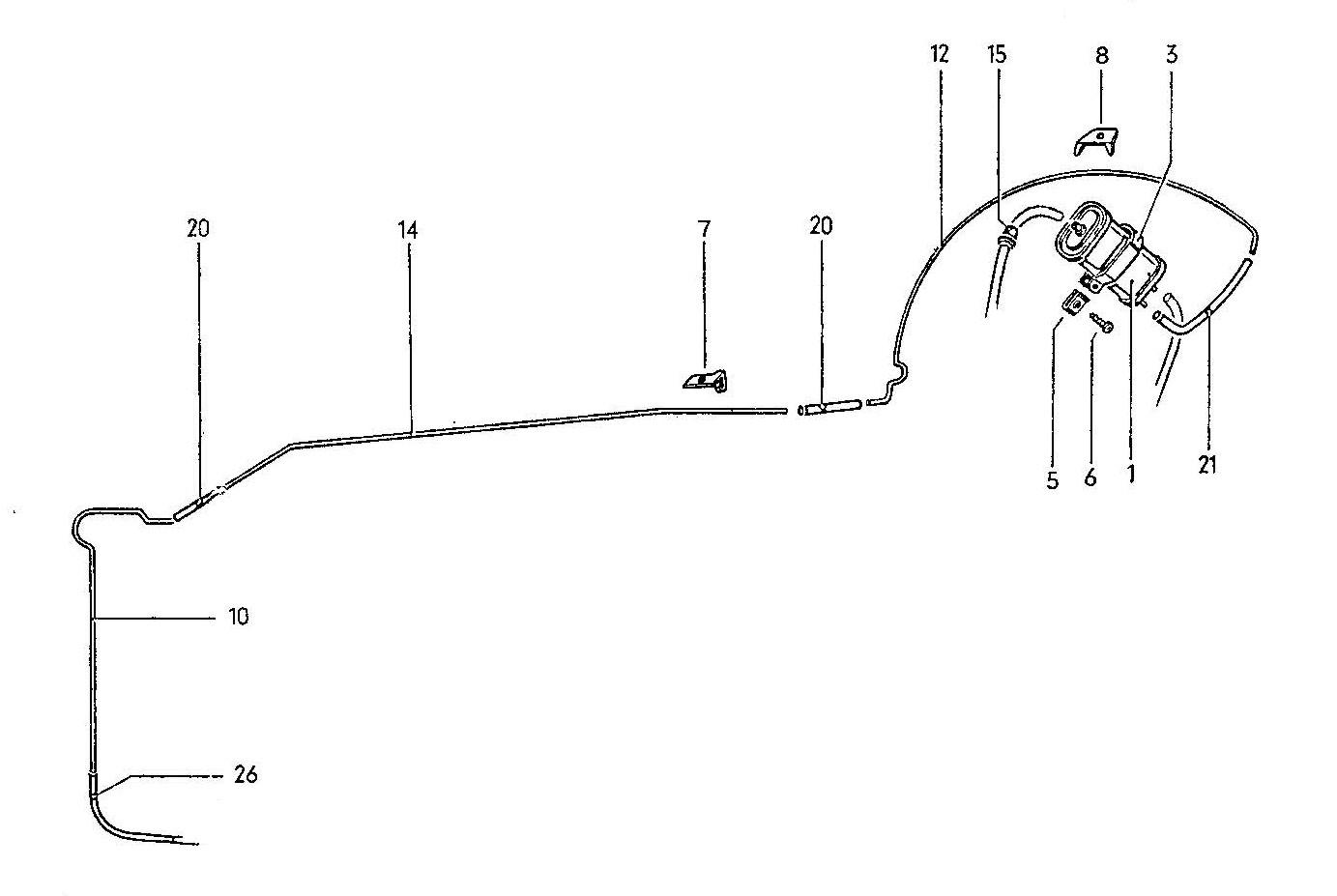

Here's some overall diagrams of the system:

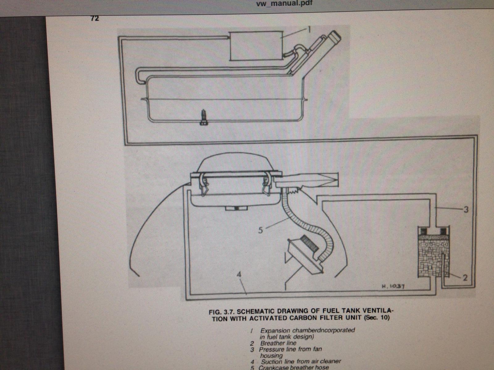

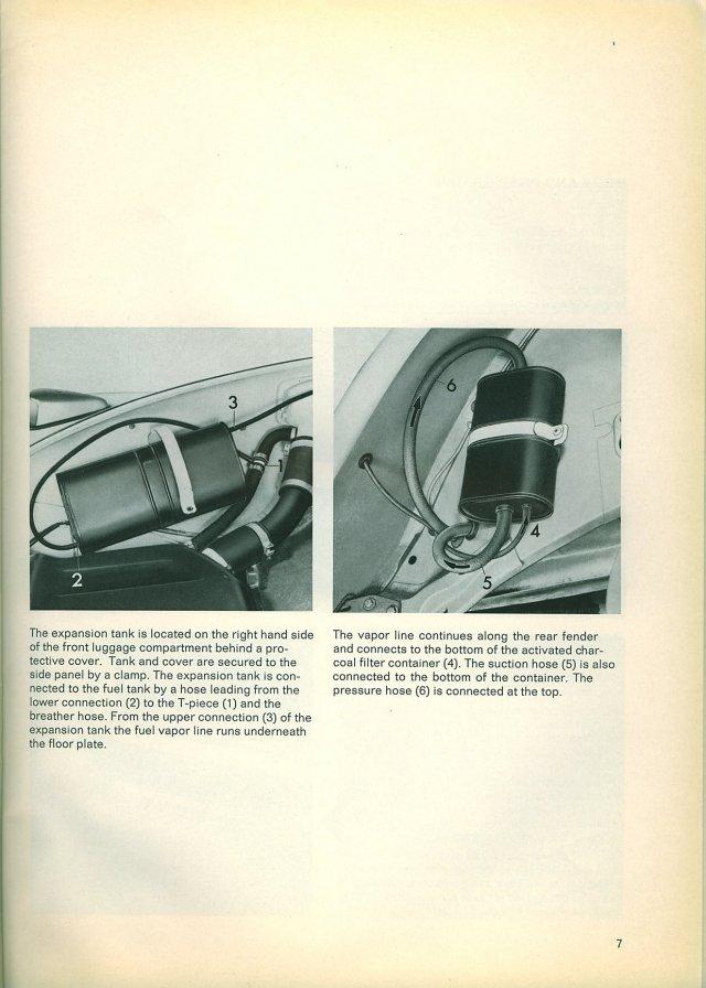

Tech manual pics/diagrams showing how the 'expansion chamber' is hooked up and mounted super beetles in the front trunk:

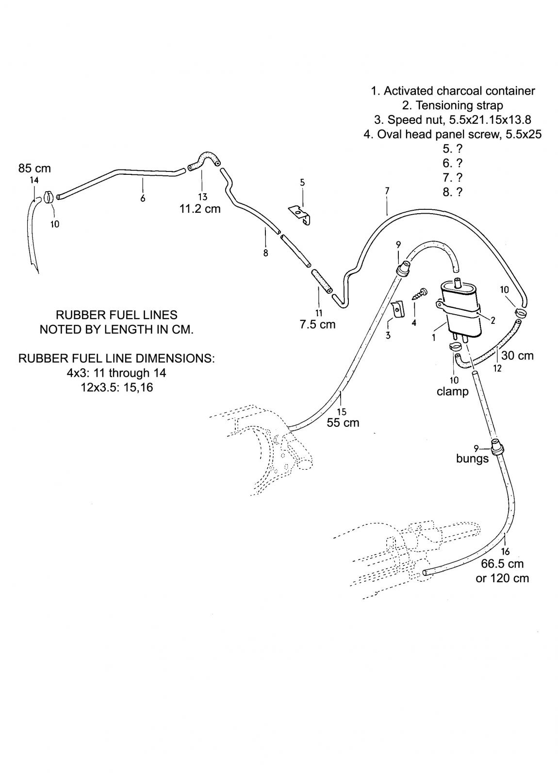

Diagrams of the entire EVAP system(showing standard beetle expansion chamber, both standard and super beetle systems are identical otherwise) :

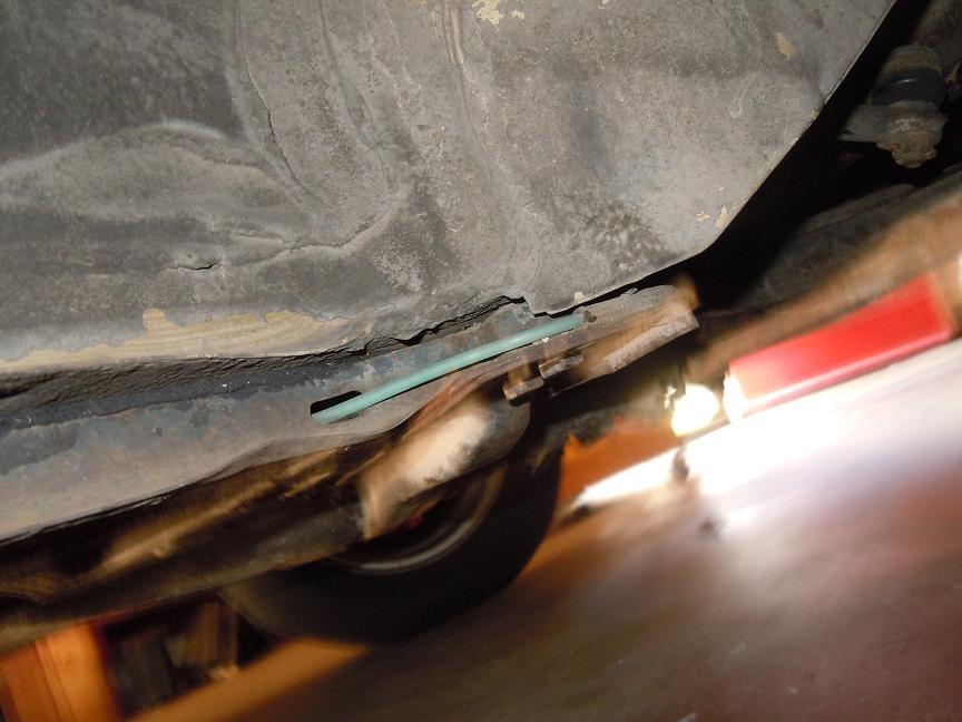

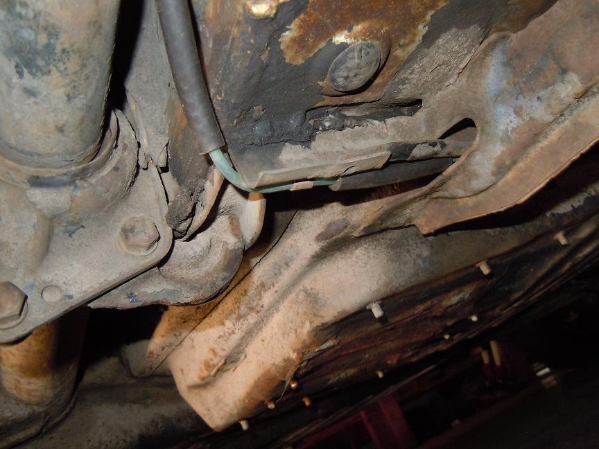

Line in the body pan clips underneath
Transition from line underneath in floor pan channel into the rear wheel well

From the archives/owners manuals. Looks like it connects to a port on the air cleaner assembly.
Though I can't easily find a photo of the hose port in question, sorry
thank you! That is the diagram I have been looking for. It's actually not very complicated just a pain when everything has been stripped out. I'll be working on this soon and can't wait to get rid of gas odor when the tank is more than half full. Wouldn't be so bad if gas still smelled like it did in the 70s but it's far different now

The tube fitting in the fan shroud could be a short piece of 1/2 inch galvanized electrical tube MIG welded to the shroud. Put the carb in a plastic bag sealed to the manifold before welding. You don't want to use a fan because it will blow away the gas required for the welding.
The grommets that you could use for the hoses to the canister and from the canister that pass through the right rear wheel well inside panel are the individual headlight wiring grommets used on the Super Beetles. With a bit of liquid soap they should allow a piece of 1/2 inch ID hose to pass through the grommets. If the hoses fit but you want to seal them put some black silicon sealant between the hose and the grommet.
For those of you wondering about the tube and hose lengths look at the pictures in the article. Some have the lengths shown. For those wondering about connecting the canister outlet to fuel injection setups, that is covered in at least one of the pictures here.
Very nicely organized. Some of the hard lines you could use you can find from Inline Tube in Michigan. Try the copper-nickel tube. It is easy to bend and it is strong enough for brake line pipes. It also comes in larger sizes like 1/4 inch and 3/8 inch. There are also some nylon/plastics used now for fuel lines in more modern cars that would be good candidates for the vent tubing along the chassis. Try Summit, Jegs or the outfit that sold the original Moon hubcaps. To bend into a permanent curve you apply heat. You can also get quick connect fittings for much of the plastic fuel compatible tube. The vent tubing in the trunk should meet the SAE specs for gasohol. It is likely the original tubing is not compatible with modern fuels. Some of the clear tubing originally used by VW was vinyl; not compatible with gasoline. There is clear tube that is compatible I just don't know what it is. You can see it on some new lawnmowers or lawn tractors.
