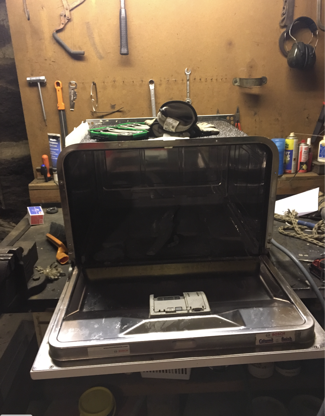

Some years ago I came across some people cleaning engine parts in a dishwasher. It's a great way to decrease components and make everything more fun. So today I decided to make it happen.
I sourced a Bosch table machine that I think would be great for me. They say bigger is better. But this one should be fine for me.
Looks like this:
Rebuild:

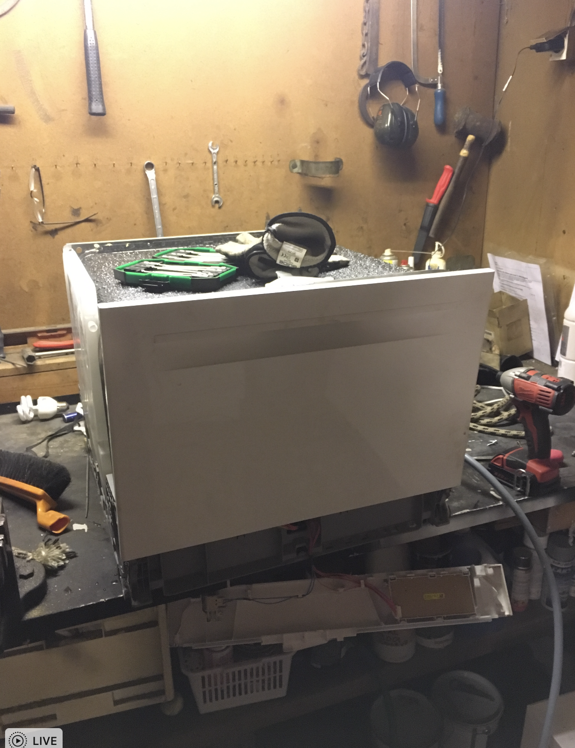

First I need to see it its runs and what's wrong. I found out the lid had a bad bushing so I guess that's the only problem and the owner didn't know how to fix it. I managed to source the component with a local dealer, Bosch prices it at 3 dollars. So I guess I might pay the double after his commission. I took two! Then my lid will be fine for a lifetime.

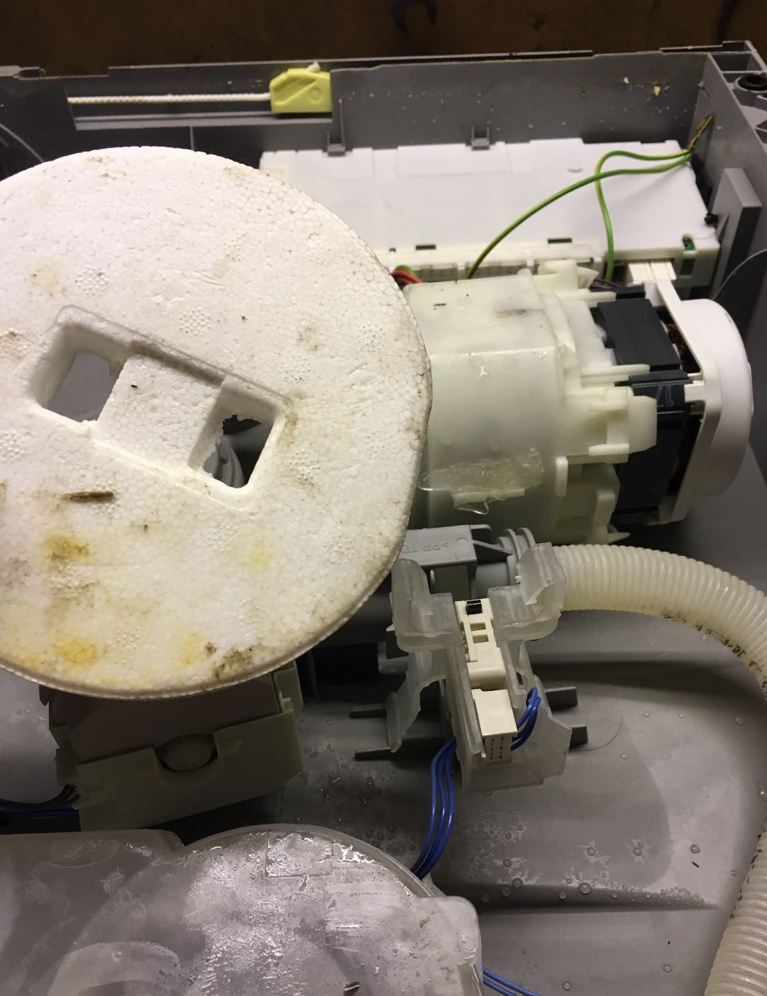

Took the machine apart to examine it. Removed the inlet valve, some wiring to the disposal pump (will use this one later) and located most components I need to be aware of. I will cycle the cleaning medium round in the machine so I can reuse it as many times as I want. So the outlet will direct go to the inlet again. Will see how the final plumbing will be later on. Also got some suggestions adding some extra filter to lower the wear and tear on the machine components. The disposal pump Ill connect on a button and use it to pump out the medium when I want to change it. Making it a simple process.
The machine will use an alkaline industrial cleaning fluid, the same one as you can use in an ultrasonic cleaner. I guess there are plenty of trading names. Pick one that does not foam!
Next weekend everything will be all set and installed. Cost so far only the "6" dollars for the components and some fluid, a bargain. Why haven't I done this before.. You should do it right away! Took me two hours including writing this. And probably another two before its done during the upcoming week.

Drain, two different vales. One to cycle, one for drain.
Broken hinge, probably the reason for scrapping it.
Inlet valve, removed.
Flooding sensors etc. Good to keep for safety.
Here I will reconnect the outlet to the inlet. Will have to run it a bit to see where the water will cycle before reconnecting things.
