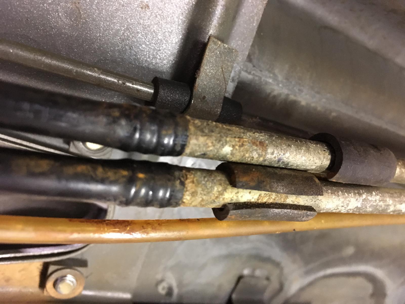

Since the center tunnel had exposed. I think it will best to replace all the cable and fuel line.
1. There is a plastic tube next to fuel line. No one seem have this replacement part. Can anyone tell me what is this, Can it be substitute ?
2. The PO convert this car to carb, technically I only need a low pressure fuel hose, but I think I will replace both line with high pressure hose. Just in case I convert it back to EFI. Any recommendation for the fuel hose ? Where to buy them.
3. The third question actually related to the 2nd. I am not sure what direction to take. Keep the Carb or go back to EFI. The problem with EFI is I might not able to get all parts now. I am thinking CB Performance fuel injection kit. I would very much appreciate for any comment on Cart Engine vs EFI. Maybe anyone have experience with the CB KIt.

For the fuel lines tangerine racing makes a replacement stainless steel kit that gets rid of the plastic fuel lines in the tunnel. Very good quality, I've got a set in my 2.0l D-jet 914. Should be super easy to install since you've got the tunnel cut open and can see what you're doing instead of trying to blindly guide them through there. http://www.tangerineracing.com/stainlessfuellines.htm

Anyway, could someone tell me what the yellowish plastic tube? Both side get broken. I just can't find the part for it.

the small plastic line is the expansion tank vent which originally on your car (must be a 74.5-76) connected to the charcoal canister now in the later cars, mounted in the engine compartment

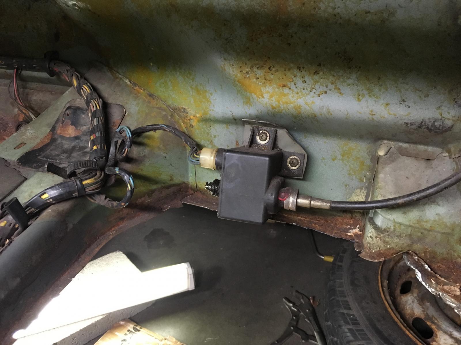

May I know what is part for ?
I know it connected to the speedometer but I can't find any information on this.

I may be totally wrong...but that looks like a catalytic converter light reset box.
Is this a California model? If so you may have other surprises in the engine. If its a 1.7L...DO NOT...DO NOT...build it back to CA spec unless you live there.
The 1.7L in California smog trim...was detuned and missing about 10-12 hp. It ran hot and was much harder to tune with D-jet injection than the other 49 states versions.
D-jet likes compression. The poor compression of the CA version made it hard to tune . Ray

To me, it looks like add on aftermarket cruise control - since it looks like speedo in and out cables. I've never seen cruise on a 914 though - nor that box.
You mentioned after-market AC was in the car. No 914 came from factory with AC, they were all port or dealer installed.

that is the EGR box, turns the dash light on after a certain number of miles to have you check the egr system. On all California 75 76 models
Thank you for the correction.....that is what I meant to say......not catalytic....but EGR.
For the curious.....the speedo cable turned the clockwork inside...X number of miles and the light on the dash goes on.
You were "supposed" to then go to the dealer to have the EGR valve inspected, cleaned or replaced.
These were the same part on virtually all cars. My 1982 Saab 900 had one.
In the last few years of its use....from my memory......it was used not just to signal for EGR inspection....but to signal for inspection of the evaporative control system, 02 sensor, amog pump etc. At least that is what some auto manutacturers did when your light went on and you brought it in.
In the early days of this....through say the mid 80s.....unknowing people would go in and pay for their mechanics to use their magic wand to turn out that damn annoying light!
Non mechanical people did not know about this box.....so did not know that it was a simple reset button......which can be seen right below the wiring loom in the picture.
In some cars it was hard to find and hard to get to. In my Saab.....it was just under the lower lip of the dash near the steering column if memory serves. Ray
