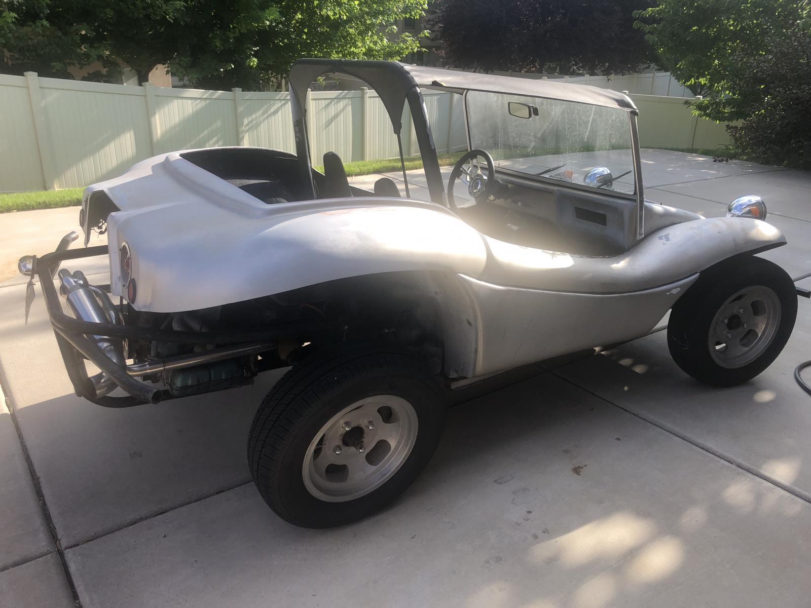

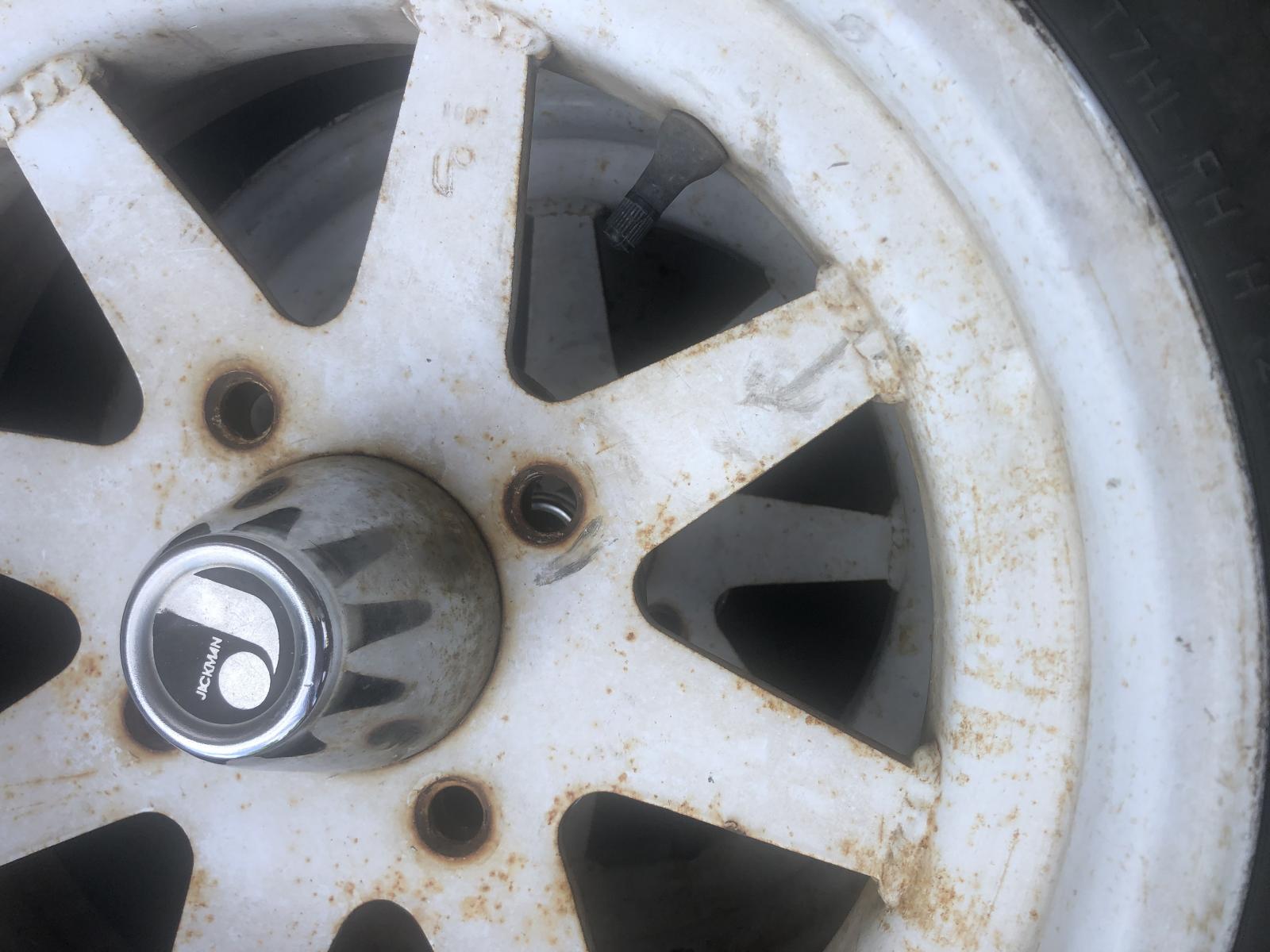

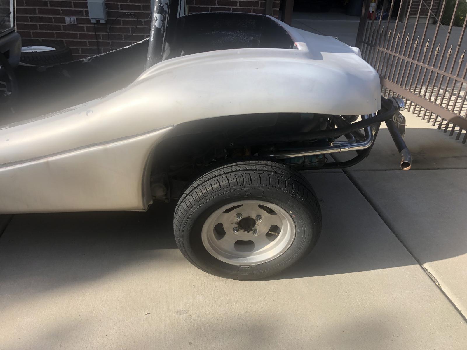

here are some pictures of the car and the wheels

As a clarification, i know the thread is 1/2 by 20
i am looking for the bolts that will have the same angle as what is cut into the Jackman Wheels. It looks like they countersunk the hole.
thanks

well any parts store should be able to sell you 1/2 - 20 lug nuts, but what ou have to determine is if they are tapered or ball seat

PostPosted: Sun Jul 14, 2019 6:20 pm    Post subject: Re: Jackman Wheel lug bolts Reply with quote
Thanks. It appears to be tapered. What i can't find is what the pitch of the taper would be.
