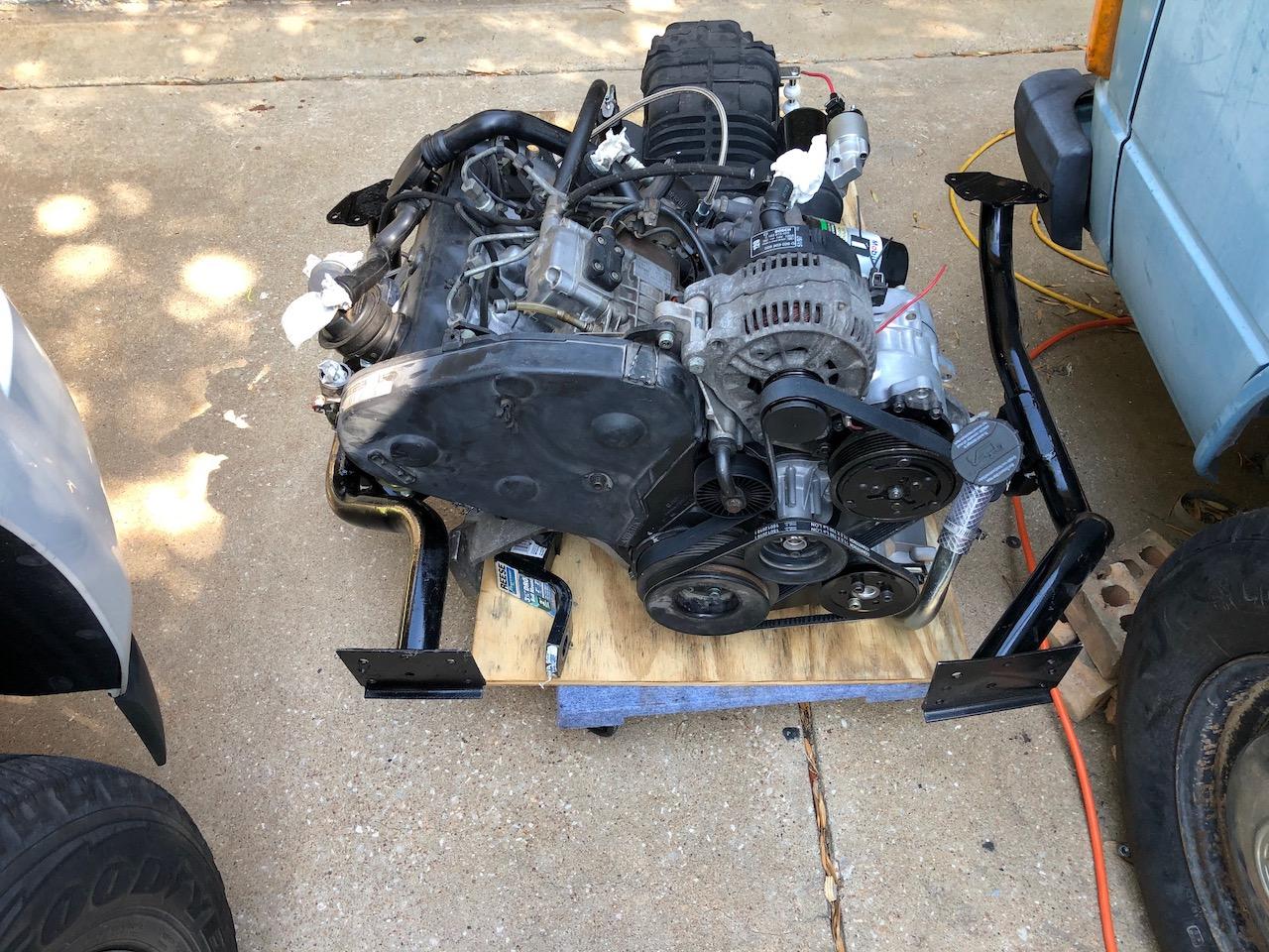

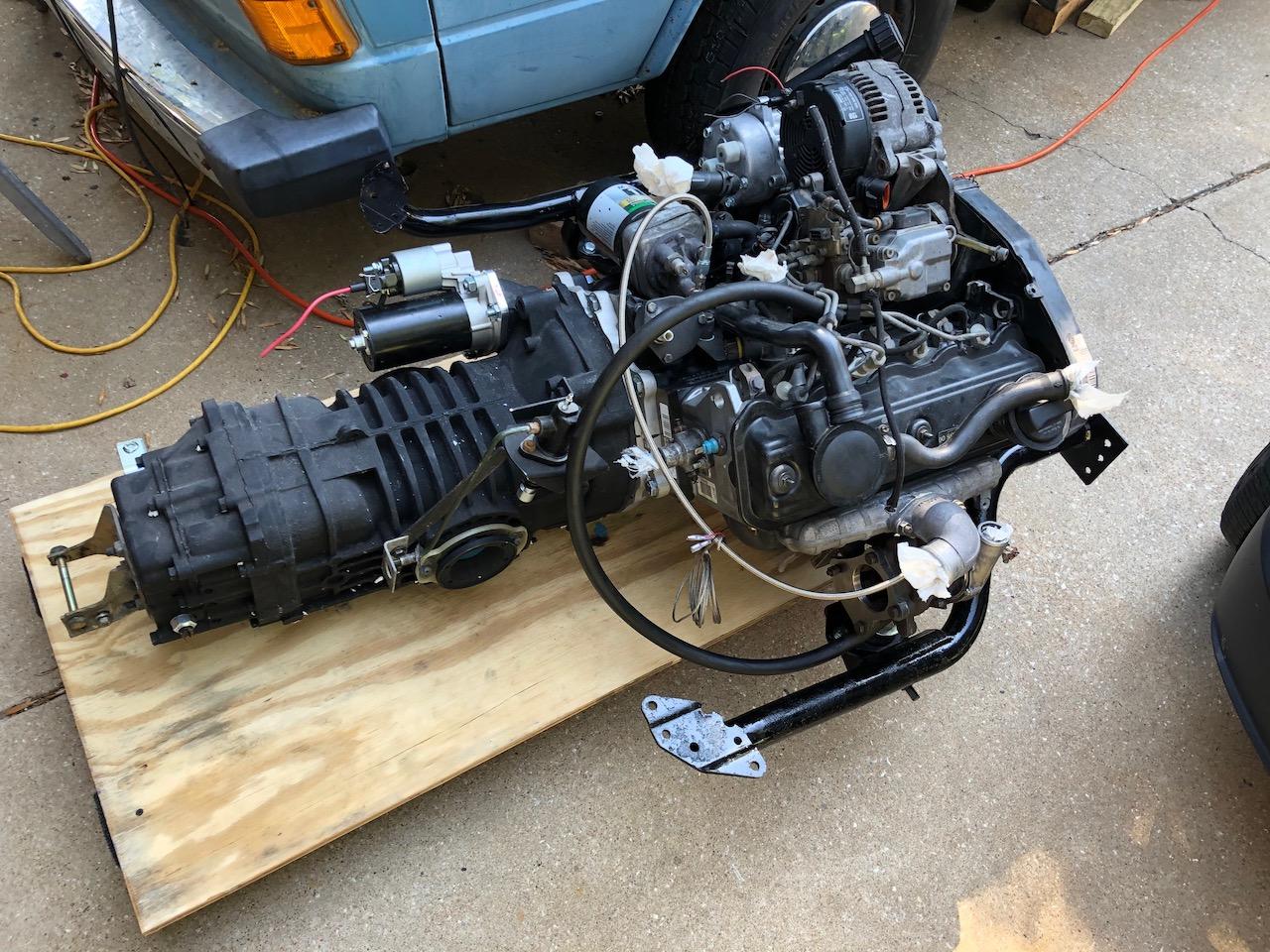

I have been working on this for over a year but retired in May so I now have time to get busy with it. Most of the year was spent fixing and upgrading the camper interior, which for some reason, I took no pictures of. Here are some pics of the engine and transmission before and after the install. The engine is a brand new, zero miles AHU engine and the transmission is a completely reworked Air-cooled version with a 4.57 final, a 1.18 third gear and a.75 fourth gear. Wright gear box did the transmission for me. I am using a Kennedy conversion plate with the air-cooled bell housing.

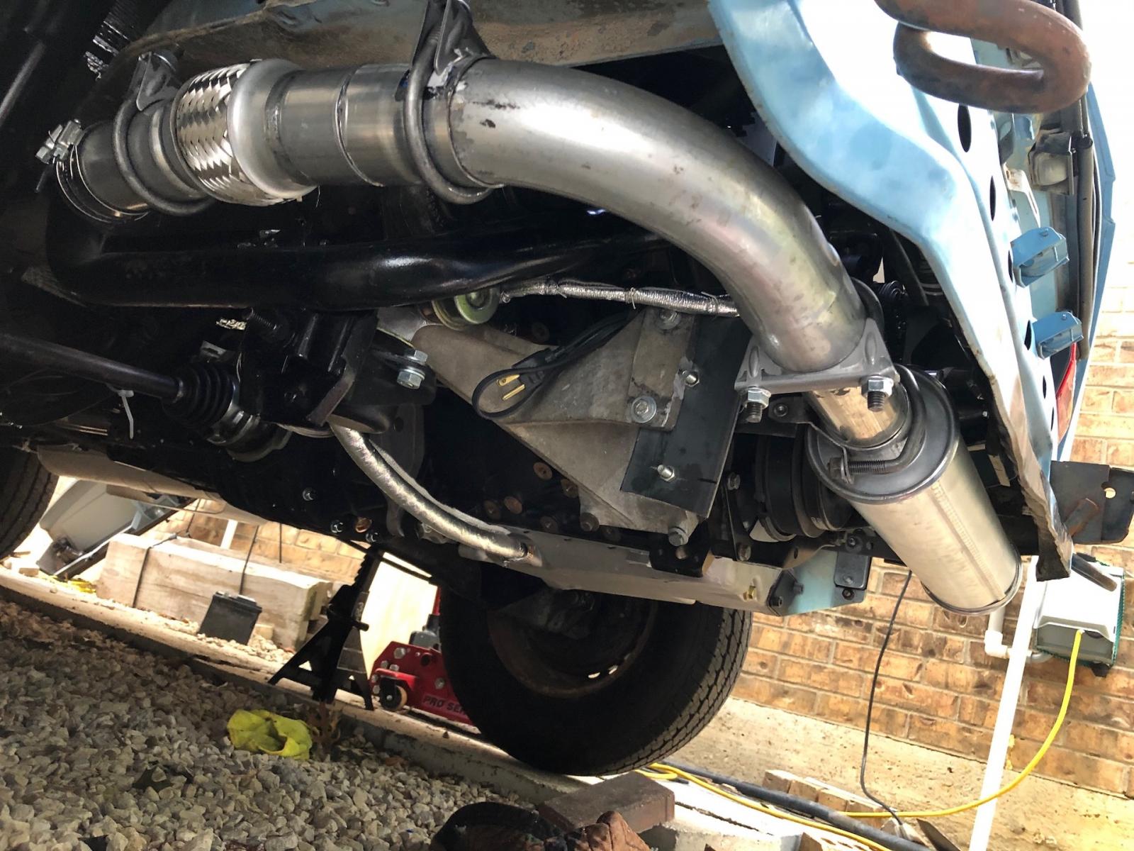

These pics are of the exhaust system I built. I need to refine the muffler hangers a bit. but everything is in its place.

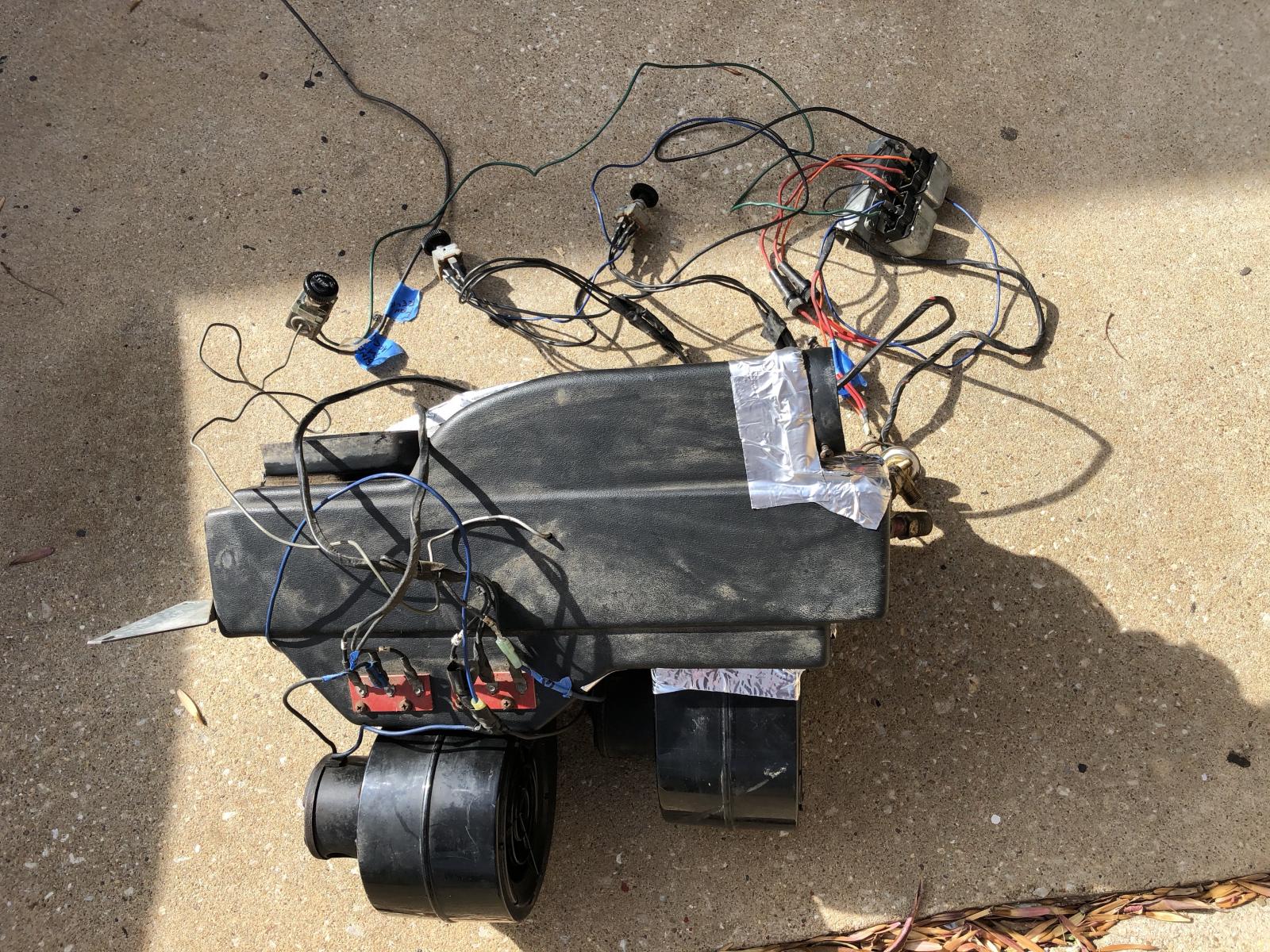

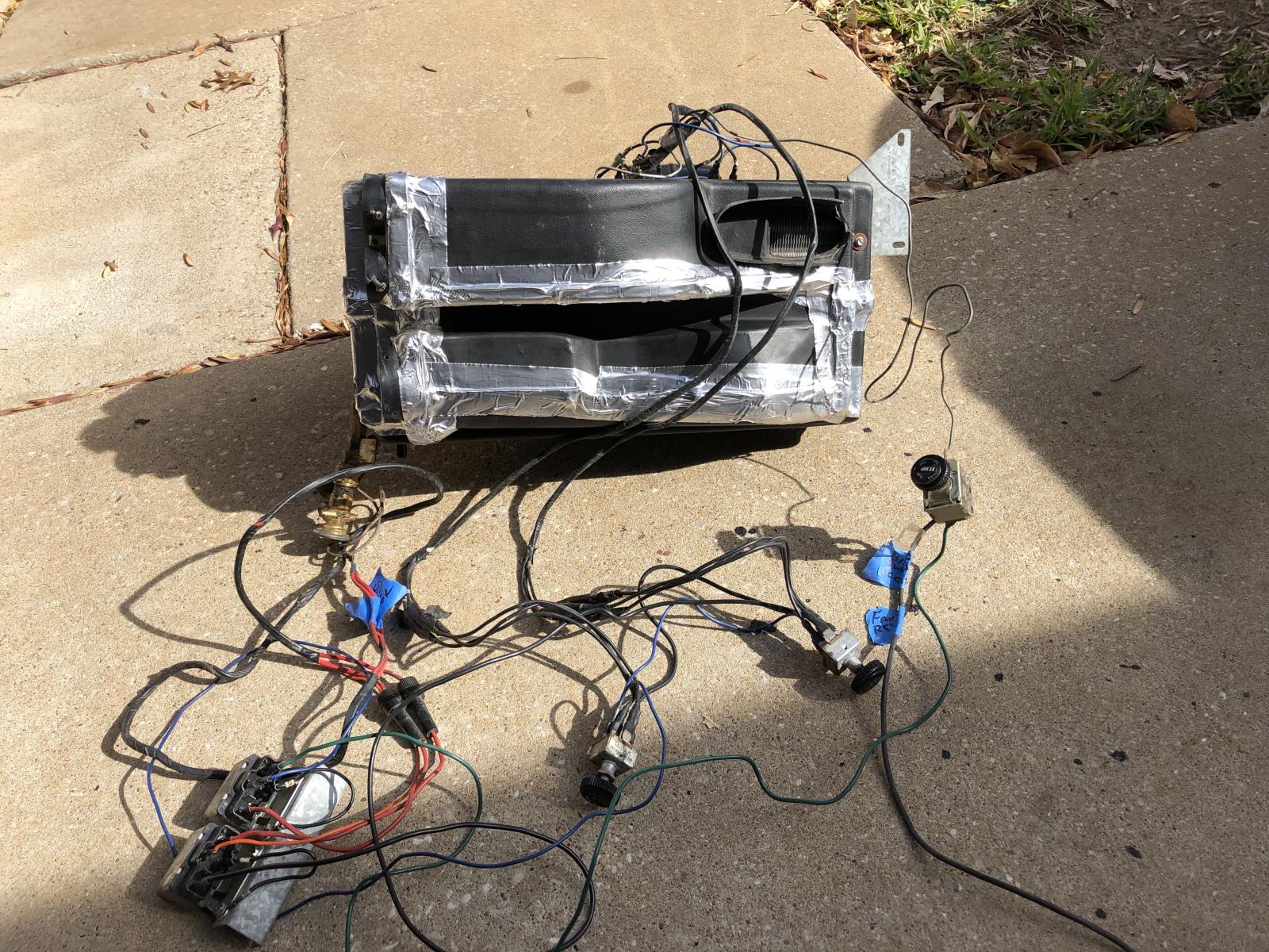

Next series of picture are pulling the air-cooled heater box and the brake assembly out to replace both. I first had to remove a bird's nest of added wiring for the old AC, an aftermarket stereo, a stereo power booster, speakers, aftermarket cruise control AND a jury rigged fan switch!

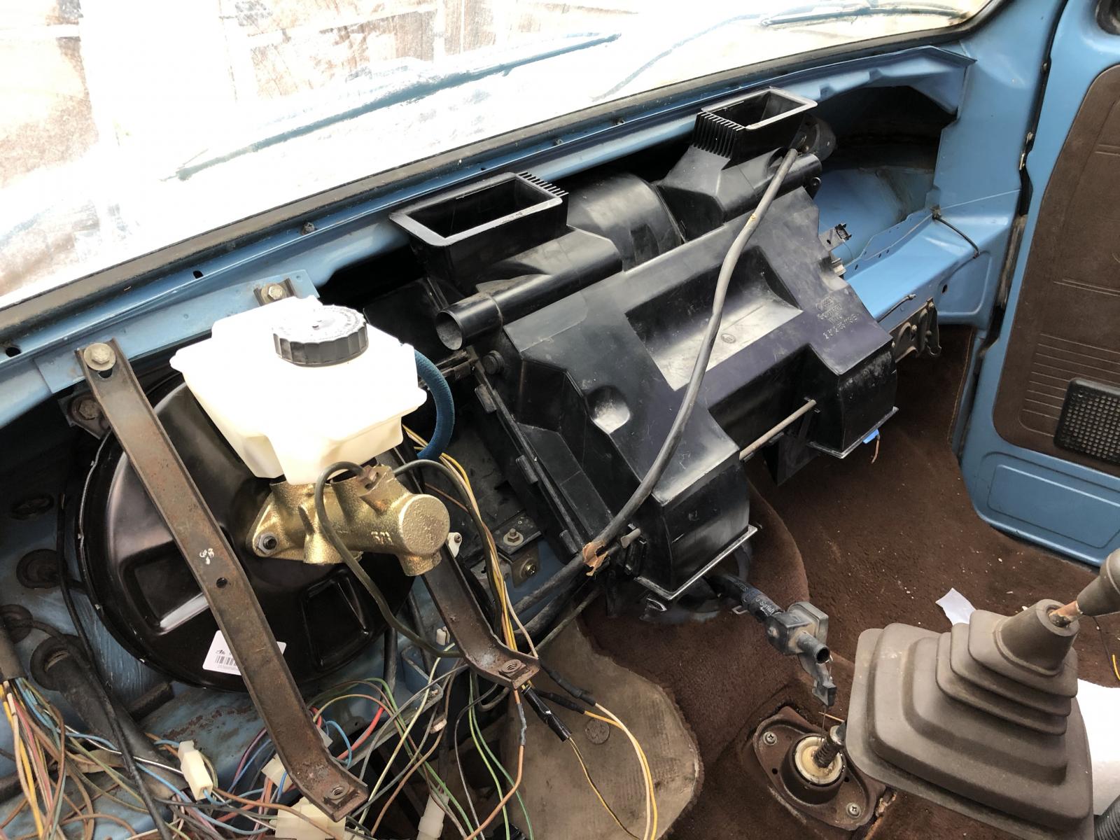

and this is everything back in its place, New brake booster, brake master cylinder, clutch master cylinder and a water-cooled heater box.

What engine mounts are those?

They came with a setup I bought from what was supposed to be a TICO (?) gas conversion. I didn’t see any part numbers.

They appear to be Mk2* Jetta trans mounts, with brackets produced by a gentleman in Oregon.
*I'm not entirely sure about that source, but I do know they're the same as found on a '93 Corrado VR6

I think they're also used in Mk3 VW's; the OP's mounts look like what I used on my ABA swap.
