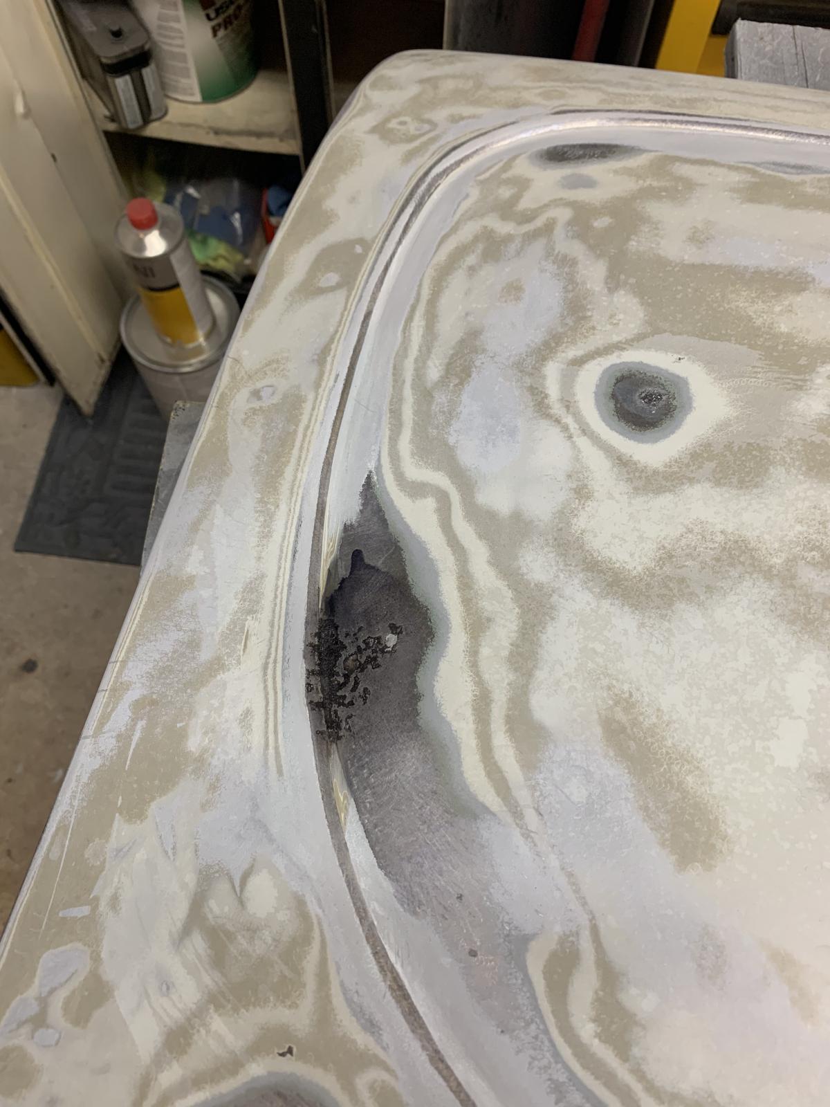

So I have done a bunch of research and just looking for the best solution for my rust issue. On the hood of my 66 I have some rust that just will not come out even with an aggressive wire wheel. I tried to use Ospho but than did more research and found out that was a mistake. The epoxy lifts and fails from using Ospho. So I took it all off. Rinsed with water and acetone and blew it dry. Cutting out the rust is not an option for me in this case. I know it’s always best to remove it I know. I’m just looking to slow it down as best I can. The metal is in good shape where the left over rust is. My question is would it be ok to just spray a light coat of rust converter and shoot Omni mp 170 epoxy over it? Or I was thinking of just using some sort of vinegar treatment. I just don’t want the epoxy to fail. Yes I know this is not the correct way to go about it. Just looking for something that will play nice with the epoxy. Omni reps only want you to use there products

Post some pictures of the rust.

Try vinegar. You just need to get down to the root of the rust and get it out. The duplicolor rust fix works sometimes, and sometimes it doesn't for me. I don't know why. I would like to see a photo so I know what I am giving advice on....
heres some pics

Use a hamburger Patty stripping wheel. Then wire wheel. Then reverse the drill with the wire wheel. Then coat with mastercoat or epoxy primer. Let dry for a day. Lightly scratch it up with 80 grit. Do not break through. If you do cut through apply more mastercoat or epoxy. Red scuff pad then fill pits with filler. Its really not that bad .

Are you taking it all down to bare metal, or just selectively sanding the bad spots? I am stripping mine down to bare. Previous owner actually did not do that bad of a job, but I had to replace some rust areas that he tried to cover up, and I am changing the color anyway. Its the only way to find the spots he tried to hide. Looks similar to yours.

for very minor rust like shown in those pictures I have cleaned it up and wire brushed with Ospho over night. then cleaned the area again, sanding and wiping with acrylaclean or similar product.. spray it with some ONE STEP and prime over it after that.
