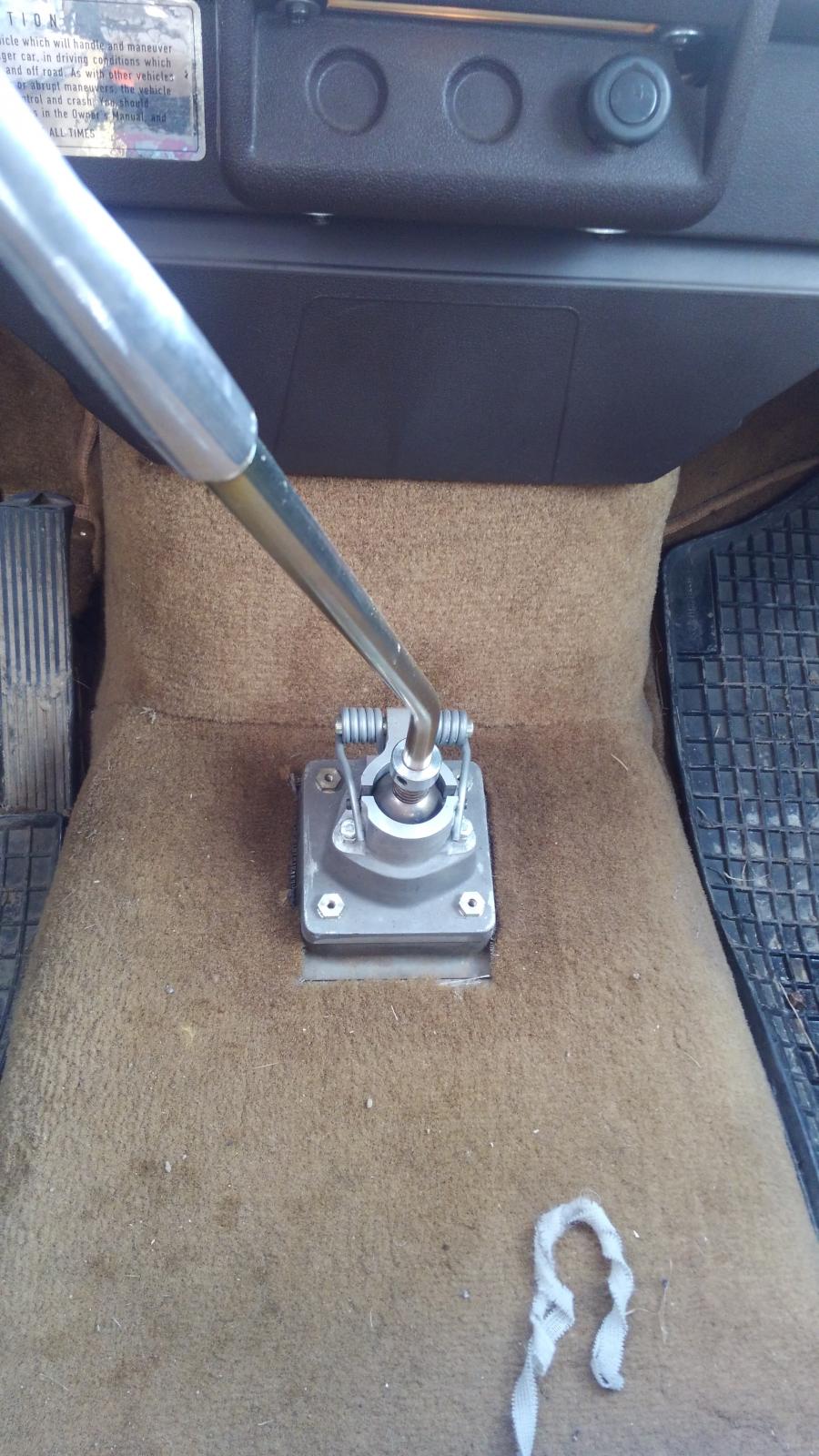

This looks interesting. I can't say that changing how my vanagon shifts is a top priority but it sounds fun. Also, compared to the pages of non-delivery comments regarding the other shifter this product may be better serviced by T3.
Edit: adding a link, http://t3technique.com/drivetrain-parts/479/
It’s not glittery, it’s not flashy or gaudy. It looks stock, but it shifts like a modern car. Not just a beefed-up copy of the original design, the 025 Motorsport 711 shifter revolutionizes and modernizes the shifting experience in a T3 (Vanagon/Syncro).
Biasing the shift lever in the center like a modern car (as opposed to being biased all the way to the right as is stock for the T3), the 711 shifter fundamentally changes the way a T3 shifts. In addition to center biasing, the throw of the lever is greatly reduced for less “rowing” and more driver comfort when shifting gears. Add the incredibly solid, precise feel of the shifter in your hand and it’s truly a completely new shifting experience.
Center-biased shift lever location (like a modern car)
Much shorter lever throw (roughly 44% shorter than stock)
All new custom cast, precision machined housing
Precision steel ball/pivot assembly
New solid shift lever
Available for the Syncro, 2wd 4-speed, and 2wd 5-speed gearboxes

I'm not sure what they mean by biased to the right / center / etc
Zeitgeist 13
Joined: March 05, 2009
Posts: 12161
Location: Port Manteau
Zeitgeist 13 is offline
PostPosted: Fri May 29, 2020 10:33 am    Post subject: Re: 025 Motorsport 711 Shifter Available at T3 technique... Reply with quote
Put your stock shifter into neutral and then lift your hand off and see what the shifter does. It doesn't stay in the center.

I've been running one for about a year now and it's fantastic. The stock boot doesn't fit over the base, but it's so cool looking that it doesn't really bother me. I might fit a trim ring so the carpet is more finished around it though.

It doesn't fit under the boot? Damn, sooo close to what i wanted.

uberaudi wrote:
I've been running one for about a year now and it's fantastic...
What do you like about it - the short throw?
Pictures please!
It’s true that the boot doesn’t fit perfectly over the 711 shifter, but if you just slide the boot down as far as possible, it’s not too bad. I’m working on a complete solution though.

It's great in so many ways...smooth and positive engagement, shorter throw, mechanical feel and look...what's not to love?
I should say that when I bought this van, the PO had put a carpet kit in it, so maybe the cutout around the shifter on stock carpet wouldn't have as much of a gap. Even then, a boot has no interest to me. I'm thinking a nice billet Lokar inspired carpet trim ring would look the part.
Btw, I've done nothing to it since I've installed it... this is certainly a quality piece of engineering that will outlast the van. A perfect compliment to a very mechanical vehicle.
