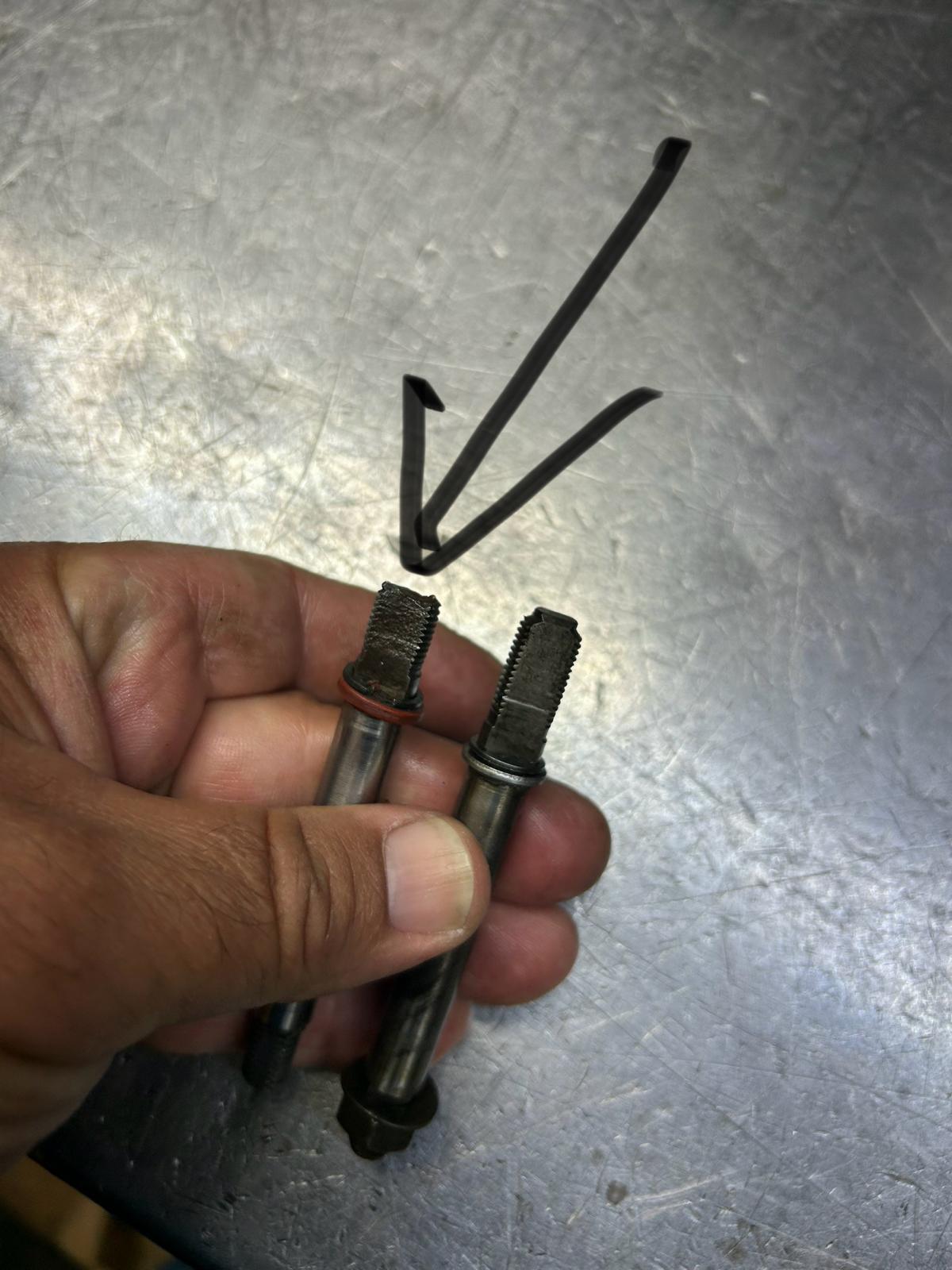

PostPosted: Fri Oct 24, 2025 1:07 pm    Post subject: Re: found a transmission shop in Los Angeles that fixed my Auto Reply with quote
Here are a few photos from the mechanic. I was told that the entire drivetrain is screwed and that is causing the transmission mount to whack and make noise. The engine to bell housing is also not mounted properly.He also sent some other pictures of leaks.

PostPosted: Fri Oct 24, 2025 11:32 pm    Post subject: Re: found a transmission shop in Los Angeles that fixed my Auto Reply with quote
Chootrain470 wrote:
Stud is too long bc your engine came from a manual transmission van. They didn' cut the stud or replace them, just got lazy when they found out upon assembly.
Your transmission mount is prolly mounted in the wrong set of holes on the chassis, there's 2 sets/loctions: one for manual, one for automatic. Easy fix.

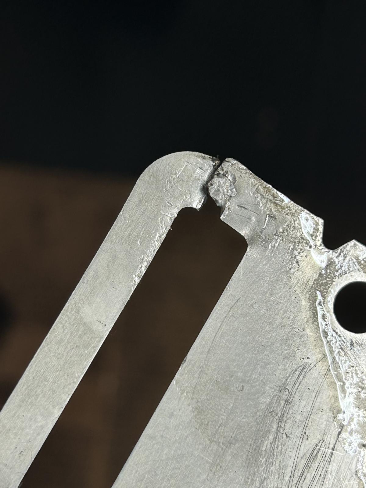

PostPosted: Fri Oct 31, 2025 1:41 am    Post subject: Re: found a transmission shop in Los Angeles that fixed my Auto Reply with quote
That evil washer!
I had the same thing happened to me on a customer's transmission I rebuilt.
I was pissed!
I brazed it back together and filed it down. Jewelry work...
I sell valve body separation plates in the classifieds.
If you need one, don't wait too long, I'm leaving next thursday in vacation Wink
https://www.thesamba.com/vw/classifieds/detail.php?id=2186917

ALIKA T3 wrote:
That evil washer!
I was pissed!
Thanks, my shop said they found all used or new quality parts already. I'm just excited to get the van back soon.
