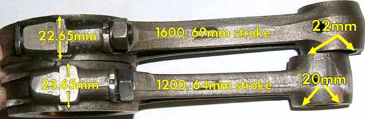

The connecting rod bearings are the same between 34bhp/1200 and 1300-1600, the base width, overall length and the piston pin bearing were the differences. The at-crank width difference is 1mm, so it should be extremely obvious if you have the wrong one.
Now, sometimes rods can bind up when tightening them, VW mentions this in the service manuals, this excerpt is from a 60s manual about the 34bhp engine:

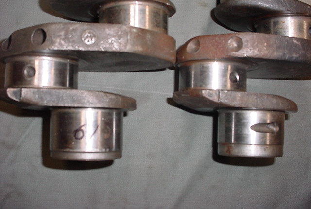

Now that I'm back home, I actually forgot to state in my reply my real worry. Identifying conrods are relatively easier following the 20mm vs 22mm for the 13/15/1600cc gudgeon pins. I'm not finding it easy to know if the crankshaft is the 64-stroke ones for the 1200cc. Is there any visual tell-tale for confirming which crankshaft it is? Maybe a part number or something?
The cheeks on the 1600 crank are thicker and less tapered. In the pic below, the 40hp/1200 crank is on the left and the 1600 crank on the right.
Rome

PostPosted: Sat Sep 19, 2020 10:49 am    Post subject: Re: Connecting Rods too tight on crankshaft. Reply with quote
Another clue, from hazetguy:
"On the left is a crankshaft that uses a stepped, 6V flywheel.
On the right is a crankshaft that uses an o-ring type 12V flywheel.
Notice the different depths that are machined on the ends of the crankshaft."
In this photo, the crank on the left is most likely a 1300cc one which was the 69 mm stroke but still had the 6 V flywheel. But this style of flywheel joint was also utilized on the 1200 40 hp (34 hp DIN) engines.

PostPosted: Sat Sep 19, 2020 12:37 pm    Post subject: Re: Connecting Rods too tight on crankshaft. Reply with quote
Quite helpful @Mukluk. Now I know I have the 64 stroke 1200cc. Many thanks @Rome as well.
