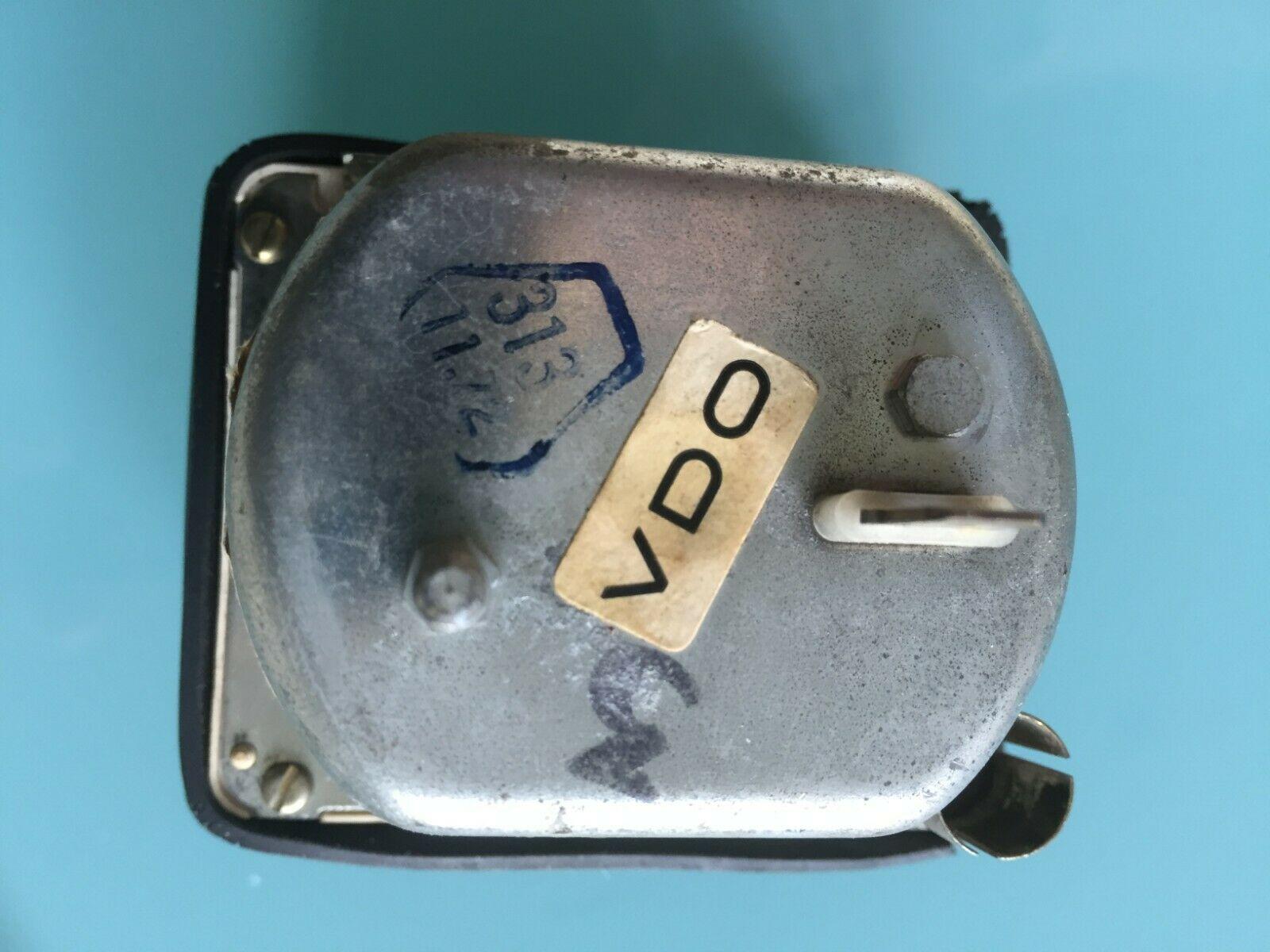

There are two styles of dash clocks for the 1973-1979 Super Beetles; one has a seconds hand and the other does not. I have read that 1973 is the only year to to have only an hour and minute hand and that the seconds hand was added in 1974. Can anyone verify this?
This clock dated 11.72 does not have the seconds hand.

Yep, 73 did not have the second hand, and 74+ included it.

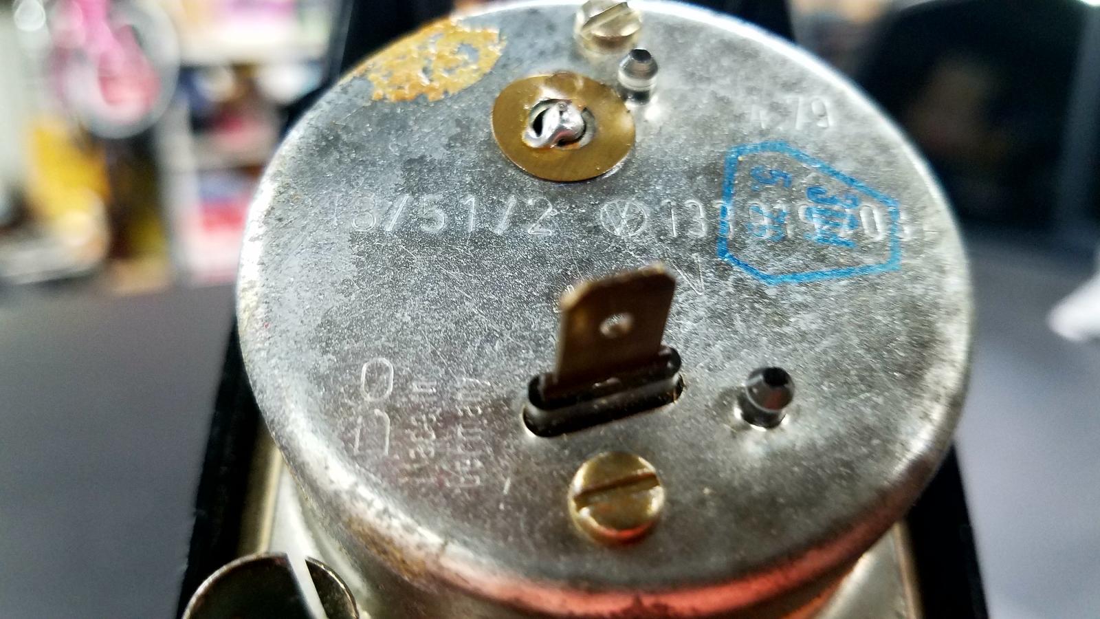

I like the idea of having one in my '74 Sun Bug and I found one last year and snatched it up quickly. I bought a spare Sun Bug rosewood dash panel that I plan on cutting the aperture for the clock and cutting round mounting screw covers of the cut piece.
My clock is dated 11.79.

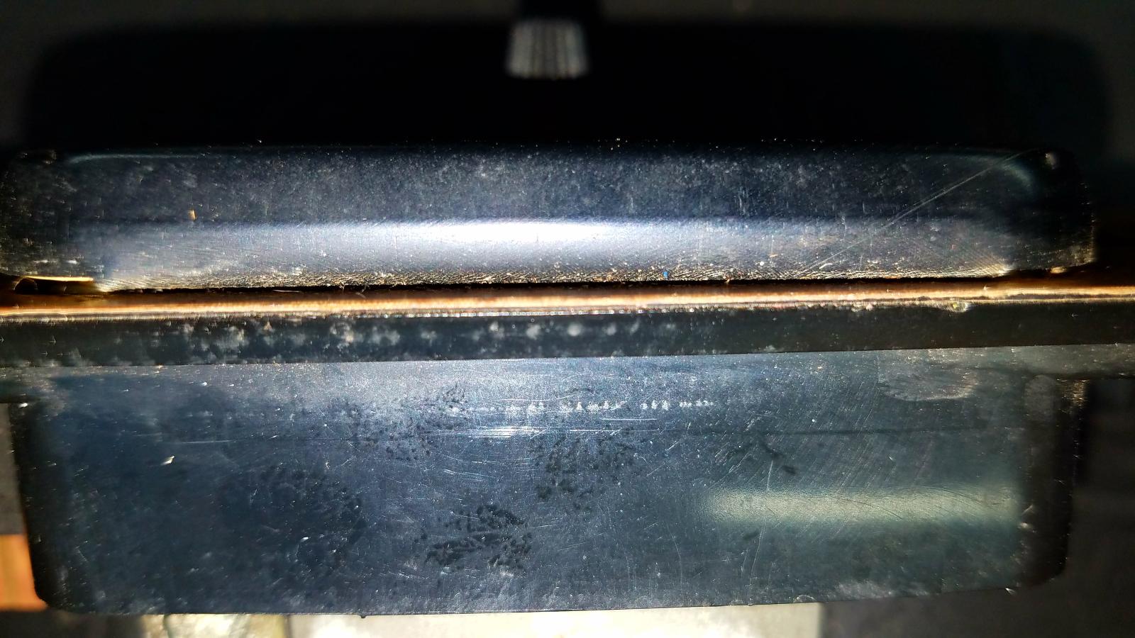

While on this clock topic; sometime back I bought a vdo clock and panel out of one of the luxury models and was looking at it over this past weekend. The panel faux wood is a diff pattern than our sunbugs so then I wondered how that clock comes apart from the panel? It looks to be in two halves but I didn't want to break it, thus my question here; anyone know how those clocks come apart or how to get them out of the panel?
The clock is 1 piece They're just compression held into the trim piece by the rubber gasket that's around them. It's just a matter of (very) carefully wiggling them out so you don't mess up the trim piece.
Yes, maybe the ones installed by the dealer as an add on option but NO, not in this case; see the pics... Wink
That's interesting. I've never seen that before. I wonder if a PO had an issue with the original gasket so they used the front bezel to hold it onto the trim. But I guess it could be a different model.
I don't understand what you're trying to show. The plastic surround on the backside of the trim is present on all of those trim pieces whether they have the clock or not. And then there is a roughly half inch ribbed compression gasket that holds the clock in place.
What you took pictures of is how they all look.

Here is a pic where you can see part of the push-on gasket.
Well I went out to my shop and gave it a good push, Viola!
