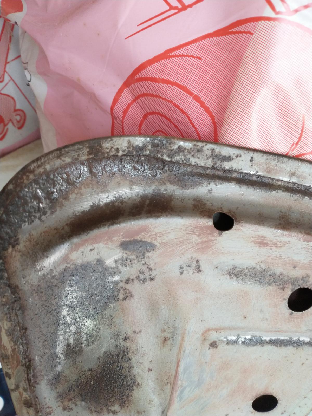

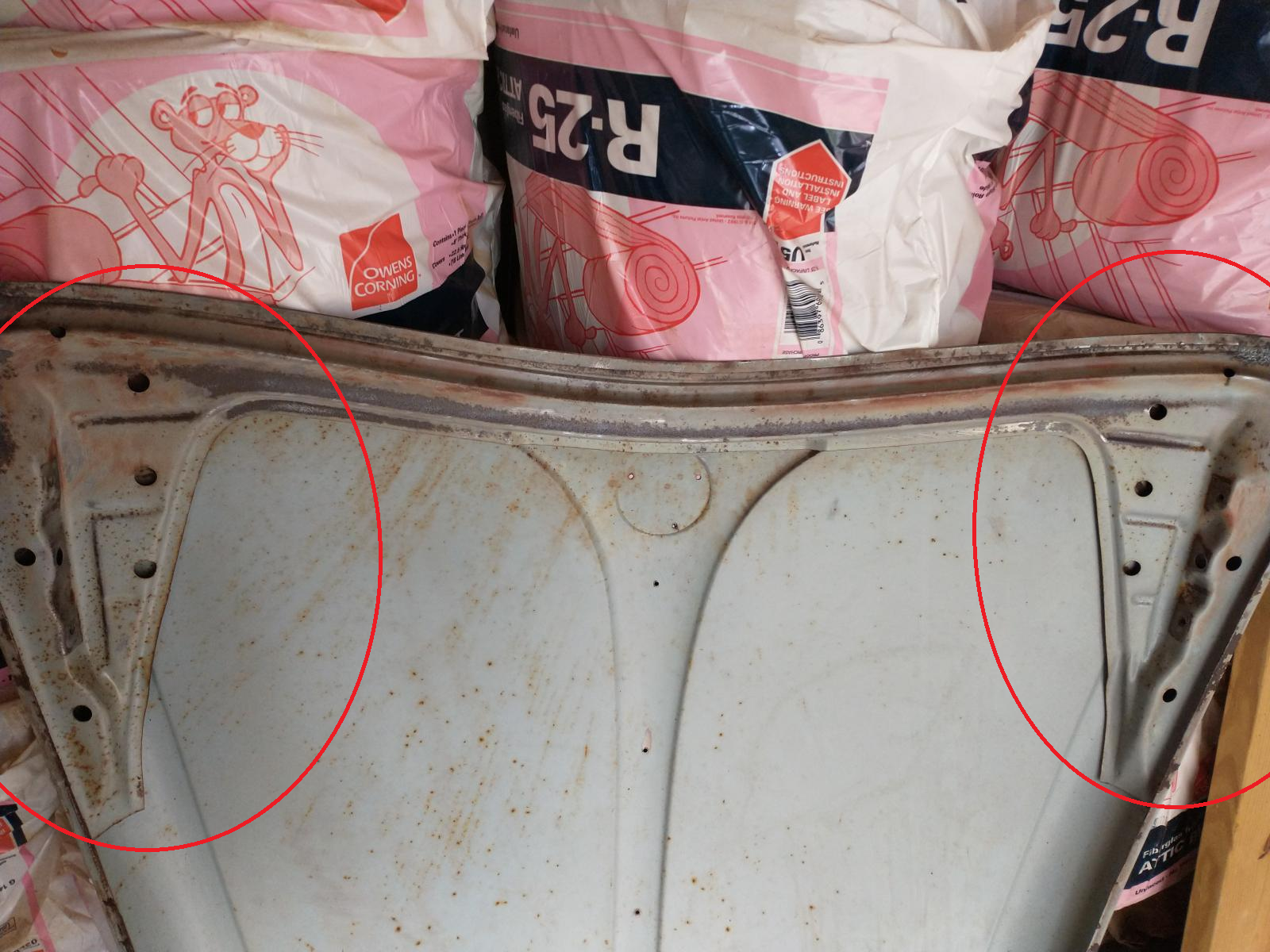

I am wondering what the best method of approach would be on the under hood rust pitting and other surface rust. I am in the middle of sanding and stripping many layers of paint. Should I remove all the rust, treat it with a rust killer spray and then put body filler in the pitting? I dont have a welder so that makes things a little difficult.
It doesn't look to bad to me, but not sure what the best approach would be.

Brush multi coats of satin silver & gloss black www.masterseriesct.com on it.
It will look good & be protected.

Or blast and follow with epoxy primer, put on extra thick in the corners and use a little filler before you paint and it will disappear... and shouldn't come back during our lifetime.
Just another slightly more involved option. That's how I would do if I were repainting the whole hood or more.

That’s the best solution. If you don’t have a blaster you can use naval jelly to chemically remove the rust in the pits. You don’t want to leave that black oxidization that’s still rust and any exposure to moisture will activate it.

Thanks guys, how many coats of epoxy primer do you put over metal and filler before you paint a base coat?

Don't put filler in the pits. These are under the hood, nobody will ever see this. Media blasting is going to remove more than you think, looks like there is some flaky rust that will blow out. Key is to remove as much of the rust as you can. If you can't get down to clean metal, neutralize whatever rust is left, and then coat over it so moisture can't get in there and restart the rust process.

After getting rid of the rust. Epoxy - seam sealer - Paint.

How do I get the rust out of these raised areas? Under them, inside the holes there is rust.
Chickensoup
Joined: January 06, 2018
Posts: 5395
Location: Good Hope, GA
Chickensoup is offline
PostPosted: Thu Jul 29, 2021 3:42 pm    Post subject: Re: How to approach under hood pitting and other rust Reply with quote
Ive never tried the above, but for some ideas...
Use a flexible wire brush inside the holes. Blow the particles out with compressed air. Soak with ospho. Then primer of your choice.
And as an optional step, fill it with liquid rubber or something that isn't hydroscopic.

Ok I am currently soaking under the raised areas with a paper towel soaked in evaporust. Im hoping it does a decen't job killing the rust. Its really hard to get in those areas to sand. I wonder if this is a common rust area? Im fairly certain its just surface rust. Im just worried after all this prep and time spent sanding the car down to bare metal that some unreachable areas are gonna ruin the paint job.
Braukuche
Joined: September 03, 2004
Posts: 11226
Braukuche is offline
PostPosted: Fri Jul 30, 2021 7:49 am    Post subject: Re: How to approach under hood pitting and other rust Reply with quote
1) Drill out the spot welds and remove the bracing, clean out the rust, weld it back in.
2jBuy Navy jelly and soak the hell out of it repeatedly until it’s all gone.

This may or may not work re sealing. I've done it on other non-accessible parts but am not sure about YOUR specific hood.
Get some plasticine or linseed oil based window putty or maybe Play-Doh. Seal all the outer edges of the double sections. Or do what you need to if you hold the hood at an angle to the horizontal.
Fill with Ospho or rust converter. Let it do its magic. Slosh around to make sure it gets into all locations.
Drain out any excess liquid from one or two spots by removing sealer and leave to dry. (Or if a proprietary rust converter follow the instructions - some say dry some say leave wet or needs to be washed. If using water then use hair dryer/hot air gun to dry water off).
Reseal the edges previously removed.
Flood area with your choice of anti-rust paint. Slosh around to make sure it gets into all locations. Leave to dry.
Remove the sealing and clean area with acetone/lacquer thinner etc to make sure all oiliness from the plasticine/putty/Play-Doh is gone.
Even if you cannot get a perfect seal, the idea is to get the rust converter and paint into areas that you cannot reach. If a little leaks here or there it is no big deal. If you intend to keep the original paint though, make sure you wipe it off the paint surface immediately and not let it dry.
