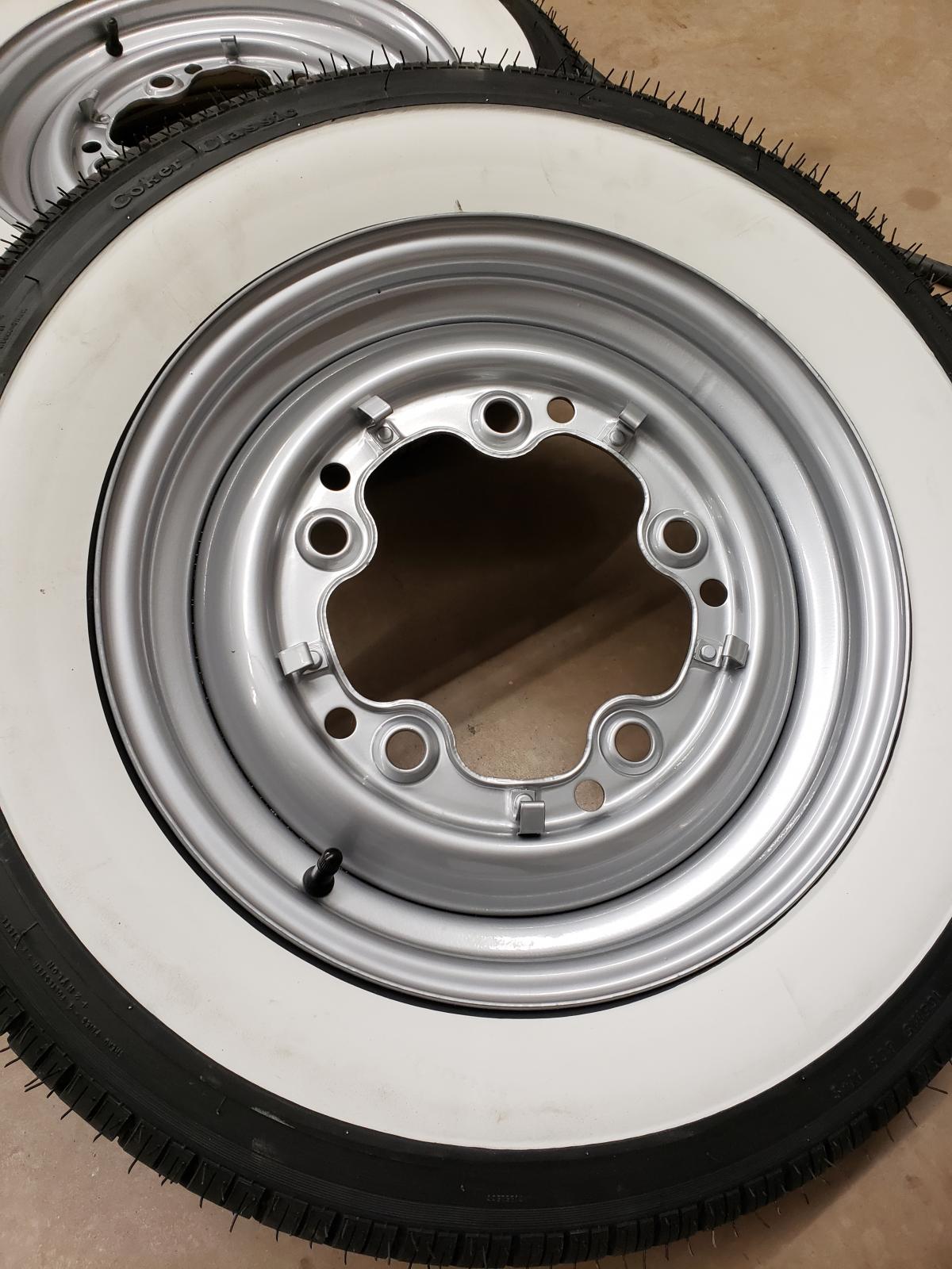

I just posted this in the CUSTOM tire/wheel forum before realizing it said CUSTOM.. this is more a factory size so I am copy and pasting my original post here below.
So first off, this is my very first post on the Samba but I've been lurking here for a few months. I don't post on any of the forums I read because usually a search is sufficient, but this topic is a little more specific and I also wanted to see if any of you have had a similar experience.
I bought our first VW a few months back as a birthday gift to my wife. It is a project but a running and driving car. It had sat for a very long time so the tires were shot. So, during a VW show in OK a few months ago she picked out what set and size she wanted. She REALLY liked a set of Coker Classic 165r15 2.25" whitewalls. I ended up getting them and surprised her with them as a Christmas gift.
So today I get them mounted... they look awful.. the whitewalls are off center from the tire and show black around the rim bead but not consistently.. its some over here, alot over there, none other there, just looks bad. The outside of the whitewall isn't consistent either and looks really bad as well... needless to say I am very disappointed. Not just because of the price tag on these things, but especially since it is for my wife.
I bought them through Summit (part number 568745) and they were really nice about it on the phone and we are set up to get them shipped back and refunded ( except the mount and balance fee I just paid). I have photos of the tires we liked at the VW show and they didn't have this issue but they were pretty old. This has to be an issue of the company of today and not of yesteryear. No way they would still be in business and keep a reputation selling tires like this.
So.. what says The Samba? What are my options other then Coker? I would like to stay with a 165r15 2.25" whitewall because we really like the look. They just look right on a '63 ragtop.

Photos don't show its severity as well as in person. When I got to the tire shop I saw the issue from across the parking lot.

wow, those are terrible. you can look into diamond back, but they are pricy.
